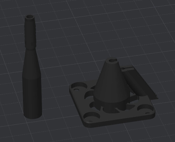

Thanks for the info, I am currently in the process of setting up Air-assist I’ve worked up an adaptor for the tubing and modified a nozzle model to connect it all up to see if I can improve cutting depth. I have ton of fire and forget Patience, I can ignore a printer or cutter for days. :slightly_smiling_face:
For cutting, you will find this has amazing benefits: Reduced cutting time and cleaner laser lens.

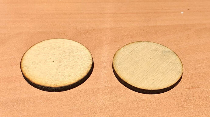

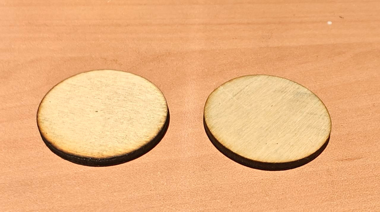

So far I’ve cut 3.175mm (1/8th) inch Baltic Birch in 4 passes no air at 95% and 80mm/m. Just a small fan and a dryer hose to put the smoke out side. Nice clean cut with very little scorching.
I do not have a 5w, so I reduced my power to 47.5% (but a 5w has a more focused beam, so it will actually cut better). I actually cut to make sure my machine would actually cut out completely with my settings. No air assist.
You did not specify the circle size, so I used your settings on a 12.534mm circle.
5w, 4 passes, 95%, 80mm/m = 1:58 minutes.
10w, 4 passes, 47.5% (of 10w = 95% of 5w) , 450mm/m = 0:27 minutes. It actually dropped in 3 passes.

My circle was 34.06mm, I just made a random circle and ran it.

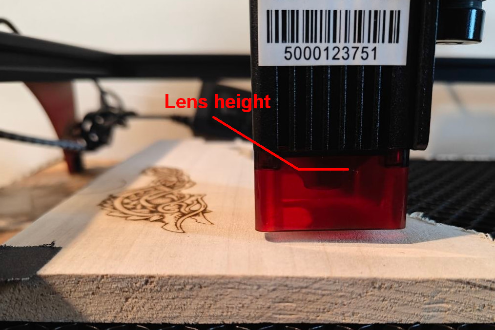

I have not been able to find any numbers on optimal Focus height for the Kentoktool LE400 Pro so I set it with the cover about a 1/8th" gap above the piece the actual Lens is about 3/4 - 1" above the piece, all their videos show it at approximately this height.
I am not sure how to perform a ramp test because my Z axis is manual.
Their literature says,
The Kentoktool LE400 Pro features a fixed-focus laser module, meaning it does not require manual Z-axis adjustment for focal length. Instead of traditional zoom adjustments, the machine uses a lifting control knob to adjust the overall height of the laser head, which facilitates convenient and accurate positioning relative to the material surface.
  • No Manual Focus: The laser has a fixed focal value, eliminating the need for constant manual focus adjustments typical of zoom lasers.
  • Height Adjustment: Users can utilize the lifting control knob to raise or lower the laser module for proper working distance.
  • Stability: This design ensures stable laser power and consistent engraving results without the hassle of recalibrating focus for each job.

It literally has a knob on top that you turn by hand to adjust the height.
It doesn’t say you move the Z axis to focus.
It says, [quote=utilize the lifting control knob to raise or lower the laser module for proper working distance. [/quote]
Meaning setting it to the correct height for the thickness of the material. For instance th wood in the picture is 13mm thick the disks I posted are 3.175mm thick. so I had to lift the laser head to accommodate the thicker wood.
I get they edited for better shots and I understand advertising but I plan on testing to see if I can achieve that cut or better. I’ve never been one to give up just because someone said it’s imposible.
Moving the module up and down is moving it in the Z Axis. Manually.
