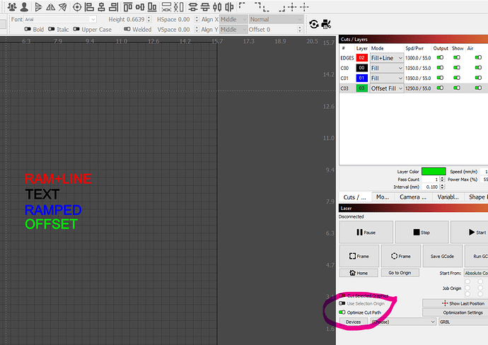

I am encountering a problem with order of cuts and can’t see where my error lies. In this file I want to cut the green cutouts BEFORE the red edges but the file defaults to cutting the red and then dropping it into the bed so that the green cutouts don’t ever reach. I tried overcoming the problem by putting 2 tabs on each red object but they get ignored. Similarly the red rectangles gets cut before the blue “swirls”. I have the layer orders set correctly.
Thanks for the suggestion bebrainlb, I wasn’t aware of an Order section so checked the online docs and see that it is in Optimization settings and I hadn’t ticked Optimise Cut Path so that might have been the issue. I’ll go back and try that.
Thanks James; the error was mine as I didn’t have Optimize Cut Path (Order by Layer) selected. I ignore the numbers sequence on the layers palette as some of the colours are too pale for me to easily see, particularly if I have Output turned off. I often use a dozen or more layers so go for the brightest ones instead. The palette probably wasn’t designed to work this way but it suits my reduced vision.
The numbers would only work if I could allocate a colour to a number.
Thanks for the clarification JimNM, your suggestion works as long as Order by Layer is at the top of the Optimize menu. I have always had that set and totally overlooked it so that it no longer worked when Optimize somehow became unselected. I appreciate your help.
