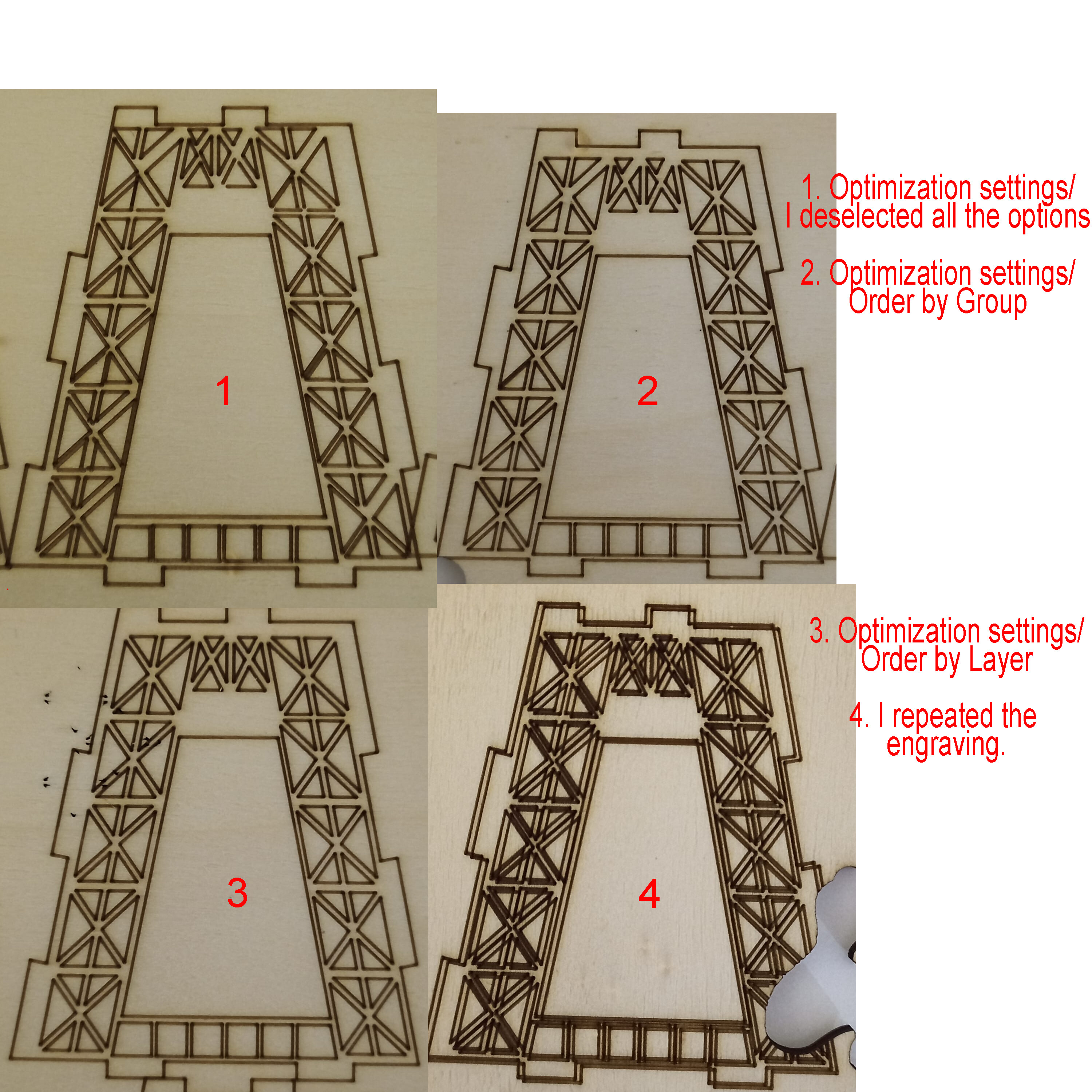

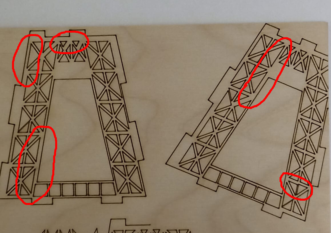

Hello, I have a CNC 4060 80W Ruida 6445G Made in China. I have a big problem when I try to cut a drawing with several elements. Some elements of the drawing are cut elsewhere. All these cut pieces were destroyed. If the drawing consists only of outline, it is cut well, if it has interior designs they are cut incorrectly. I have the impression that after erroneous cutting, the cutting position recovers, but the piece is already destroyed. I tried with a cutting speed less than 10mm/s, but the problem is repeated. The same problem was repeated in another drawing with cut and engraving inside, some engraved elements were made elsewhere. On the display controller, the cropped image looks normal, without errors. I remember that I did not have this problem with the machine from the beginning, I have only owned it for 2 months. I admit that I made small changes to the settings. Please help me with tips. If there is another discussion on the same topic, please let me know. I am attaching some pictures to understand my problem, which is quite serious. I hope it’s not something serious. Thank you in advance.

Thanks Hank, I also thought about this option and changed these values, but nothing concrete. I will try to lower these values ​​again. I have done many tests and it is curious that these erroneous cuts are repeated every time in the same places, with different speed settings (this means that the steps of the engines are not lost). I tried to change the order of the inner cuts, the result was that the errors changed elsewhere. I got good results with normal speed and acceleration (unchanged) when I opted for ‘Optimization Settings / Hide Backlash’. In this case the inner cuts are made randomly and not in order, there is a disadvantage, the cutting time is longer because there are larger displacements between cuts. So in this case I got good results, but I’m not satisfied, I don’t understand exactly what the cause is. I will try again to reduce the acceleration. I mention that this drawing is small in size and those cutouts are very small, but I don’t think that’s the cause. I’ll keep you posted on the results. I’m still waiting for advice.

I did a few more tests, but I couldn’t find the cause. I noticed that if I twist the image a few degrees, the error moves to other elements. Usually towards the end, after losing the position (about 0.5-0.8mm) follows the erroneous cutting or engraving on the following elements. I also changed the settings, I reduced the acceleration, the problem remains. I don’t think it’s a mechanical problem, belt, motors, etc. because this error is repeated exactly at the same elements in the image. I mention that the simple geometric figures (circle, square) are cut perfectly. If anyone wants to do a test with this drawing, I would be curious about the result. What else can I do?

You are absolutely right, he loses his position and every time in the same place at the same drawing. I also made a short video where he loses his position, after this moment all the cuts are deflected to the left. I’m not good at settings and Ruida, I post pictures with them and you tell me what to do.
I couldn’t upload the video, but it can be seen in the first image where it loses its position.

I mention that today I tried from another laptop and the exact same problem is repeated, at one point it loses its position and moves more to the left, from that point all the cuts or engravings are moved to the left by about 1mm.
As can be seen in the images and the outline is shifted to the left, it is the last execution in the drawing.
I came with bad news. I did exactly as you said, no change. Then I deleted Device from the list then added again with Packet / USB and Serial / USB. I tried all the options. The photo shows error changes when I change the settings in Optimization Settings because the burn order changes. I’m sending the two files you requested. I hope to solve this problem because it is already stressing me out.
Neither in Figure 3 is not all perfect. The inner border is moved to the right and the outer border to the left.
