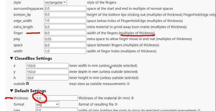

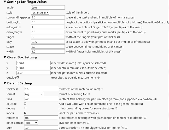

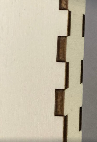

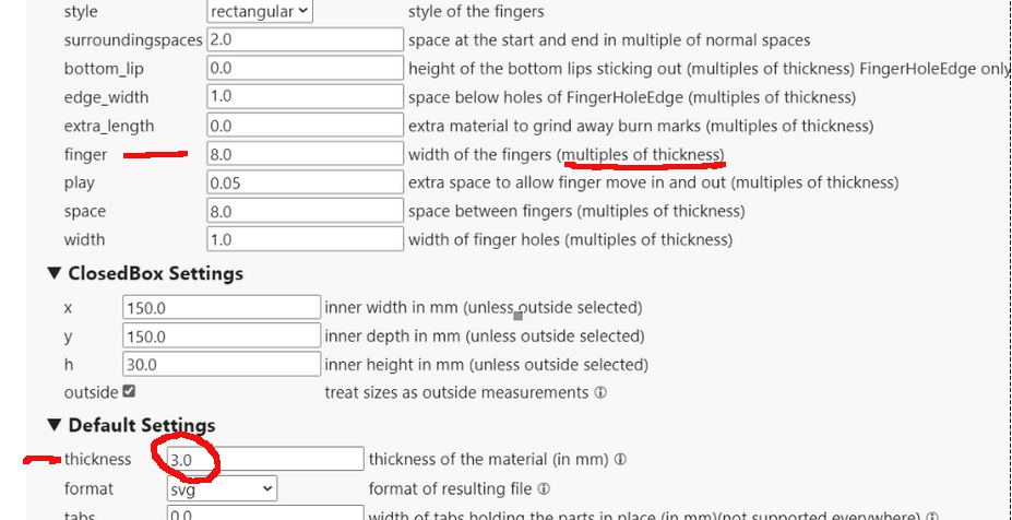

I have a little problem with the boxes. I need to make a good box to have perfect fingers that fit together. But I can’t get it right. Attached is a picture of the boxes.py setup and also the product where you can see the gaps between the fingers. I am also attaching the generated *.svg file. I don’t know what to do anymore, I paid out a lot of material but the result is still the same. There is a gap. Would anyone know what to do about it?

It could indicate that you have kerf setting enabled with a false value.
When I use boxes.py, I disable the kerf setting there and use the kerf settings in LightBurn. 0.07 fits my CO2 laser just fine for a tight fit.
for the rest, have you checked that your material is 3.0mm? Plywood likes to “cheat” with the measurements.
I do the same as @bernd.dk with the kerf.
Sometimes the devils in the details…

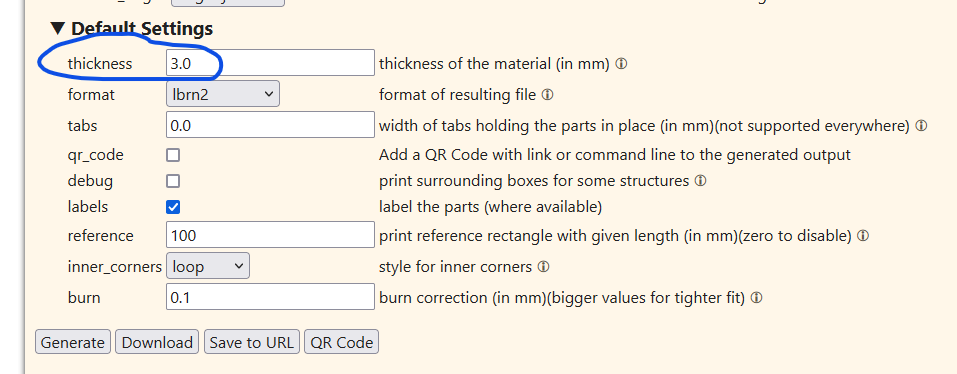

The thickness is set to 3mm. You have the finger set for 8, which is specified as a multiple of the width?
This could make you off 1mm or 2mm depending on the software interpretation.
I’d generate it again and use values that are within the specifications of the software… I only looked at this one… double check the rest of the entries.

In addition to the above (all of which I heartily agree with), it looks like you have a value of 0.05 entered for the ‘play’ field, which adds a gap like you describe. I would also make that value 0.

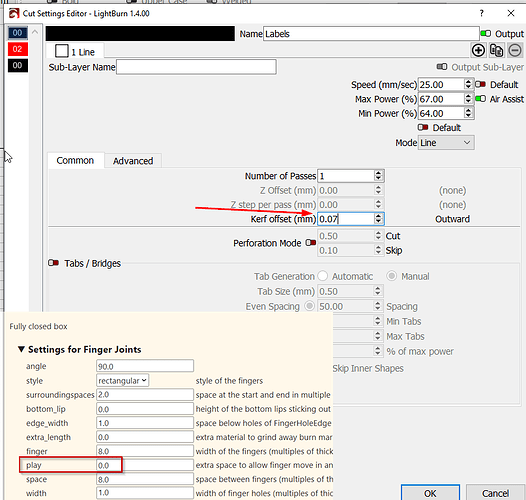

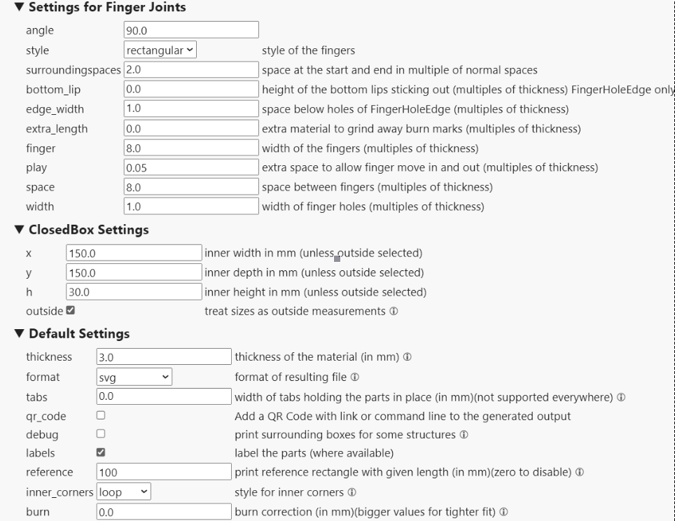

Thank you for your advice. So I will try to change the generator settings, play values to 0.00 and instead set it in Lightburn see picture.

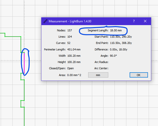

I think the problem might be the multiple width of the plywood. What can be done about it?
I would guess that the software has to deal with the relationship of the thickness being 3mm and the required value of the tab width being a multiple of 3. Not 8mm as a value. It should be 3, 6 or 9 for example. If the software resolves it to 6mm then it will be 2mm off the 8mm tab setting… if it resolves to 9, it will be 1mm off the tab size…
The truth is I don’t know what it does. It could do any number of things…

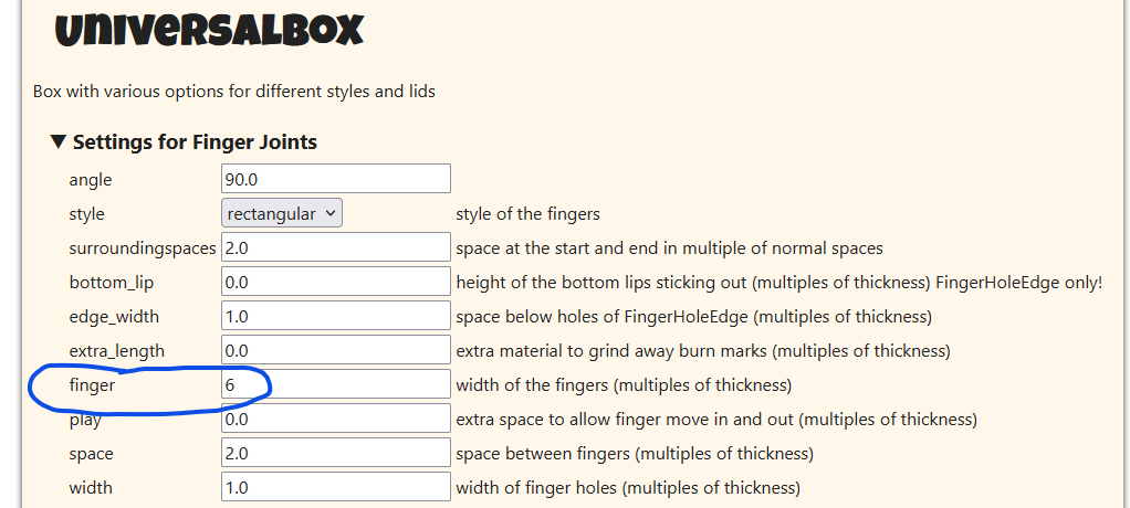

The figure entered here is multiplied by the thickness to give the required length rather than it being a target mm size. e.g. if the thickness is 3mm and you enter 2 into this entry box then the result will be 6mm (2x3mm), if you enter 6 then you’ll get 18mm…
If you know how it works then I’ll refer to you… I’ve use it as I’ve described and have had no issues…
Based on what you say, I’d expect the tab to be 8 * 3 or 24mm… ?

I’d always assumed it was this way but I thought I’d better check before posting the above and it definitely works that way for me.
I’ll try running some tests with a slightly different finger size. I’ll do the same with the spaces. I also measured the plywood and it’s exactly 3.3 mm. As you wrote, that alone would make a deviation, so I’m making it as accurate as possible. I leave the kerf to the Lightburn program. Thank you.

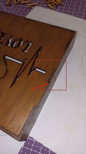

It doesn’t appear to be any wrong settings, two fingers are correct one finger is short.
I sometimes get “features” from Lightburn, but correct errors by hand and live with the slight imperfections.
If you cut that faulty box side again, does it repeat the error ? or is it a random error ?

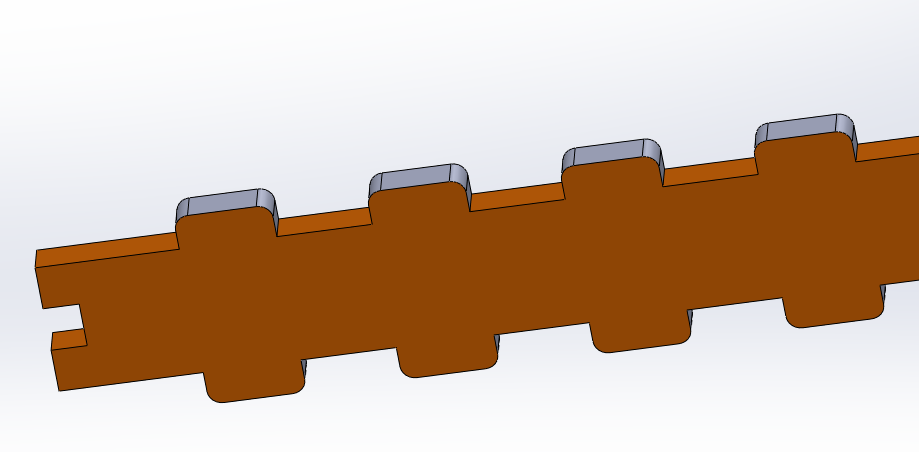

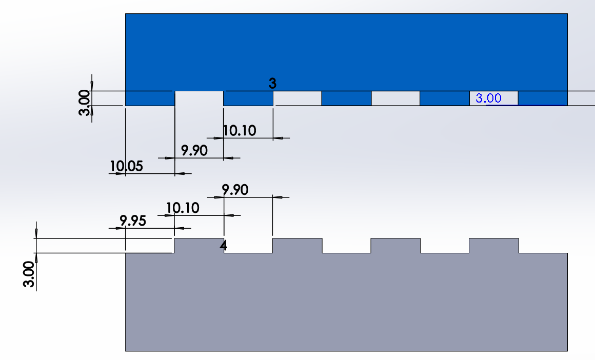

Ater getting frustrated with the finger feature I have tried to tackle the problem mathematically. I found it more convenient to go back to the original design in solidworks and fine tune it there. Then I converted the solids files to dxf and exported to lightburn, assigning 0 cutting settings for kerfs etc.
In order to determine the correct dimensions to each part, one should distinguish between the middle joints and the edge joints which seldom are the same.
Suppose you have a total length piece of 90 mm and the material thickness is 3mm. Let’s say that in order to achieve a tight fit you need a 0.2 mm difference between the male and the female and that you want the male finger to be 10.1 mm and the female 9.9 mm.
You’ll end having "middle joints and “edge joints”; substracting the total length of all the middle joints from the total length of the piece you will be able to calculate the size of the edges.
Piece 1 (in grey color): in this case we have female joints at the edges: you have 4 male fingers and 3 females in the middle, total: 70.1 mm. Substract from the total length: 90-70.1 = 19.9 . Divide 19.9 by 2 and you’ll get 9.95 which is the length of each of the two edge joints.
Piece 2 (in blue color): do the opposite: you’ll have a male finger at the edges now. You could calculate all dimesions like before, but it would be easier to calculate any given dimension substracting from 20. For example if the edge female joint in one piece is 9.95 the corresponding male one on the other piece will be 20-9.95=10.05 etc.
I usually like to add a 1.5mm fillet to the edges of the male fingers, which - without compromising the tightness of the fit - makes assembling easier and prevents chipping the adjacent piece in the way. Especially If you work with plywood.

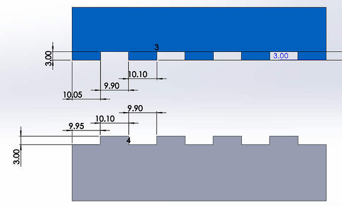

And this is a detail out of an actual piece of one of my projects which I did with 4 mm poplar plywood.
Hope this helps
