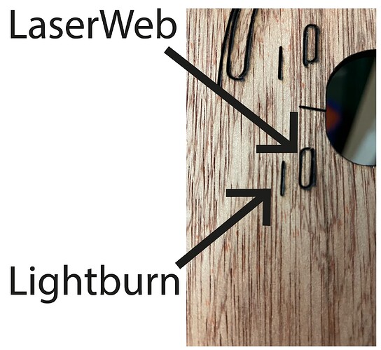

I downloaded the trial version of LightBurn and I want to use it to cut G-Code generated from Fusion 360. My problem is that the shapes that are cut by LightBurn are wrong.
I tried the same G-Code using LaserWeb and it cuts perfectly.
Here is an example:

The simulation of LighBurn also shows the problem:
Is there any setting to solve this please?

Lightburn doesn’t support circular interpolation in Gcode. (G2,G3, I and J codes)

The GRBL controller does support circular interpolation, and LaserWeb likely is only a pass-thru software package. Same as LB’s Run Gcode button.
