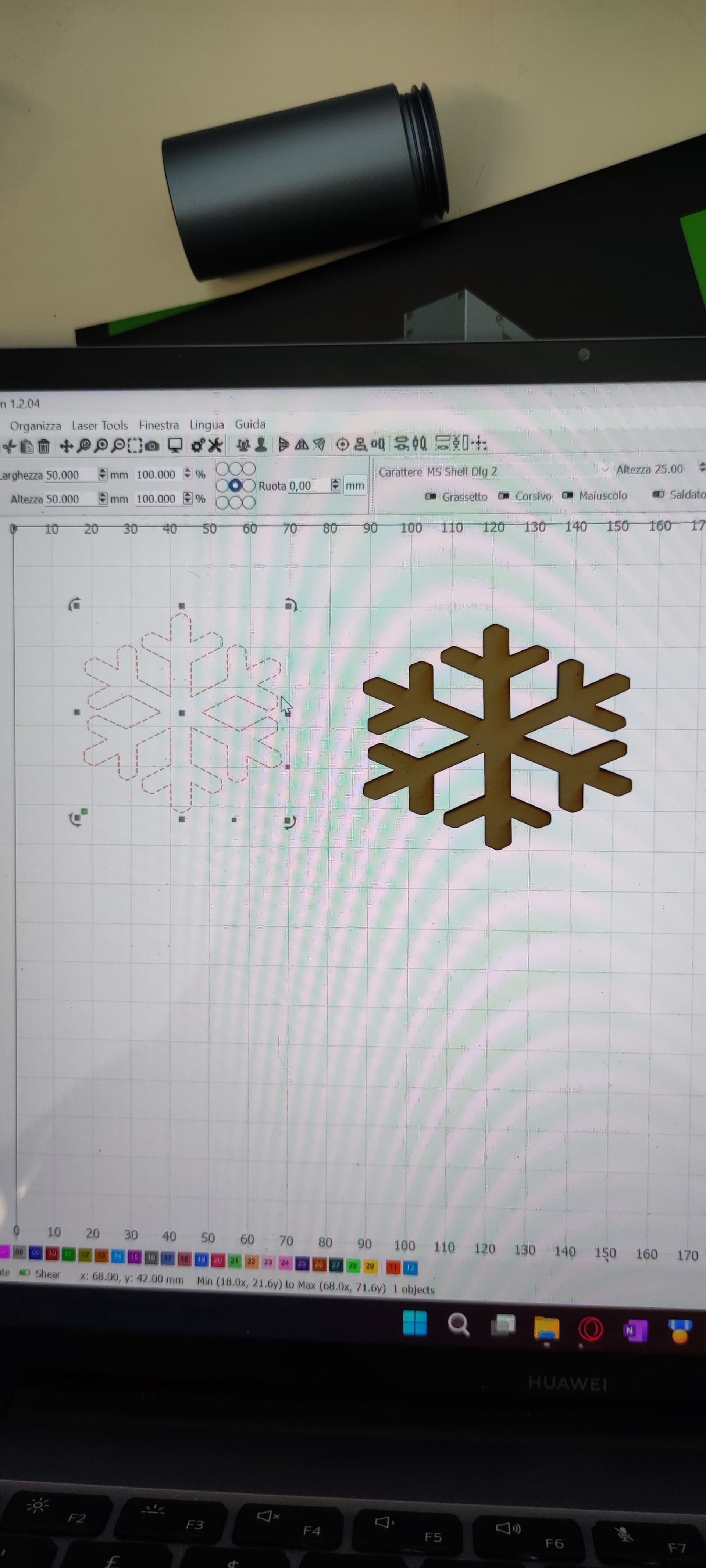

Any idea why even though the sizes are 50x50 the final piece is 50x40?
go to Machine Settings in the edit menu and calibrate. Requested distance and actual should be the same
