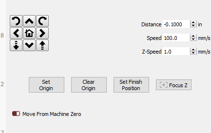

X and Y axis are jogging backwards
Powered up the system and everything was working.
Started setting up my job and I’m always trying to tweak settings to get it better… Now, for some unknown reason, the gantry is moving in the opposite direction I tell it to jog. It is homing correctly. Tried several power cycles.
I’m running a Cohesion 3D board.
What did I do, and how do I undo it?!?
Found it.
The move distance was a negative value. Not sure why this is not an “absolute” value box.
It should be - I don’t think anyone has ever noticed this before. I’ll fix that.
