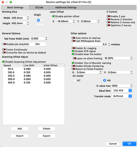

Are you using xtool d1 pro’s .lbdev configuration file from their tutorial?

Yes I went to XCS and installed the lbdev configuration file and followed the set up.after that the laser framing worked.
Hi Jen, for xtool d1 pro should enable Gcode clustering in lightburn be enabled under Device settings checking to see if that was a default setting for my laser? Also, still having issues with Material Settings. I am randomly testing different speeds with different power and this method is not working. The material settings sheet you linked is slim pickins’.for the 20w - there must be a better way to know the min and max speed power to burn the grid for more types of materials. Im trying to work on 80lb card stock it continues to burn through when I run the job. When I created a Material test it barely marked on one and burned up the other. Any additional help on this? Thank you. Is there an instructions guide, a pdf file, for lightburn, and are the steps on how to set up the material test generator. main page and sub pages (edit material settings , edit text settings, edit boarder settings)?
Hi Lisa, if you have imported the correct lbdev file for your laser, your device settings will not have gcode clustering enabled. Your device settings should look like this:

I know I have the lbdev file on my computer It looks like it is installed. Can I open the switch on my xtool d1 pro and hit download to load that file? Is it as simple as that?
To use the .lbdev file, you need to import it into LightBurn.
Go to your Laser tab>Select Devices>Select Import>Select .lbdev file>Click Ok to save>Click on drop down of lasers and select the new imported machine profile from drop down:
You can confirm by comparing your device settings to the image of device settings I posted. If they are correct then you’re good to go, if they aren’t the same as what shows on your computer, please follow the steps above.

I am afraid to import this - will it change any functionality of framing movement? - the way the settings are now I was able to find a perfect engrave setting for my oak plywood sign I’m making. power 18.9 and speed 2133 – this is how my settings look before import
When you import a new device profile in LightBurn it is created as a new device, it does not overwrite the other device. You can simply switch back to the old profile if you wish after.
