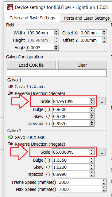

Hello, Using a fiber laser, x / y axis is distorted. As example, a 20 x 20mm square is engraving at 20 x 18.25-ish mm.
What laser is it? You should add your exact laser to your profile.
Did you correctly import the .cfg file when you set up the device?
You can correct for any disparity in each axis in Device Settings–> Galvo Basic settings. “Scale”
