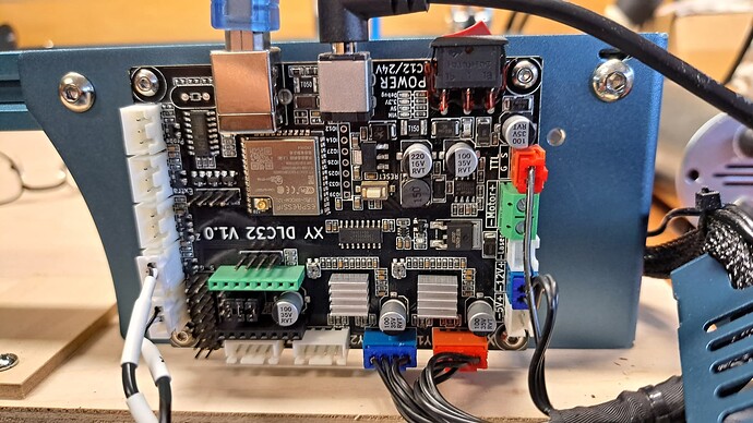

Here’s the board setup with the limit switch plugs swapped and the x/y where they should be. When the switches were installed, the x/y were running opposite, so that’s why I swapped them. Just for grins, I swapped the main x/y (blue and red) and, while the machine movement now operates correctly, the limit switch/home operation did not. I put the switch plugs back in their “correct” location and now they work fine. It’s like I can have one or the other, but not both in the correct location on the board. I think I’ll try unplugging the switches and see if that affects the main x/y.
I unplugged the switch plugs and that made no difference in the main x/y operation. I really don’t want to dig into the firmware, so I guess I’ll just keep the plugs in opposite and see how it runs. I may reach out to Sculpfun and see what they say.

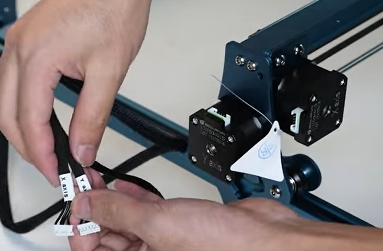

What I think is much more likely is he swapped the cables. The cables are very close together and maybe have been labeled wrong. Just swap them and you are fine. You could use a measurement tool to check if the cables have been labeled wrong, or just swap them without measuring. And you are done. No mainboard exchange required. See the picture how close the motors are, the cables are nearly identical.
