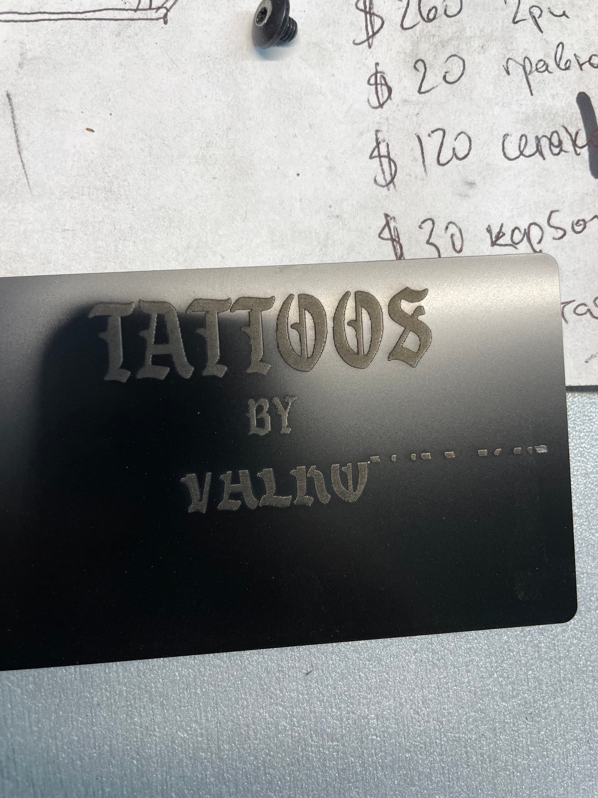

I have this shifting on the X/Y axis every once in a while, it’s completely random, sometimes it goes away if I split things into layers, sometimes it goes away when I change the direction from 90 to 0 or viceversa.
It’s almost always at 50% of a given layer’s content, the motor should change direction (bidirectional engraving, constant power, fill) but it just stops and burrs like it’s reached the end, then continues as usual, but obviously shifted, and it’s always the whole length of the layer’s contents.
It usually happens on the X axis, sometimes on the Y.
Also, it almost always happens on these business cards I engrave, on the larger layers, never on the small ones. And the more stuff there’s in a layer, the higher the chance. I’ve marked plenty of cardboard boxes which take up almost the whole table, and haven’t had a problem with any of em. The issue is only when the layer is on “fill”, never on “line”.

The term I was looking for is that the machine is loosing steps. Most of the time I have seen step loss, it is staggered rather than completely consistent.
A missing “stop and turn around” is what describes is most accurately. Or more like stopping in one spot instead of turning around, but just for one line.

The interesting thing is that when it stops instead of turning around, the motor makes the “krrrr” sound as if the axis has reached it’s end. Sorry for the dumb explanation.

My inclination is that your gantry head is moving fat too fast or too high of acceleration settings. The inertia is over loading your stepper motor.
That’s a perfect description of a stepping motor losing sync with the driver pulses. :grin:

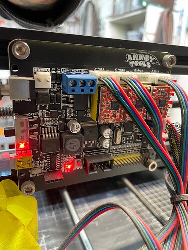

Verify the small trimpot at the top center of each driver PCB is set to provide the proper current for the motors. You’ll need a voltmeter, because the data sheets give the current as a function of the voltage on a PCB test point.
If the motors continue to misbehave with the proper current, then you must reduce the maximum acceleration for the axes to reduce the torque required to get the axes up to speed. You can set those directly in the console with the GRBL $120 and $121 parameters or through the LightBurn Machine Settings.
Reduce them by a factor of ten, which should make the axes respond very slowly and may increase the overscan region beyond the machine boundaries. Increase the acceleration by a factor of two until the motor fails again, then find a compromise between those two values.
