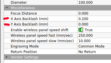

Are you talking about, what looks like backlash at higher speeds? Might check these
Screenshot from 2022-03-13 19-05-37
My stock X acceleration was set at 8,000mm/s^2. Had to pull up the original ‘factory’ backup settings.
I have removed a lot of mass and it is now set to 45,000mm/s^2. I can run it at 1650mm/s… not good for much but fun…
My Y acceleration was/is at 2,000mm/s^2.

In the axis settings I know that the max settings are lower than the vendor settings but I am having troubles with the axis missing steps at above 300mm/s in the x axis.
I guess I should as a better question. How do you determine the max speed?
? - start with low acceleration and max speed to see if the axis can get up to that speed and then start increasing acceleration.
