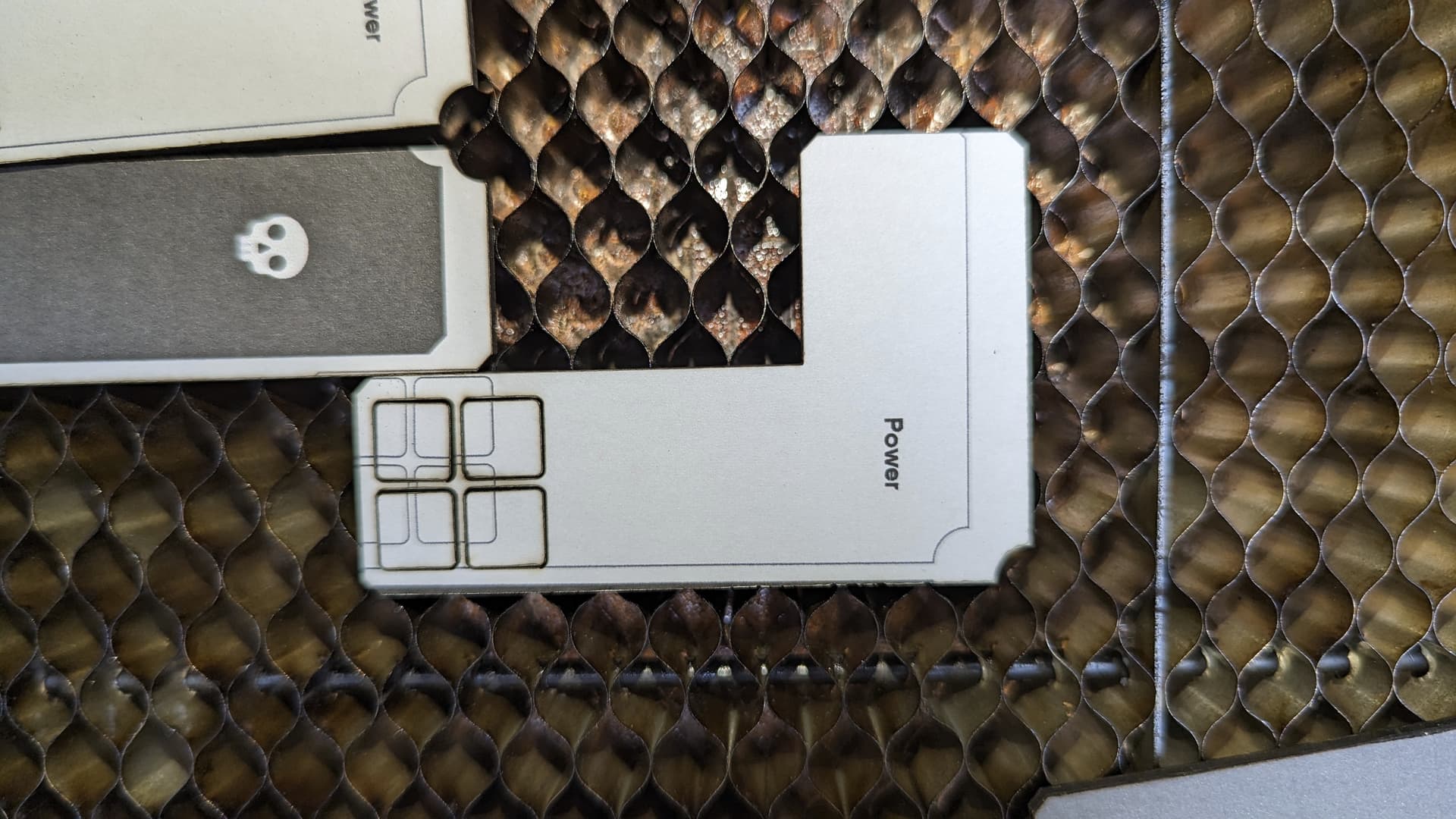

But the laser is going ~3-4% farther than it thinks it’s going: It starts out cutting the top-left pieces out and tracing the outlines. By the time it’s on the bottom right corner of the page, it’s about a full centimeter off. It’s missing the trace lines completely.

One of the cut-out pieces at the bottom right of the page. Note how the arc at the bottom right corner isn’t lining up with the trace-line up-left of it, and the four cut-outs at the bottom-left don’t line up with their trace lines, either.
I’ve pulled out a ruler and confirmed: The ink print is accurate: It wasn’t scaled down. It’s the laser that’s overshooting.

Test the calibration of your laser independently. Create a 100x100mm or larger square and burn it. Then measure the resulting burn. How does the actual burn compare to the designed size?
The original drawing was created in Affinity Designer 2.
Like you suggested, I just an hour ago made a drawing for the purposes of measuring more precisely, and indeed, the print IS off. It doesn’t account for the full error, but on measuring more closely, it looks like that’s where almost half the error is coming from. Changing the “scale” of the print a smidge percentile corrects it.
That still leaves some error to correct in the laser, though. I could brute force it the same way: Scale the cut-drawing down until it matches the print, that I’m scaling up, until they both agree with each other and the ruler. That’s one option.
