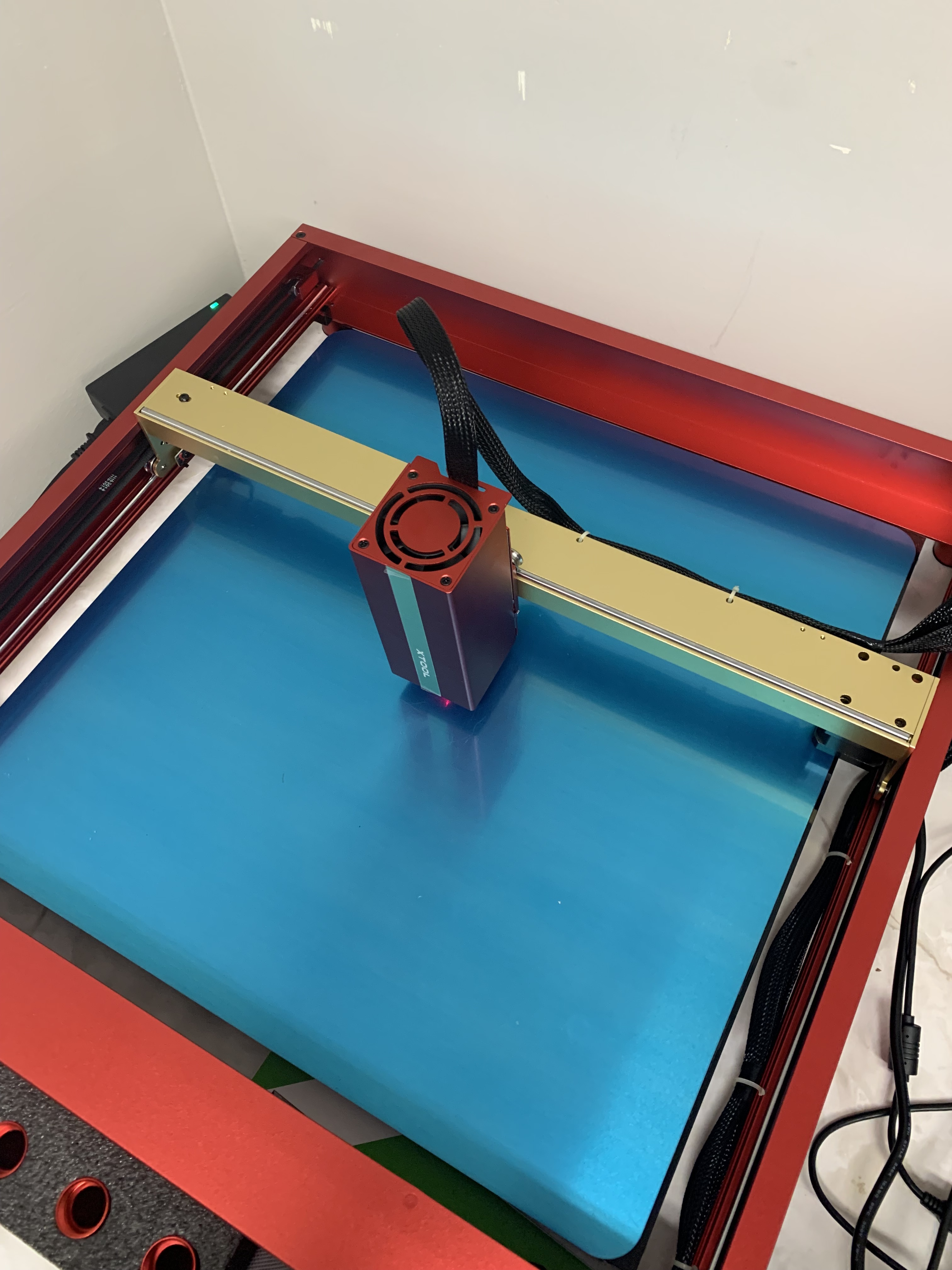

Hi, I’ve been having some trouble with the xTool D1 pro that I work with.
I’ve never used a laser engraver before, so I don’t know much about them and I can’t seem to find a solution to my problem. When I’m using Lightburn and I turn on the laser, it wants to go to the back left corner but when it gets there it tries to keep going and makes a loud grinding noise. The laser works perfectly fine with XCS.
My immediate assumption was that maybe the grid/workspace thing on Lightburn was too big but when I tried to make it smaller it still wants to go too far. After reading some forms and trying their solutions, still nothing works. I’m stumped and not sure if it’s an issue with the homing or if the sensors aren’t working or if it’s something else.
Please help!

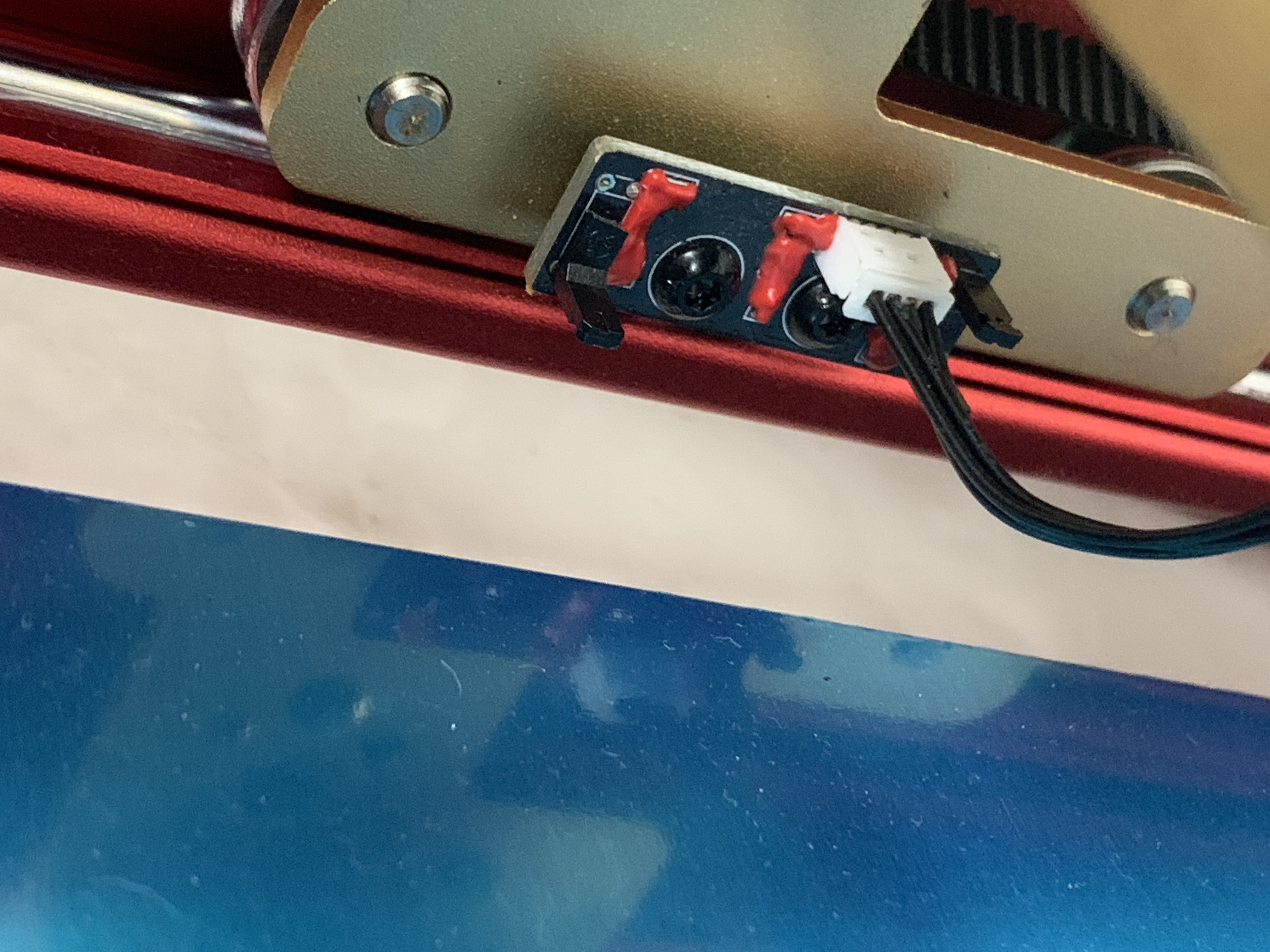

Sounds like it is going where the limit switches are not. Does your machine have limit switches, likely left end of X-axis carriage and left front of the frame?
A picture of the machine would help.
Yes, I just sent pictures of them and a full picture of the machine

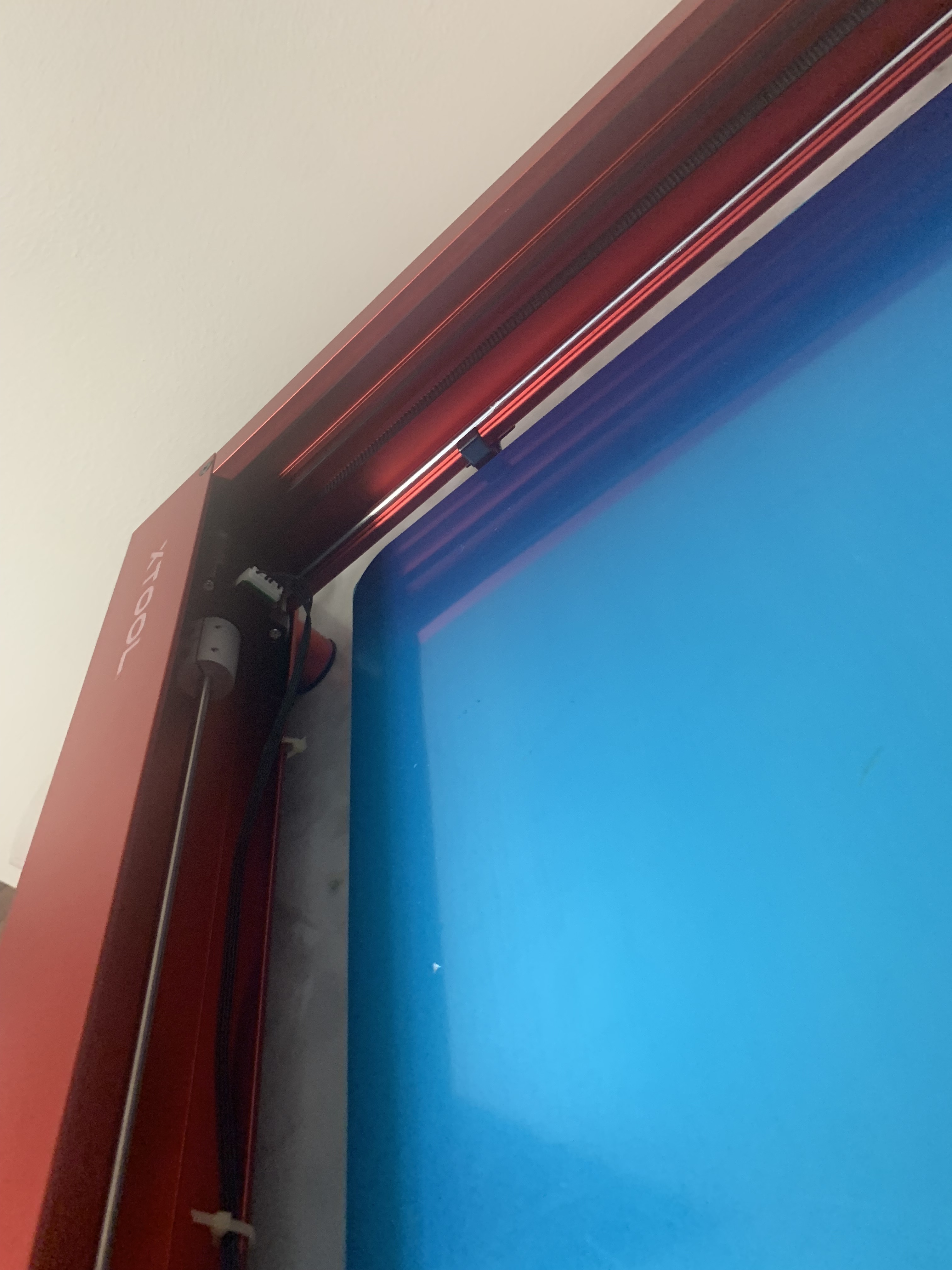

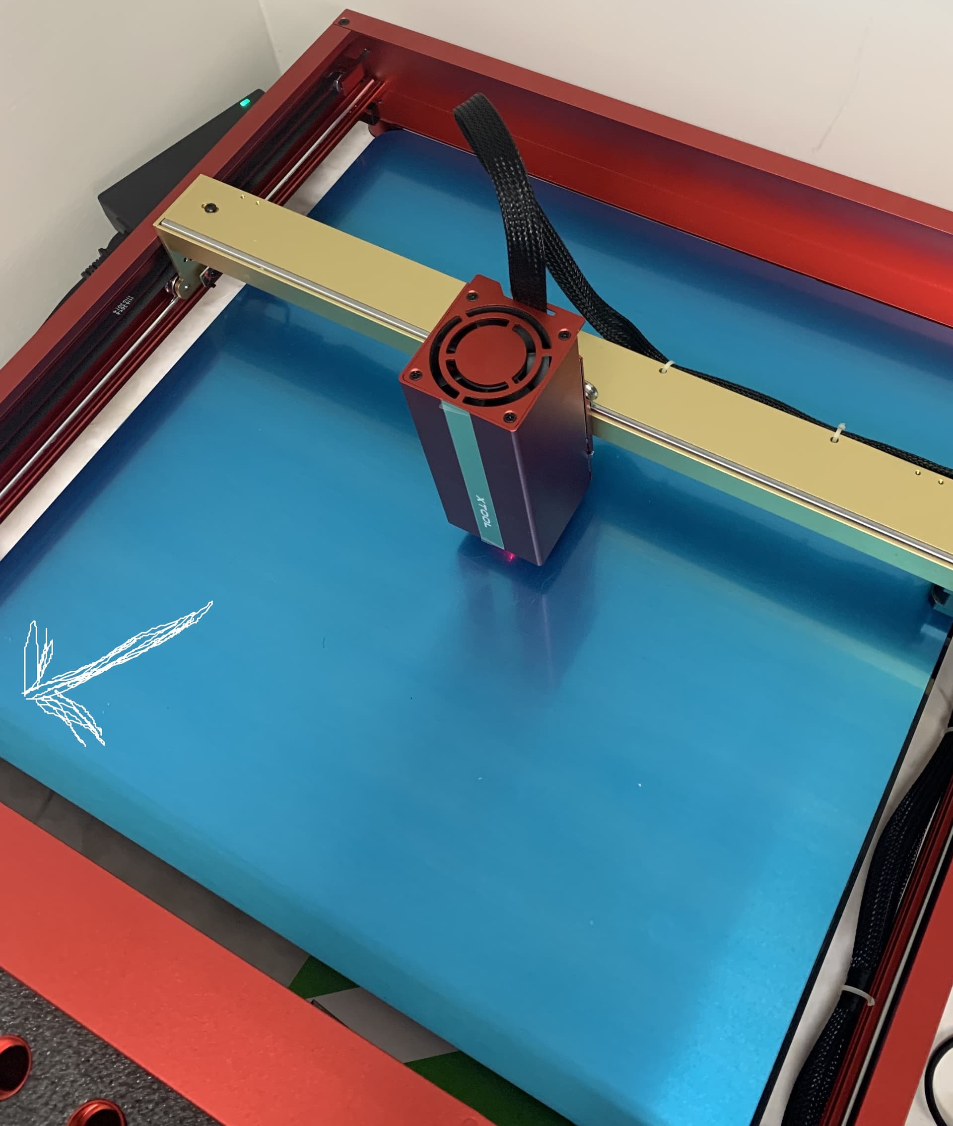

I cannot tell where they are located. Calling the marked corner FRONT-LEFT, where are the switches located on the machine?

Picture of the side you pointed to.

I see a limit switch in the corner, so that should be your 0,0 Home position. $22=1 says homing is enabled. We now need to do a little research before changing any parameters.
