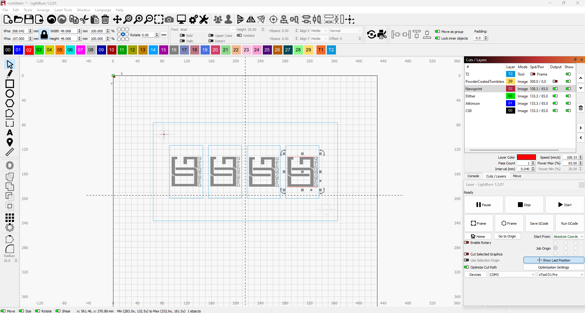

I am having problems with the xTool D1 Pro 20w. It is not starting the job when I hit “Start”, instead it moves the laser to “Home”. I have checked the preview and there is nothing there. I am trying to print a png file to my xTool D1 Pro 20w from Lightburn. It was just working yesterday (4/17/2023) so not sure if it updated over night. I am running version 1.3.01. By the way it will print all other formats…JPEG works just not PNG. Now I know how to change it from PNG to JPEG but why has it stopped print PNG files?
Can you take a full screenshot of LightBurn with your design showing? Please have Cut window and Laser window showing in the screenshot.
I don’t see an obvious issue. Can you upload the .lbrn file here for review?
just a suggestion but have you tried converting the image to raster format by tracing the image and setting the layer to fill? i own a D1pro 20w and normally with an image like the one you are trying to process is easily converted to raster format then process for a preview. maybe trying this instead of trying to process a png file.
fairly new at this too so i would ultimately do what @berainlb has suggested.
