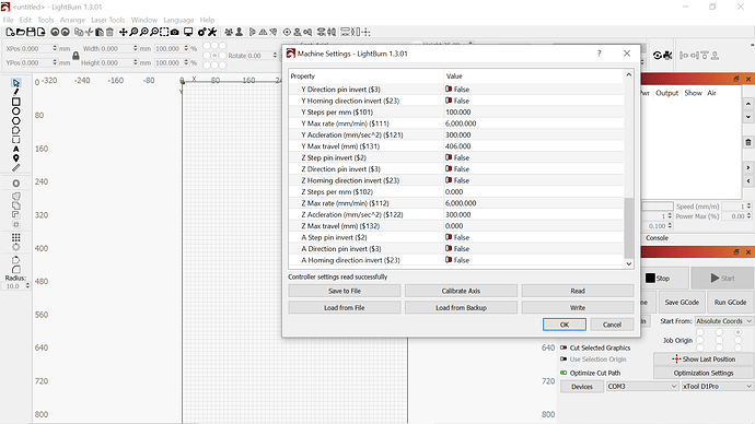

If you’re inclined to test for yourself, you may have access to adjust the axis length setting for yourself.
The X-axis length setting is $130. The Y-axis length is $131.
From the Console window in LightBurn, with the engraver connected, please request the System Information and Machine Settings by typing the following:

Kind of a newby but I think I found what you were asking for.
Thank you for helping me with this issue. I have thought I changed the write ones. xtool states 936mm x 542mm. If the images do not show the info you need please let me know and I will do my best to find it.
You’re on the right track.
You can get the axis lengths by pressing the mostly hidden button under the > (greater than) symbol then scrolling down.
The fast way to get the information is request and copy/paste reports.
Having the $i report from the engraver will also be helpful and I don’t know of another way to generate it.
