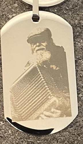

Hey guys,
We switched to the Xtool F1 ultra but are struggling to find a sweet spot for engraving photos. On one photo it keeps messing up the hair like it isn’t starting the engraving with the full power.
Any insights or a good ratio between contrast/dpi and power to try?

used a high res, stock picture

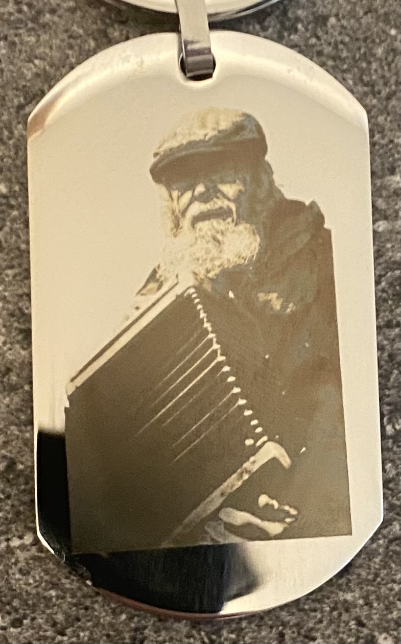

Fiber Laser: Dot duration 250 , power 80, DPI: 750
Fiber Laser: Dot duration 250 , power 100, DPI: 600
on this i used grayscale instead of color.

Ive tried editing the picture, doesnt really change anything, tried different dotting/power/dpi
never comes out to where u could say " it looks ok"
Are you using a dither or grayscale? Grayscale is much more difficult.
im using jarvis
Suggest you find what settings allow you to make a black mark then attempt to do an image. This gives you better contrast if the laser marks in black.
If you haven’t, then you should watch the Laser Everything video on photo engraving. Their process works for any laser with any material… they did it with a fiber.
