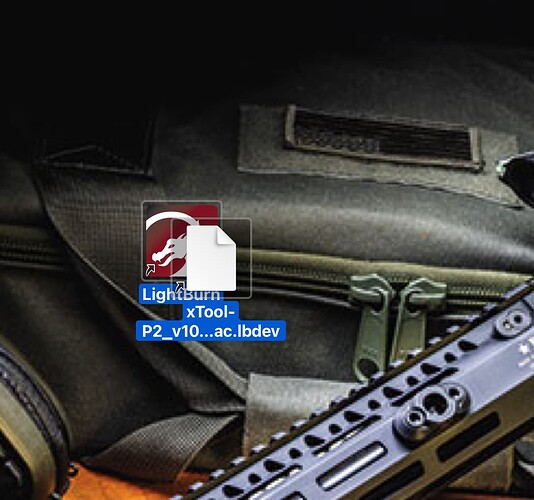

Here is the screen shot. If I try and drag and drop the p2 file it does nothing. If I double click on it it tells me there is no program to open it
Is Lightburn open and running? The instructions say…
Download the xTool_P2.lbdev configuration file and drag it to LightBurn to install it
Looks like the desktop…?

First open LightBurn. Then drag the .lbdev file onto the open application.
If that doesn’t work, then push the Devices button in Laser window, then Import, then select the .lbdev file.
