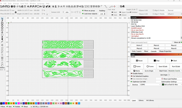

I’ve encountered an issue where the laser stops engraving mid-burn, it’s happened several times. It’s driving me mad. I can’t understand what’s going on. Has anyone else had this issue?
Can you give more details on how it’s stopping?
Is it disconnecting or does it just stop running?
Can you let us know what firmware version it is and share an example project to test on our machine?
Hi Joe,
Thanks for getting back to me. In answer to your first question the Laser Just stops, I then have to click on the preview window and restart at a point as near as I can get to where it stopped. I’ve also noticed that the countdown timer and green bar carries on running. It doesn’t matter if I speed up or slow down the burn it still does the same. It started doing this a few weeks ago. I’ve exported the project as an SVG and opened it up in xcs and it runs there with no bother. I much prefer Lightburn though. I’ve taken a screenshot of the firmware and uploaded two of the most recent projects I’ve had this issue with. Hope you can help, many thanks, Steve.
Celtic Knot Book Mark.lbrn2 (954.0 KB)
Rip Saw Push Stick Mk2.lbrn2 (2.4 MB)

Hi Joe, I’ve been researching everything I can think of and have drawn a blank. I have been watching the “show all” Gcode scrolling by in the console tab whilst running a job and noticed that the Gcode just stopped scrolling a second or so before the laser stopped mid-job. I hope this bit of info helps. Steve.

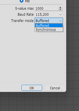

Can you try going to ‘Edit > Device Settings’ and change the transfer mode from Buffered to Synchronous in the lower right corner?
This changes how LightBurn sends commands to your laser. Rather than sending the commands into a buffer (like a tank that your laser draws from at will) this sends the commands as they are needed. It might be the solution. It also may make for odd/slow movements if the S1 doesn’t like it. Give it a try and let us know.
Hi Colin, Ive tried your suggestion but it didn’t work as the laser didn’t even start. So I’ve reverted to my older workshop laptop that has an earlier version of 1.7 and the program ran without incident . So ive compared laptop settings and they are all the same so Im guessing it might be a bug in the latest beta version.
If the g code stream ended like you saw it would make sense that the laser stopped. It simply stopped receiving instructions. Something had interrupted the communication stream. We will have to work out the issue there.
You said you changed computers and it worked? What’s different between the computers? Ports? OS? LB version?
