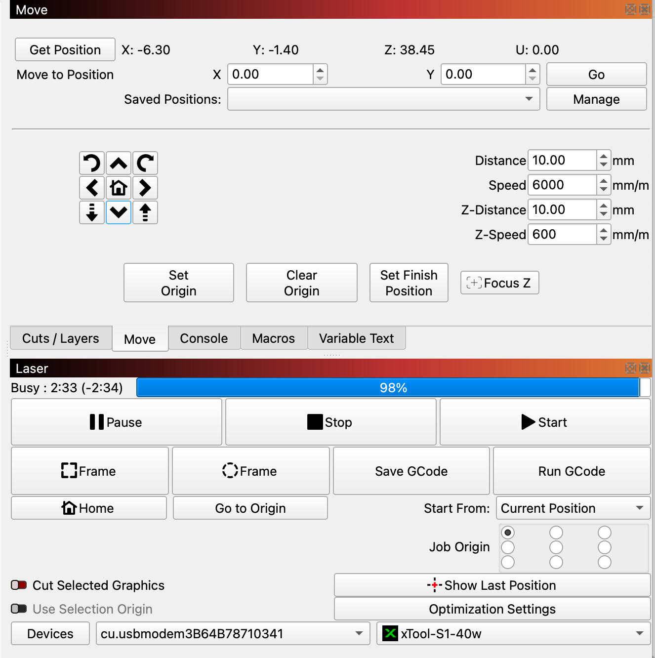

I tried the trial of LightBurn (v2.0.05 and v2.1.00-RC-1) with the xTool S1 and have had great results. Notified of a firmware update, which I installed and I have had the laser head slow down and over burn my project in numerous areas. Now when connecting my S1 doesn’t home, and I can move via LightBurn but each movement shows it streaming until I click on the stop button. Moving again causes the same issues.

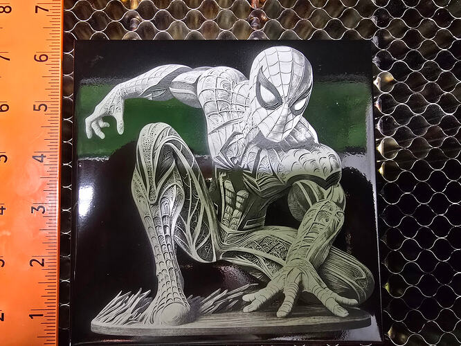

Once again, I was able to burn a tile last night with a file prepped in Imag-R at 635 DPI using the MacBook with my xTool S1 10W module with the GRBL configuration using xTool instructions. 200mm/s Speed, 21% Power, 635 DPI, Pass-through (as Kasia / White Tile Painted Black dithering was performed in Imag-R).

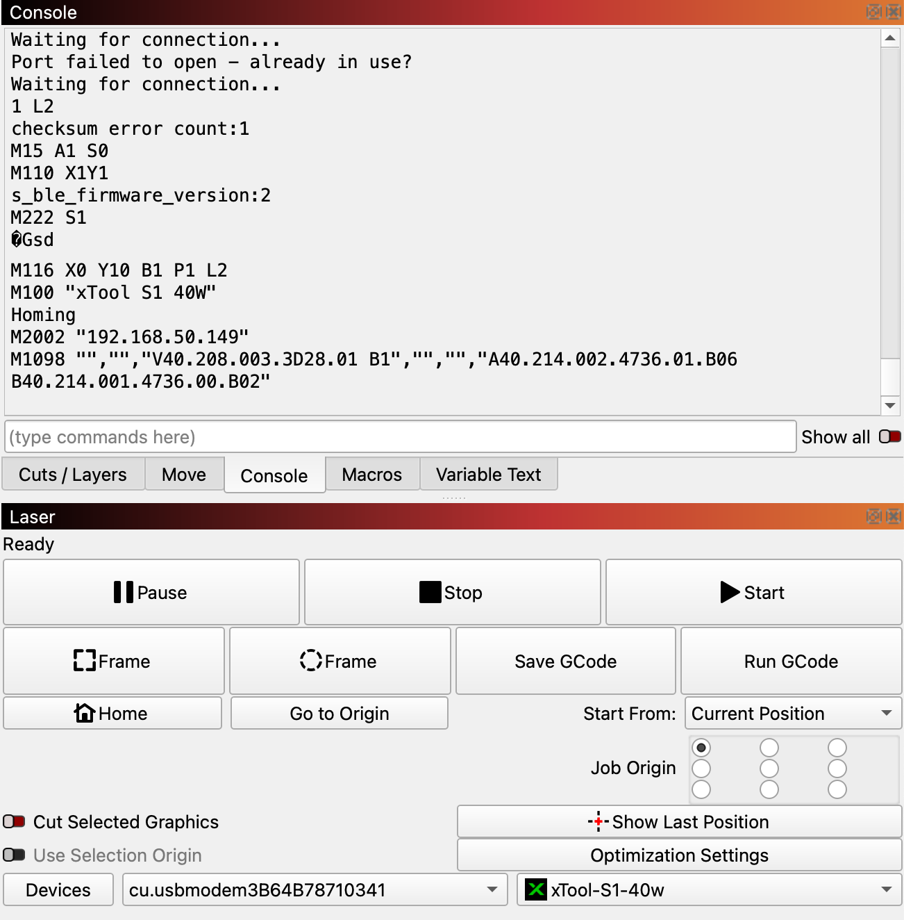

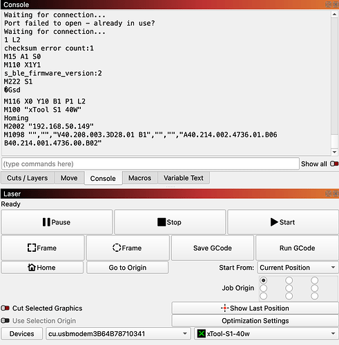

When I use config in the bundle that you sent I get the following when first connecting:
Checksum error, no movement to the Homing command, non-text ASCII, and if I try to Move the laser head using the Move tab there is constant streaming and I have to click on the Stop button.

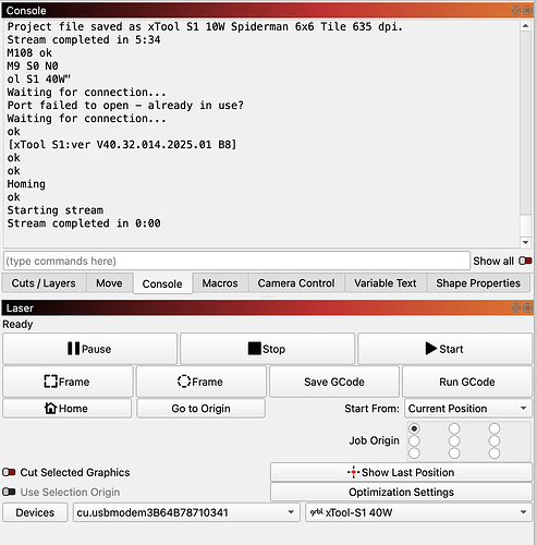

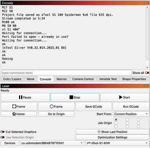

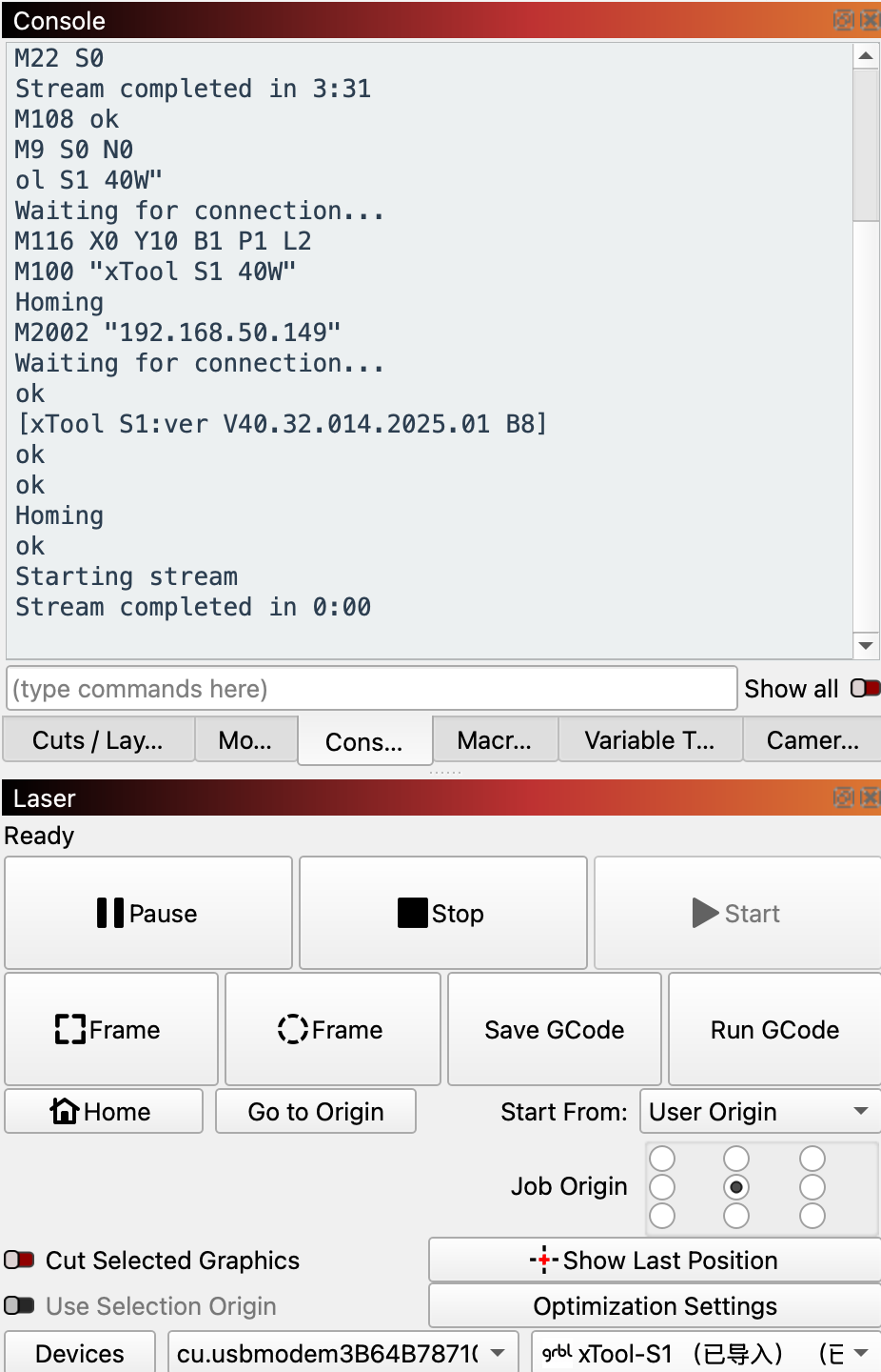

I don’t have any of those issues when I switch to the xTool recommended (GRBL) config in LightBurn 2.0.05:

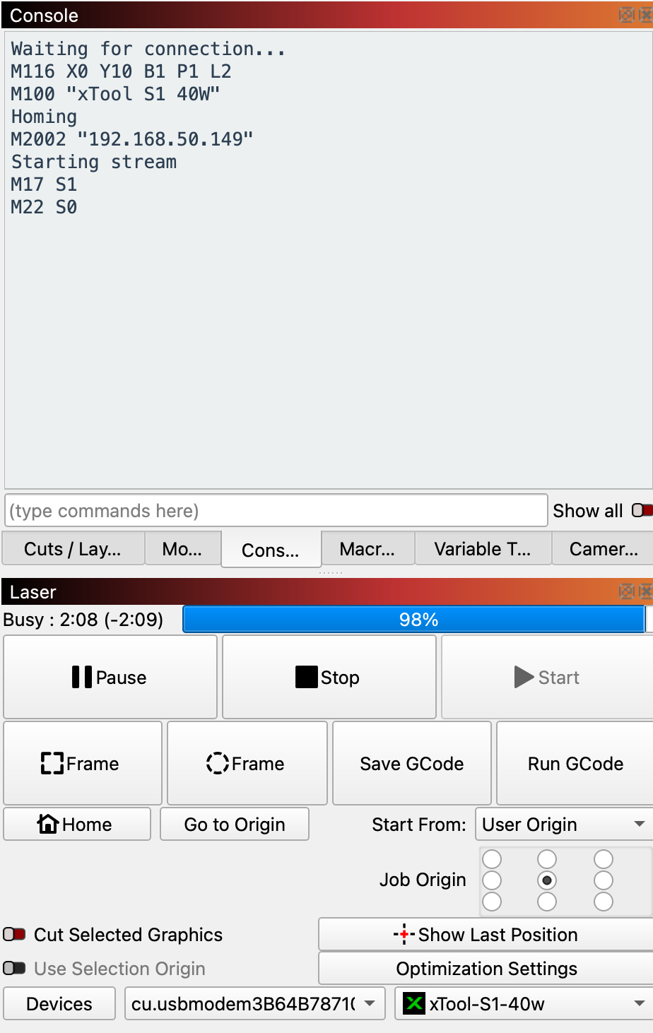

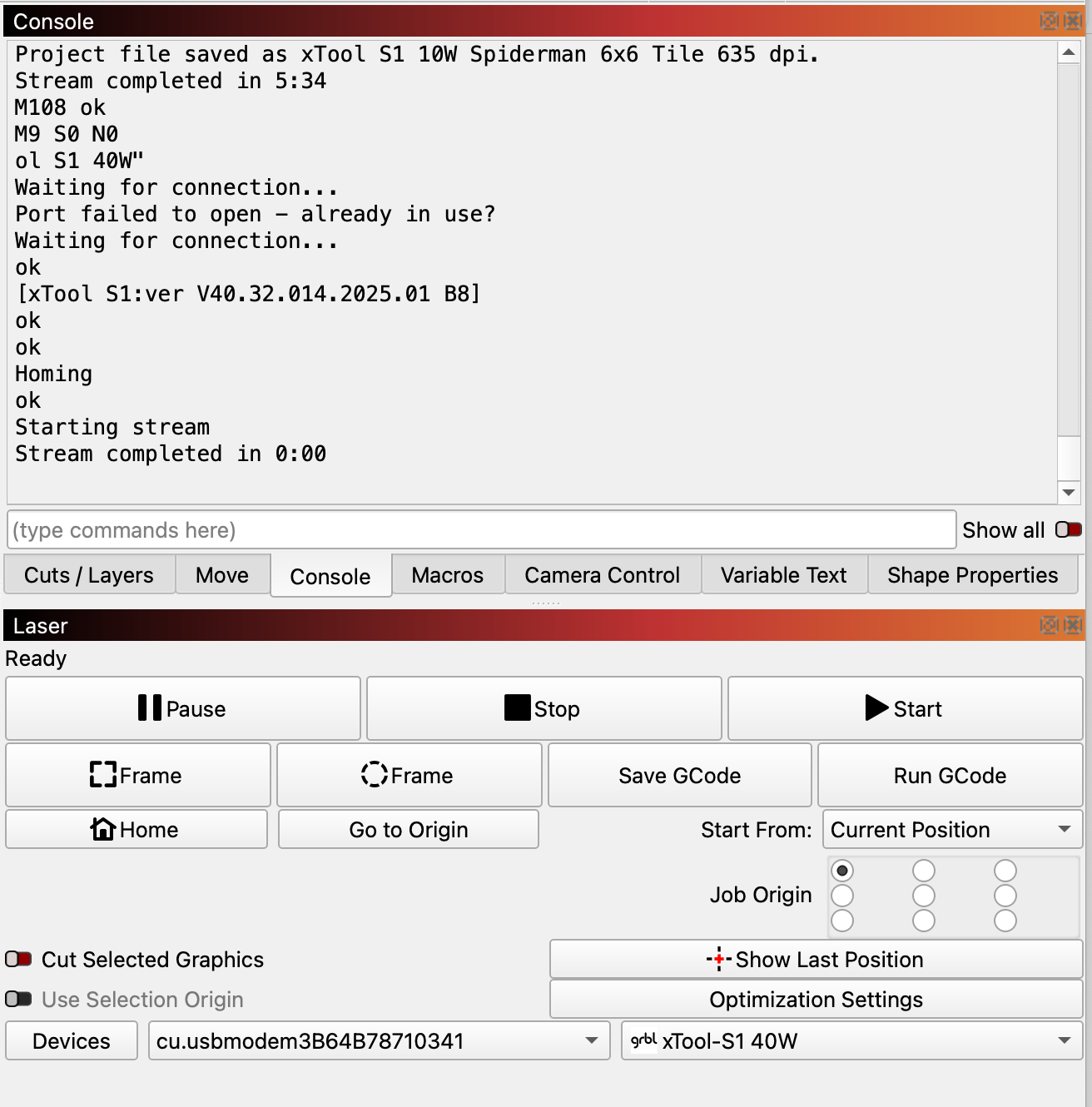

In LightBurn Pro 2.1.00-RC-1, I don’t get the checksum error, nor the non-text ASCII code using your config in the bundle you posted. My S1 still doesn’t home and has the streaming issues after attempting a move using your config in the bundle you posted:

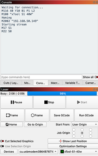

I don’t have any of those issues when I switch to the xTool recommended (GRBL) config in LightBurn Pro 2.1.00-RC-1:
