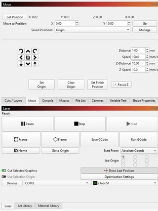

OK, with some help (both here and over on the XTool S1 Reddit), I’ve figured this out.
In the latest Lightburn, there’s a button for Z focus in the Move tab:
Pressing this did what I expected/hoped. It did the 2-part focus (measured to the material, then moved and measured to its reference point, and returned to the starting point.) Then running a quick test burn produced the same results that I was getting from XTool Studio.
Now I -think- this requires the .lbdev file to be loaded first to get that to appear in the Move tab.
I’m not sure if I need to do this before each burn, or just when changing material.
I still need to play a bit more with the left side framing problem.
That’s correct. But only if you import our device profile from this post:
xTool’s device profile from their support page won’t work.
“Focus Z” is only needed when you change to a material of a different thickness. the Z axis should not move in between jobs.

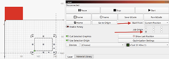

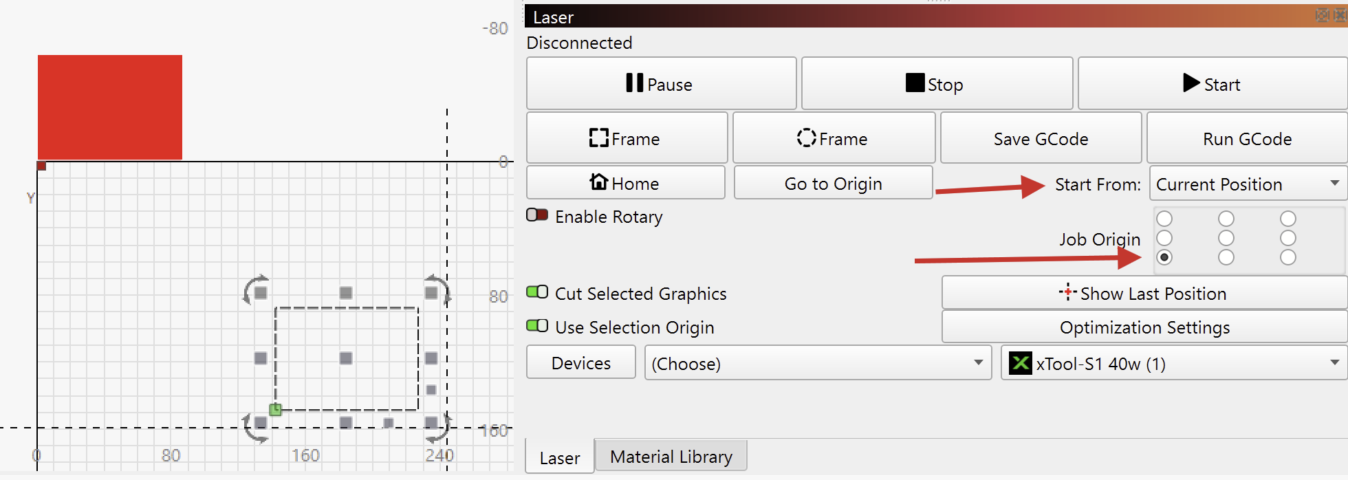

Which “Start From” value did you use?
If you start a job from “Current Position” with origin at the bottom left and the head in the home position, you basically tell the laser to engrave outside the workarea. Most lasers will throw an error if they receive “Move out of range”, but it’s possible that xTool doesn’t do that.
In this example here, sending the black shape would tell the laser to engrave it where the red shape is:
Review this docs page for more details on the “Start From” values:
Absolute Coordinates is the most intuitive option here.

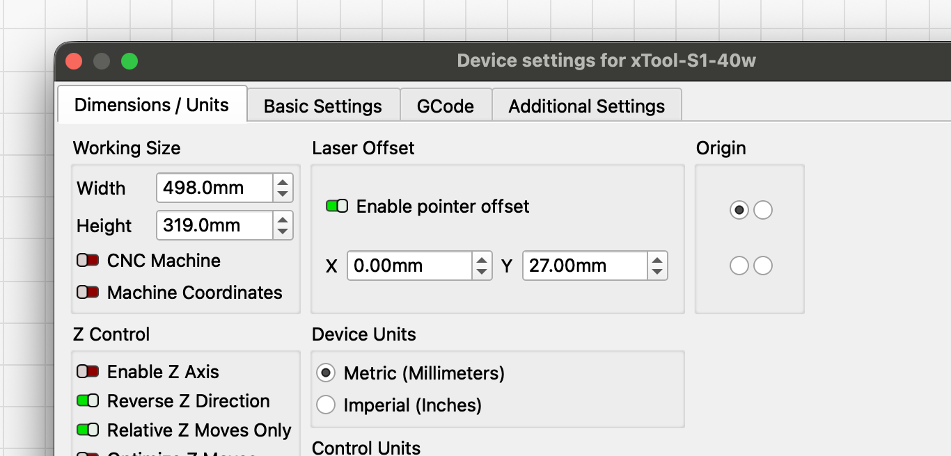

I’ve been trying to do my homework… In particular I reviewed this thread on the S1 Setting up xTool S1 with new xTool device type in LB 1.7 and Beyond Do these instructions/lbdev file also resolve the offset between the red crosshair and the actual laser location? If not, how do I figure out the offset to manually enter?
If you have the 40w yes it will. If its a different diode you will need to adjust it in device settings.
What’s the procedure for this? Never mind, I found it: Laser Offset Setup for Red Dot Pointers - LightBurn User Guide
One last (I hope :grinning_face: ) question: I ran the laser offset procedure (got a value of X 0.0 mm, y 23 mm for the S1 10w laser). I did this in the middle of the piece. Then I moved the head to the far left. I got an “out of bounds” warning, but (resetting the positioning for the 2 squares burn to be top left corner), when I printed, the shape was placed exactly where I expected. I also ran ‘2 boxes’ in the middle of the bed, with no warning.
@JoeSpanier : you got Y 27mm for the 40w, I got Y 23mm for the 10w. Any thoughts on the 4 mm difference? That’s more than just the kerf difference, I would think. I guess it’s the difference in the 2 laser enclosures/positioning of the laser within the enclosure.
