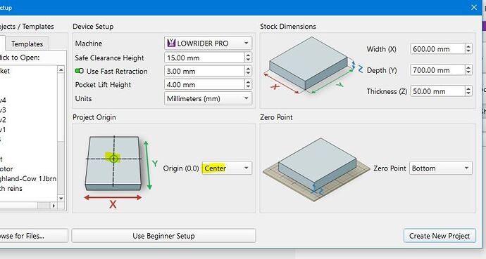

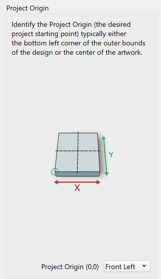

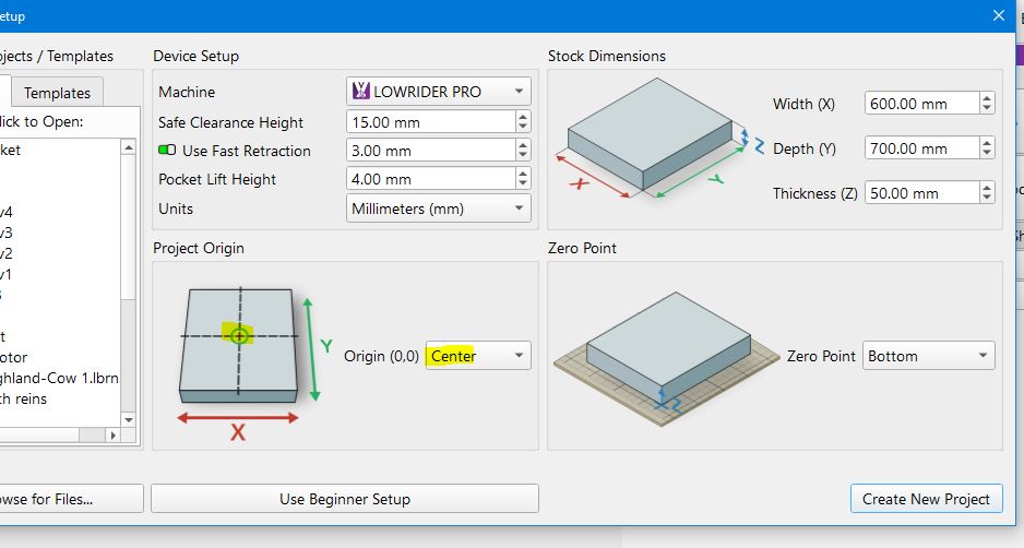

are you talking about zero or home and what are your project origins set to???

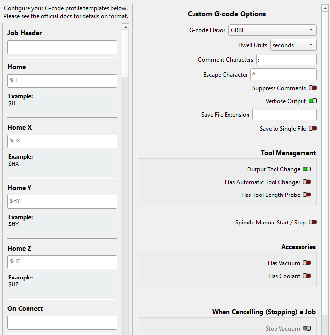

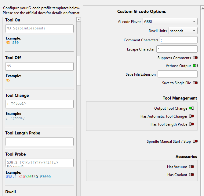

Sorry it took me a while to upload the custom gcodes - have never used them, nor knew they existed.
It moves as though the xy are trying to home.

Generally speaking, you should never need to re-zero X and Y during a multi-tool operation. You would only re-zero Z when you change tools.
having a look through control mode there dosent seem to be any codes for wher its going to change tools
would it defult and go to x0y0 to change tool but not actually home them as there are noc custom g codes either
doing a round piece i would set origin to center set center of material to theer
