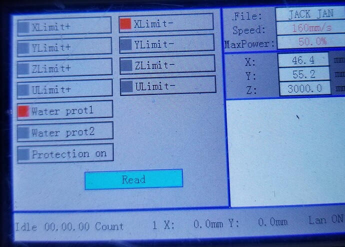

On my Ruida, which is a 6442g, there are leds on the controller and I can use the console via Z/U → diagnosis to see what the machine sees.
This is from my machine and shows the X home switch is active and the water protection is active.

You haven’t told us where the led is lit. Without information, we can’t help you.
I thought i mentioned in my original post. Limit Y, LED is illuminated
On the switch itself, I assume.
These are generally Hall effect sensors and trigger when a Ferris object gets close enough.
If there is nothing near the switch, it should be off. You can usually find the X switch so you can see if they are working in the same manner… Like is Y stuck on all the time?
If it’s stuck on, then you’ll have to pick up a replacement from Amazon or something. Most of these are NPN type switches or an open collector, hall effect. This is from my machine.

These are actually used as home switches.
The Ruida has separate inputs if you want to involve limit switches. These are labeled as +, instead of the home switches which are -.
Once it boots, it never sees/looks at the home switches, but will halt with a limit switch…
