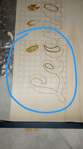

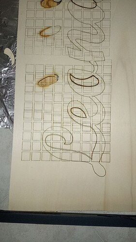

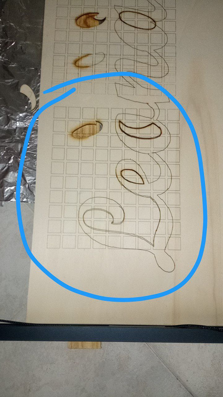

Hi, i’ve been having y axis shift issues with my sculpfun laser (with X & Y extension and yes i have the latest version of LB): basically when it starts cutting the lines on the y axis (after a few passes) will start to shift “upwards”.
I tried cheking if it was some mechanical issue by engraving some grids to check if it was the belts fault or some other “physical” issue but i had no luck, either the engrave would be ok after the first pass or it would totally mess up after the second one.
I uploaded some images to show you the issue.
*the circled image is the first pass, the next image (where you can see the problem has manifested) is the same grid after the second pass
Some user solved this issue by tunring down the resistance screw but it didn’t work.
I hope explained well the problem, i’ve had this issue since i bought this laser and it’s been a very dishartening experience
Given the even spacing I suspect the main issue is lack of tension on your Y belt
As you extended it you must tighten it a bit more than expected.
It s the same thing i thought! I tripled checked the tension and I deduced It’s fine, since circles or other more particular forms came out well ( the big letters you see under the grids were engraved before i calibrated the belts)
Is a matter of travle distance
I am assuming - and you can check on the preview window - the laser is doing a lot of travle then coming BACK to do the interior bits. This means a little bit of tension mismatch will be exacerbated - I believe that is what you are seeing
