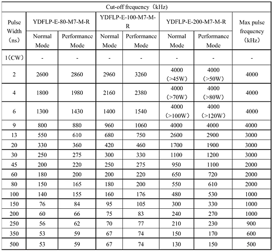

YDFLP-E2-100-M7-M-R Frequency Table
First time galvo user.
I can’t find a frequency table for the YDFLP-E2-100-M7 - I can find the E table, which is as below, and as I understand it the E is made with canadian/french parts and the E2 is just chinese copy parts which makes it cheaper but perform similarly.
If it’s the same, I assume for deep engraving, I need a high Q Pulse (200-500), how in general do I work out the frequency for settings like this?
Ie, if I start at Qpulse 500, and a frequency of 67, that’s the minimum frequency so I should go higher? Is there any rules on frequency use like this? If I go at a very fast speed, I will get less pulses per mm, which I assume means less heat which is less warping and therefore I need to balance speed and pulses to get higher resolution but not overdo it.
Is there an idiots guide to this?
In this context, the cut off frequency (67kHz) is the maximum frequency that will put out 100% power at the given q-pulse; frequencies higher than that, up to the maximum frequency (500 kHz in this case) will work but won’t see the same linear scaling behaviour from below 67kHz.
say at 30 ns pulse width, from 1-300kHz you will see power increasing linearly. from 300 - 3000kHz, you won’t see any higher total power being put out. So at 150 kHz you have “50w” of power. at 300 you have an output of “100w”. at 1200 you have “100w”.
thanks fins
So the “performance mode” is likely 100% power and “Normal mode” is probably 90% as there’s a 10% difference between all of the numbers.
With that in mind I presume there’s no point using it at 95% power on normal mode as that’s a further decrease in power. I should use 95% on performance mode?
Seems odd to add an extra frequency set. It just added additional confusion.
In short, the idiot guide is “follow the table and adjust your power in lightburn appropriately”
“Performance mode” must be activated through an RS232 DB9 serial port inside the machine. There’s PC software for it. It unlocks about 10% more power, but has a slightly more limited operating temp range. The software also has more diagnostic info about errors, warning, and temp stats.
You will need to take the side off the case to physically plug into that DB9.
There’s no “idiots guide”.

I have had a response back from JPT on the E2 and some of the down power settings are different to the E2, mostly lower than the E in the frequency range.
Hope this helps those who are using the E2s.

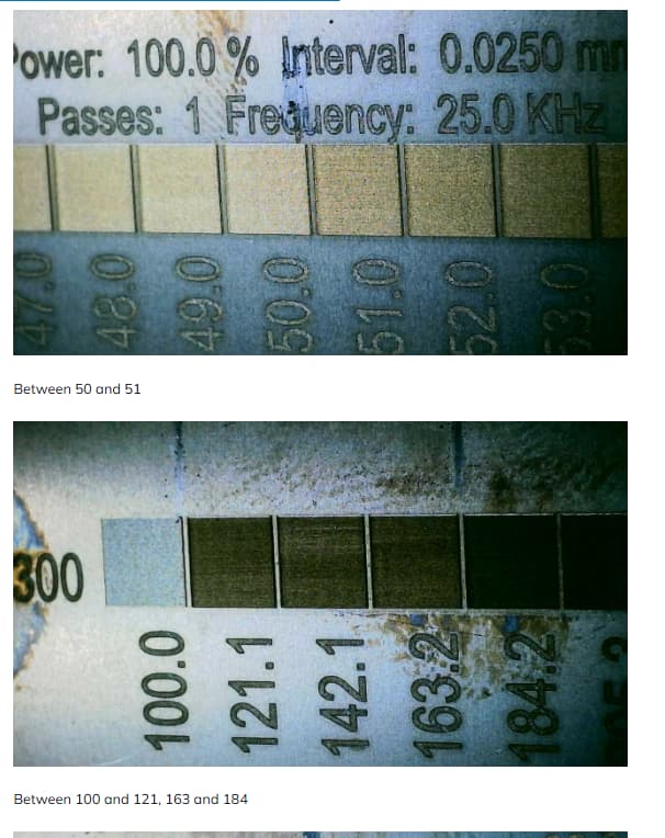

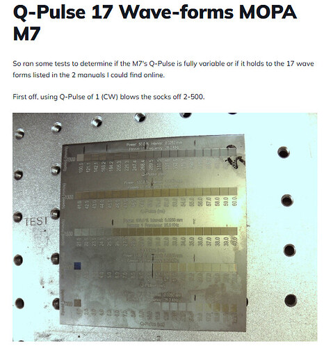

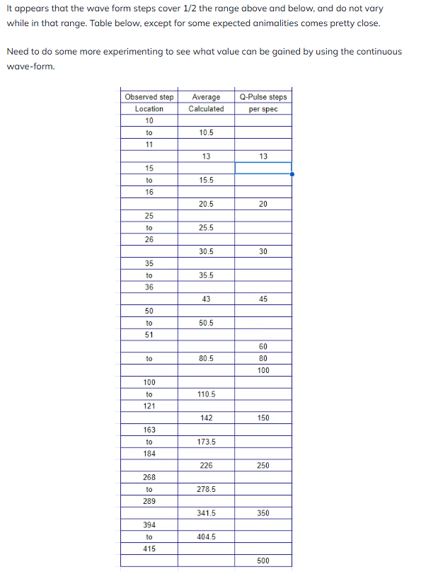

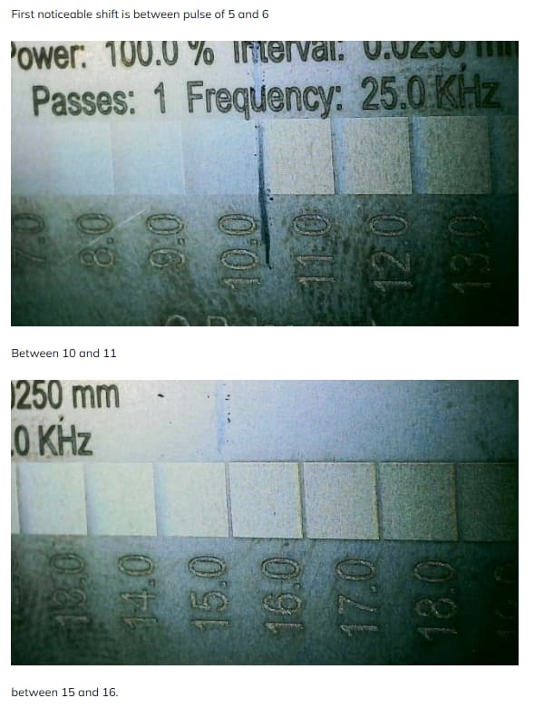

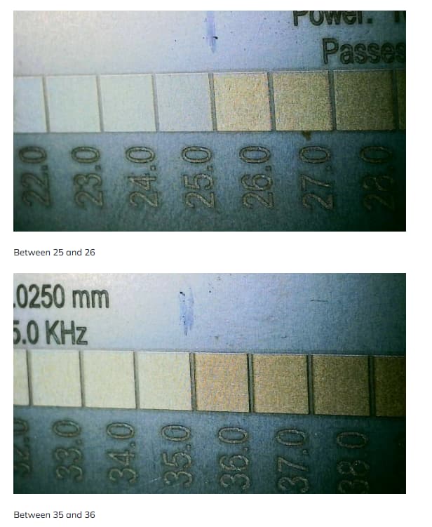

JPT MOPA will ONLY take one of the ~13 defined Q-pulse lengths. It is communicated digitally so it either matches or it doesn’t.
My JPT MOPA manual says if it doesn’t match, it changes it to the nearest valid type. I don’t know if that’s round-up, down, or where the crossover point is, doesn’t really matter. Use a valid pulse type for predictable behavior.
Note that each q-pulse type has a “cutoff-freq” and “max bandwidth”. In addition to “% power”
Assuming you specify 100% power, the power from each pulse is the same as long as you stay under the cutoff freq. So when you double the freq, the total avg power out doubles. You will max out the machine output for each q-pulse type at 100% power at the cutoff freq.
Above the cut-off, the machine will limit the power under the hood, the avg power output is basically constant. pulses get weaker but the freq does increase. afaik it shapes the individual pulse the same way as entering <100% power.
there is also a max bandwidth (max freq). I am pretty sure the source will protect itserlf but not sure how. Probably either skips the next pulse entirely until the min period counter resets, or reduces it to the max bw freq. Doesn’t matter as long as it doesn’t burn up from mistyping, because there’s no reason it want to use it near there.
I have not yet found any reason to go above the cut-off. The MOPA’s whole thing is the explosive power of its short pulses. More freq but lower power does not seem useful. If you need higher freq, go with a shorter q-pulse that covers your freq requirement within its cut-off rather than going with a longer pulse with its power throttled.
One NEAT trick is a q-pulse if 0 turns off the q-pulse, it opens the gate. The output is continuous, not pulsed. The % power does control the output. If you want to just heat something, this is probably what you want. Also if you want to heat without marking it you can raise the z to defocus it.

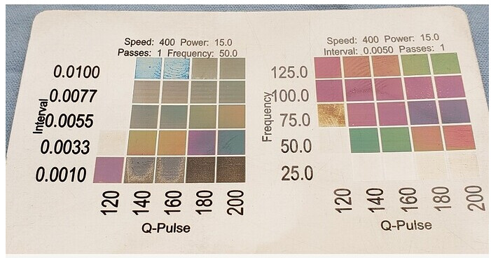

In rastering, you use the minimum focal spot size to determine your line interval, but also you want to fire pulses along the line at about the same rate. So speed/freq = line interval, more or less.
So I start with a line interval that doesn’t have gaps or overlap, specified a scan speed, then I have a freq requirement. I look to the chart for the longest q-pulse that still puts that freq below the cutoff if you want the most powerful output. If that’s too much, keep Power at 100% but go with a shorter q-pulse to throttle back. Because, again, the whole game of the MOPA is explosive power of a short-duty pulse. IMHO we generally want to throttle back with a shorter pulse at the highest power rather than the longer pulse at lower power to increase the explosive pulse power while keeping the average thermal heating as low as it can be.
I’m still a bit unclear on the science of getting colors on stainless, though. I can get colors but not necessarily the fastest, deepest settings. And it’s so weird that there’s an area where color shifts in a continuous spectrum as power increases, then it just burns, but then sometimes I find isolated one-off colors- like green at a specific LI/power/q-pulse/freq/speed, but no other colors adjacent to it on a settings grid. Weird.
I’ve confirmed this with testing on my 60W, it does go to the nearest valid pulse.

Rounding up?
How do you know?
Easy to test, do a material test on SS in the color ranges with q pulse variable from 100 to 200 You will see duplicates above and below the listed q pulses. I did 100 squares on titanium, posted it here a while back.
I posted this over on LMA a while back. A few mistakes but the test is still solid.

I have been looking for interesting things to do with CW (q-pulse=1). I figured this would be the best for coloring stainless because it shouldn’t actually engrave out a piece of metal, but it tends to heat and warp the sheet without getting a color change. This is actually a riddle I’m trying figure out- the color seems to hinge on pulses being able to create surface heat and get the color change on a single pass. It actually won’t work consistently if it relies on the prior raster line to still be hot, because the time since the last pass varies by graphic width. It wouldn’t be very useful to have the color vary by width of the raster.
CW might be useful for doing PCB reflow and rework. You could put the outline of a BGA device into LB, defocus it a bit, and CW would be the best choice since no pulsing damage. Just scan over and over to heat the device until it lifts. You don’t have to worry about plastic headers next to the target like you do with hot air.
I’ve got a theory that color change can be a lot faster and more consistent if you do a prep pass first. I haven’t gotten consistent success yet though. It seems to have the capacity to work better though.
