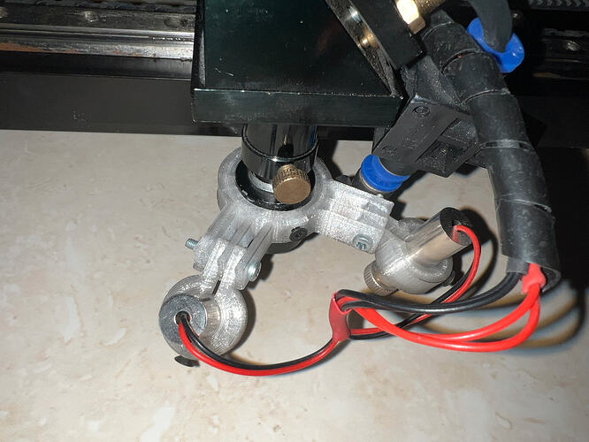

I’ve created something along that line, no pun intended. It uses a pair of line lasers, straight line, not cross. In so doing and placing the laser ninety degrees apart, they will always cross at the burn point, regardless of nozzle height. I tend to bump things a bit, which means that I have to adjust them periodically.
I can’t recall if this is PETG, but I think it might be, as the previous iteration fractured over time.
In taking these images moments ago, I discovered that the left line laser is weak and may need to be replaced.
I will typically focus the nozzle, pop off a pulse burn in a convenient location and set the cross point of the two lines. Once set, they will cross at the dot regardless of height.
The 3D print files are available on request in OpenSCAD format for easy modification on request, if one tends to such things.

Left laser pointer could be smoke covered. Try cleaning it first.
thanks for the cleaning suggestion. lately, things have been slipping my alleged mind and that one should have been secured in a better manner.

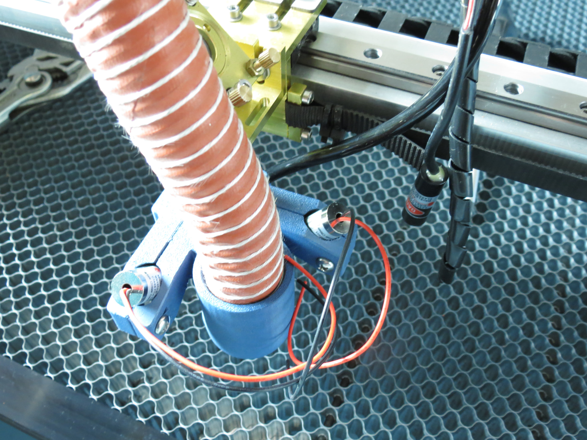

First results, just for entertainment:
Seems to work fine, but I need to solve some problems:

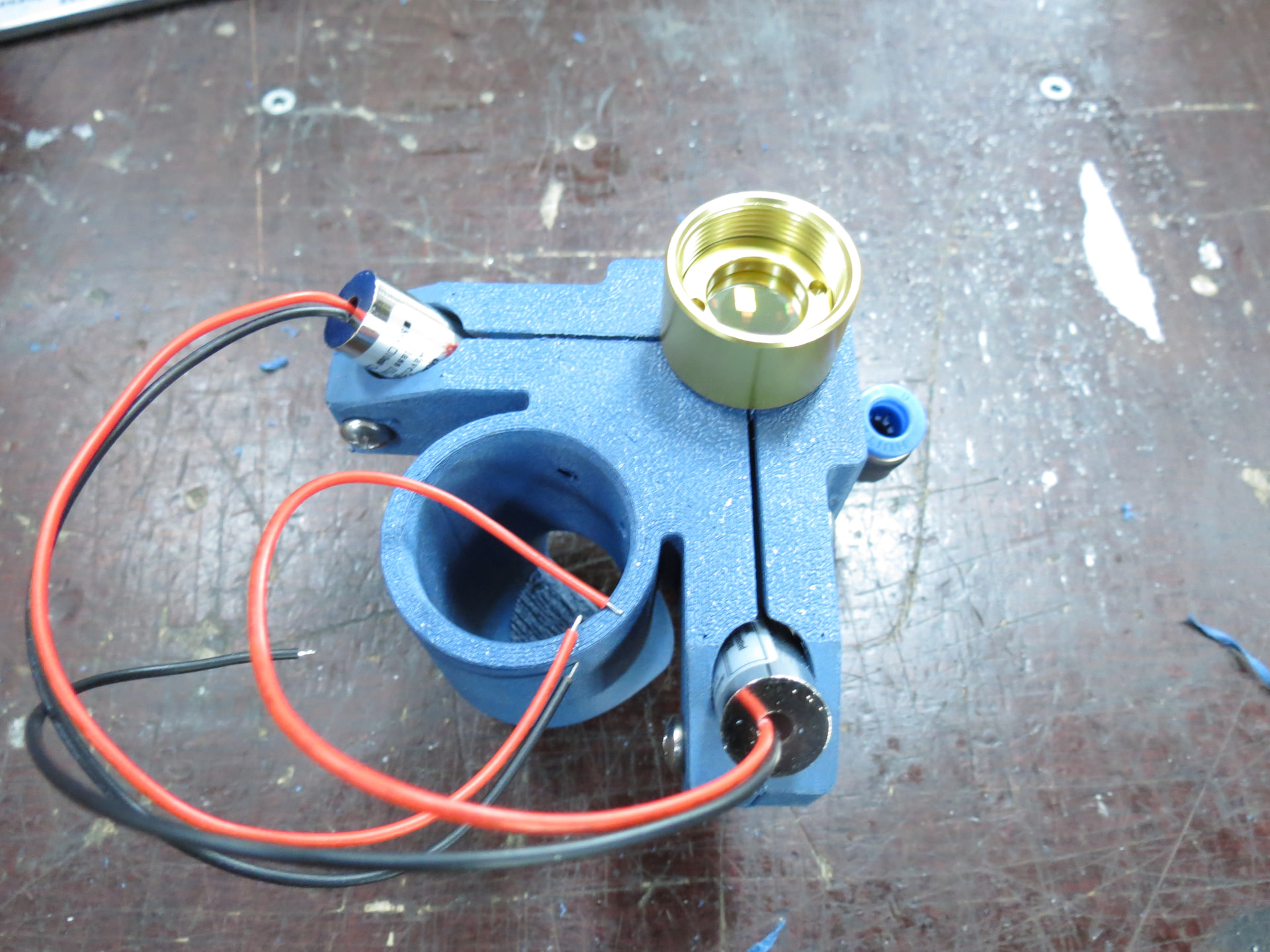

  • the nozzle does not tolerate any torque and is easily turned loose. First, I tightened the upper brass “pipe” which is a part of the carrier, not the nozzle. Then it is necessary to strongly tighten the hand nut.
  • I had to manually modify the bracket as you see to get access for pliers to turn the laser diodes. Next version will have a spring and an adjustment screw. Diode fixation is ok, but unsatisfying.
  • I need to find my exact focus before I can present some real results

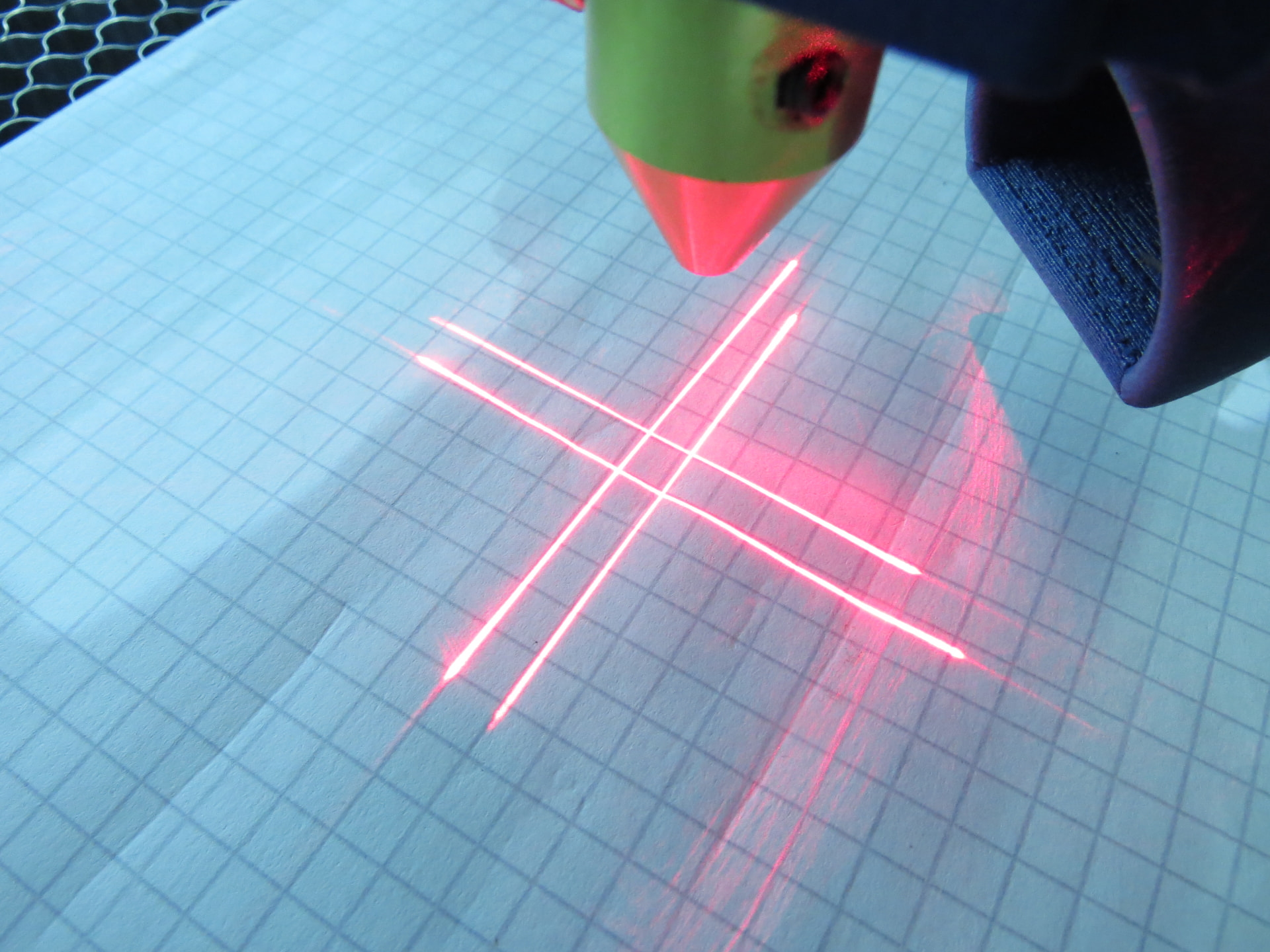

  • the z motor is a bit too fast, or it’s too fast regarding the movement of the two crosses. I had some back and forth before it looked fairly good.
    which means to me: if THIS z speed oughts to be good, the crosses definetely are sufficient for focusing
  • fun fact: two of the crosses always show the laser center, the other two move with z, so there’s not too much crisscrosszigzagging and new centering: the laser is easy to point on a specific coordinate/mark/custom 0-0
  • the laser diodes are focusable, which ist perfect, the lines are rezor sharp. BUT the focus head has so much play it destroys all precision. Need to stabilize that…with glue (permanently…not good) or shrink tube.
  • smoke extraction video will follow (other thread), the 25mm hose sits loosely in a 40mm hose (bc I want to use 80% of the vac power for my vac table down hold, suction seems very high and silent

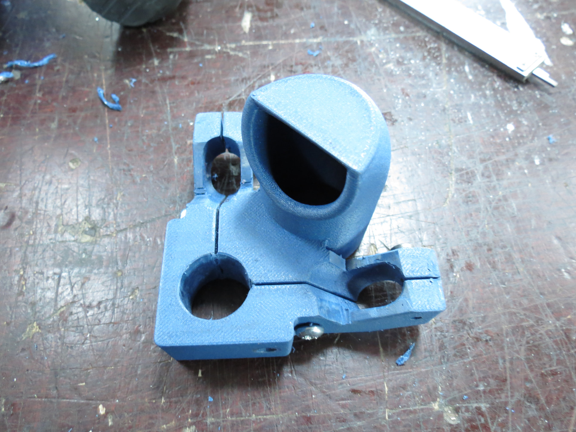

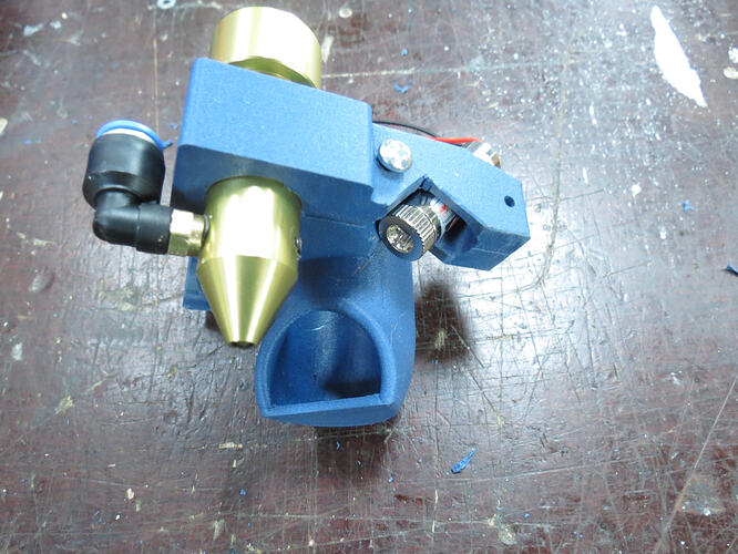

After a couple of hours designing, even more hours for adjusting and assembly, some unforgivable curses and several chocoate bars later I got this now at the second attempt:
a magnetic z indicator :rofl:
OK, a bit more: two cross line lasers and a smoke suction with a shield around it so I can operate with the lid open/gone. More about that later.
I just love the simplicity of this hugely overengineered solution. Snap - I’m there. When overrunning this point it means that the focus point ir more in the material than just on it’s surface. This isn’t about 1/10 of mm.
The laser diodes will help me targeting individual starting points, their aligment when z-moving is secondary now, but it correlates with the snapper.
