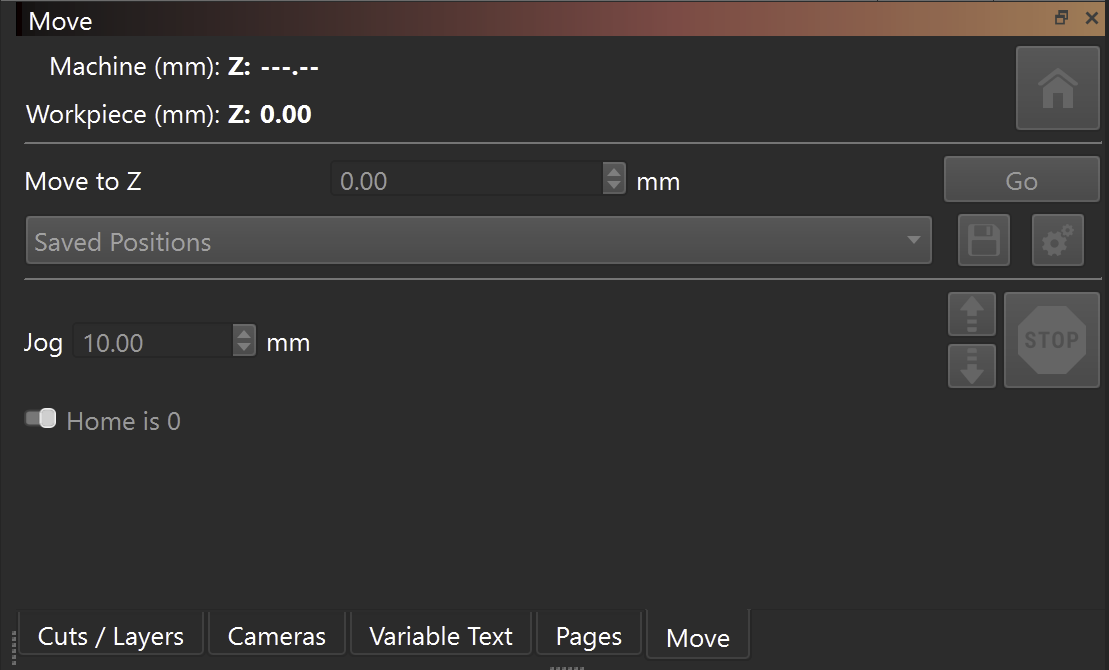

after migrating from EZcad 3 to Lightburn, I can only move on Z axis by millimeters unit only, I can’t get a tenth of a mm. how do I need to setup Lightburn to get the small steps.
thanks for you help

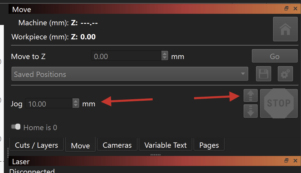

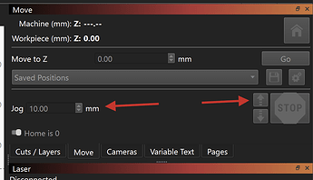

Are you using the new Galvo “Move” window?
I can’t test this without the machine connected, but it should be possible to enter 0.1mm in the “Jog” field here, and using the up and down arrows next to the STOP button to jog.

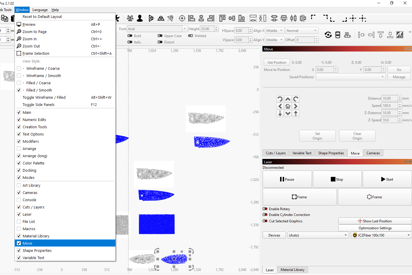

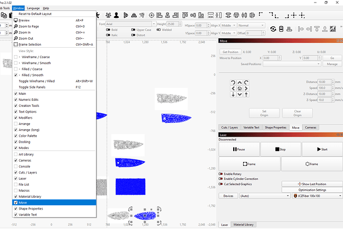

Tried the release candidate 2.2 RC3 but the beahaviour is the same and I’m unsure what the extra field in the bottom does.
And cannot find the Galvo “move” window to experiment with the decimals.

I have never used it, but is this what you are looking for?
