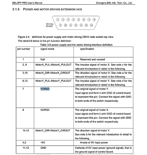

Hello Oz,
okay, I understand the issue, but are you sure there’s no way to send a zero signal to the BSL board?
You’re of course much more familiar with the details than I am, but the BSL boards also have hardware pins for setting zero points.
So there must be some logic to handle that, at least that’s what I assume, based on the presence of those hardware pins.
The BSL card will zero using external limit switch pins, moving the card until it hits a stop, but according to their engineers I can’t just tell the card “where you are right now is zero”, which I can do with JCZ cards.

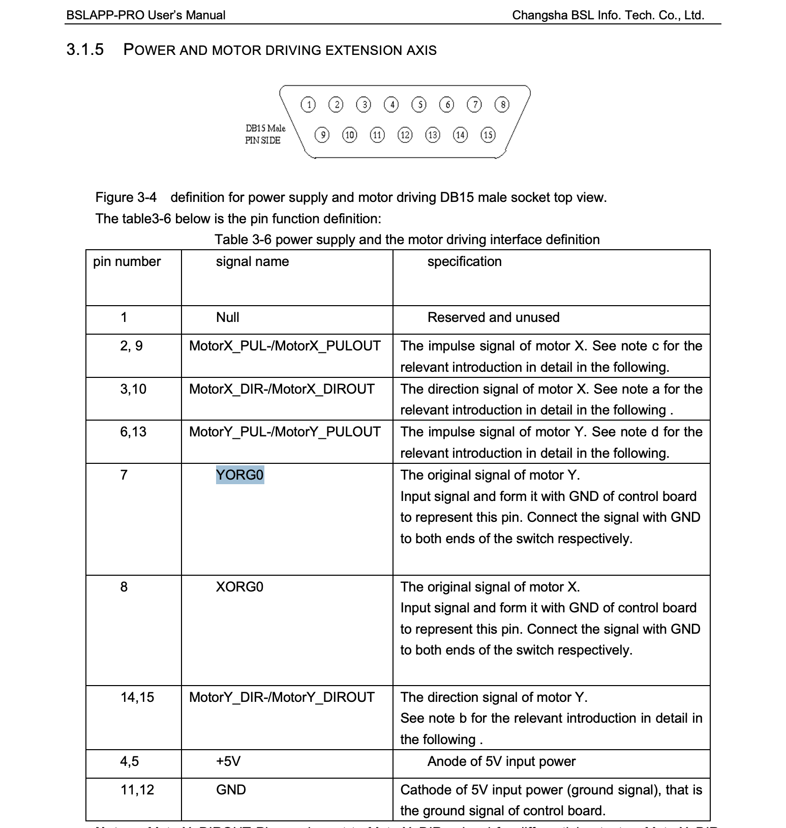

Hello Oz,
I get your point, they probably know better than I do.
I was just wondering because of those pins. I’d assume there’s some kind of command for it, since that’s what those pins are meant for… right?
Pin triggered = Set zero
But in China you never know :ok_hand::grinning_face_with_smiling_eyes:
That’s what I mean though - The pins are to zero the card, so I can send the command to trigger the zeroing function, but I can’t just tell the card it is currently at zero. It has to actually move and bump a limit switch.
