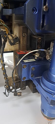

Yep, the z axis moves just the head
Sorry btw Ed, I’m a printer not a CNC guy (yet)
Man, the innards of that machine are grotendous!
You gotta take it apart and clean All The Things with toxic chemicals, particularly the linear bearings. Conversely, the laser head looks suspiciously new, even if the Mirror 3 alignment knobs & screws are strictly junk-box jank.
Those two grubby microswitches should be the Z+ and Z- limit / home switches. Check the controller’s diagnostic display to see which signals, if any, they correspond to: an input bit should change when you trip them by hand.
What is the mystery box with the (disconnected) SMA cable supposed to do? Whatever it was doing, it isn’t any more, which may account for some of the “not moving” problem.
I took the head off already and cleaned it, hence its lovely blue colour.
