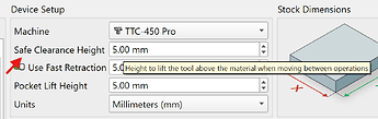

That sounds like the Save Clearance Height.
Can you reduce this value? It should be slightly higher than the workholding clamps to avoid collisions.
On the 4080, you have 60mm of Z-travel.
That adds up: The noise you heard when the Z-Axis hit the endstop is the stepper motor losing steps.
The machine thinks it’s higher up, and collides with the workpiece when it moves down the same distance.
Decreasing the clearance heights should solve the problem, but also consider enabling the hard limits in the firmware: Enter this command in the console and hit Enter $21=1

Thanks for the tips, I followed the suggestion and reduced height to 15 mm from 20 mm and the tool retracted up but stopped as it touched the limit switch and then proceeded to the set “Z” height without crashing.
