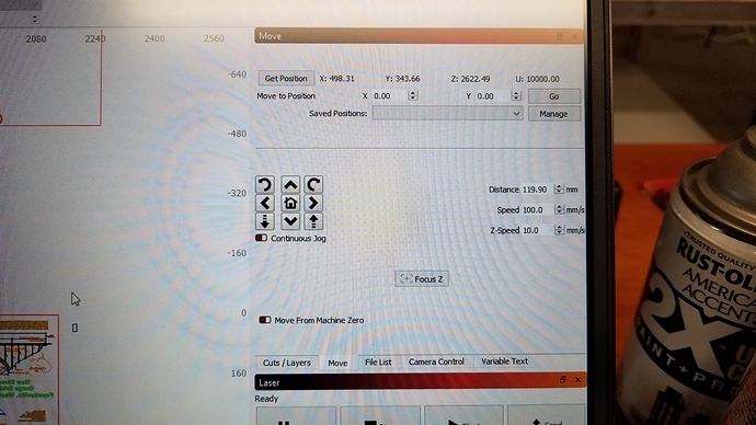

Not sure if this is the correct terminology or not, but this afternoon I was adjusting the bed height from my computer via the Move tab in Lightburn. I had the Distance box set to 2mm, but I noticed when I “jogged” the bed up or down with the arrows, the bed was moving only in fractions of that. (Though the head does appear to move along the Y and X correctly according to the value).
Also, the value shown for the Z position (3000 in the image) increases or decreases by the amount in the box (2mm in this image), but the value for the Z height must NOT actually be in mm.

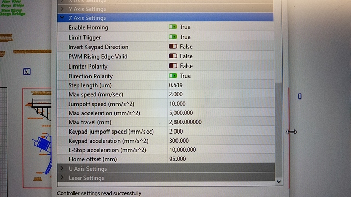

Possibly the settings for your z stepper aren’t correct. LB is issuing the command to move 2mm, but the steps/mm setting isn’t correct, so it moves the number of steps that would be right for 2mm, but because the ratio is off, it doesn’t move the correct amount.

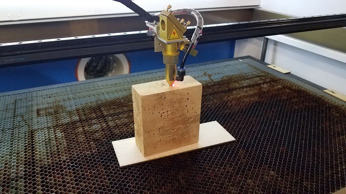

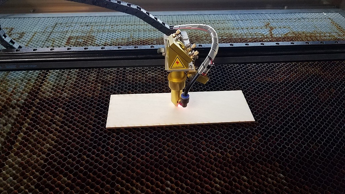

I raised the bed until it contacted the nozzle (with a ply plate in between).

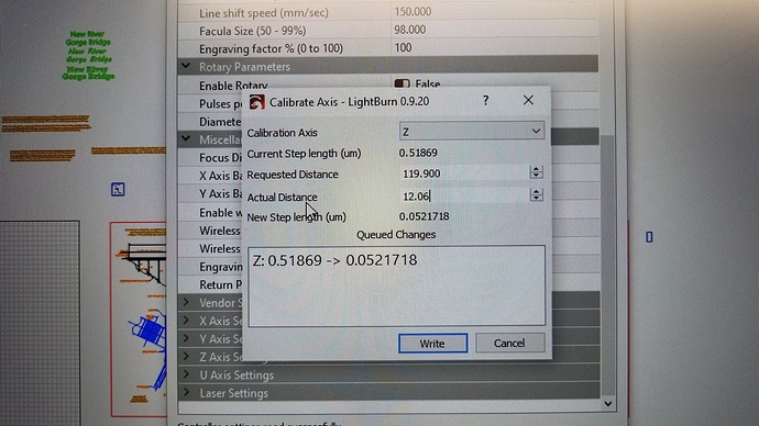

I then measured a wood block and entered the value (119.90mm) into the Distance box. I clicked the down arrow to jog the bed down that distance. With some more wood, plastic and cardstock shims I measured the distance the bed actually traveled. I entered these figures into the Calibrate Axis boxes for the Z in the Machine Settings.
I wrote the settings to the machine and voila! Actually, I had to recalibrate once more to get it perfect.
I also had to decrease the Max speed for the Z also in the Machine Settings, else, the bed skyrockets upward with the newly-calibrated distance.
The result is, now, when I enter a value (such as 2mm) into the Distance box, the bed actually moves that distance.
