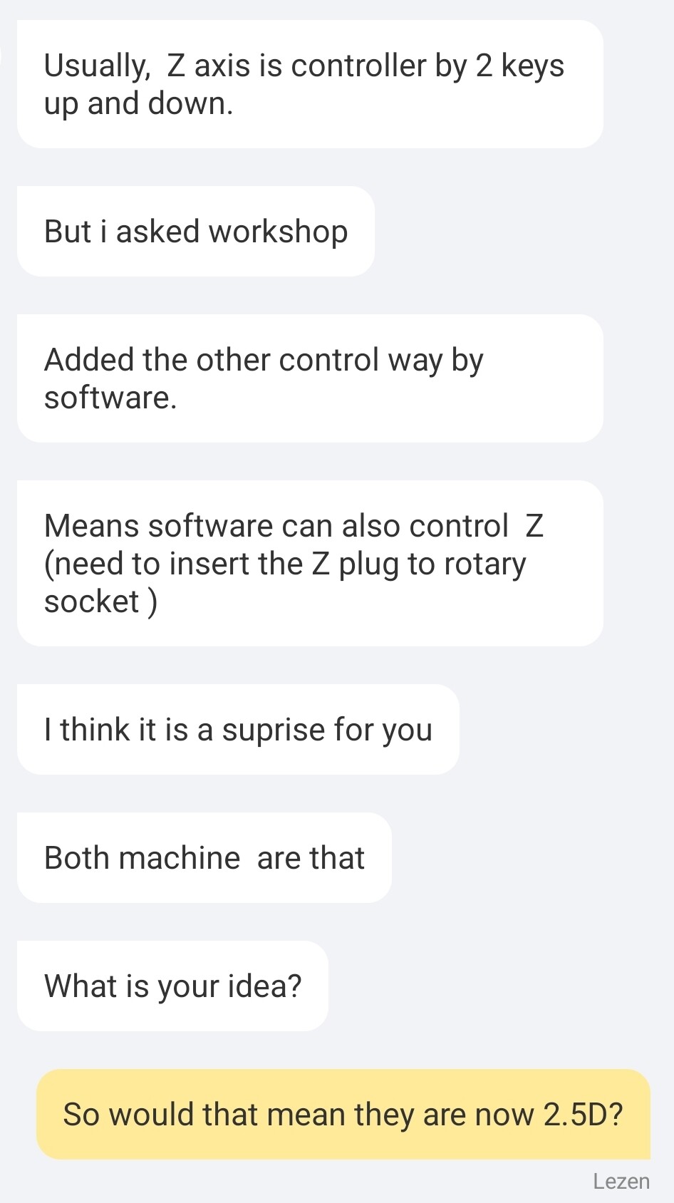

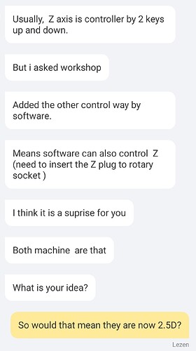

Long story short, the delivery time was delayed because the supplier wanted to wait for a newly designed Z-tower with a speed reduction function to give a higher resolution in combination with the Z-control device.
According to him it is a new invention from their company and they have not settled on a seperate price for it. They actually intended to only incorporate it in their complete machines and didn’t plan for seperate sales. However I asked them to reconsiderate their decision, and they will come back to me on that point.

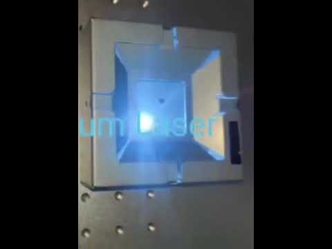

I asked if it was OK if I upload a cropped version of the video which they agreed to. I have also inserted some white ‘noise’ at the end of the video where there company name is engraved.
The quality is not great, but you can see the machine engraving on three seperate hight levels. Inbetween you can hear the Z column raising the head to the right focus.

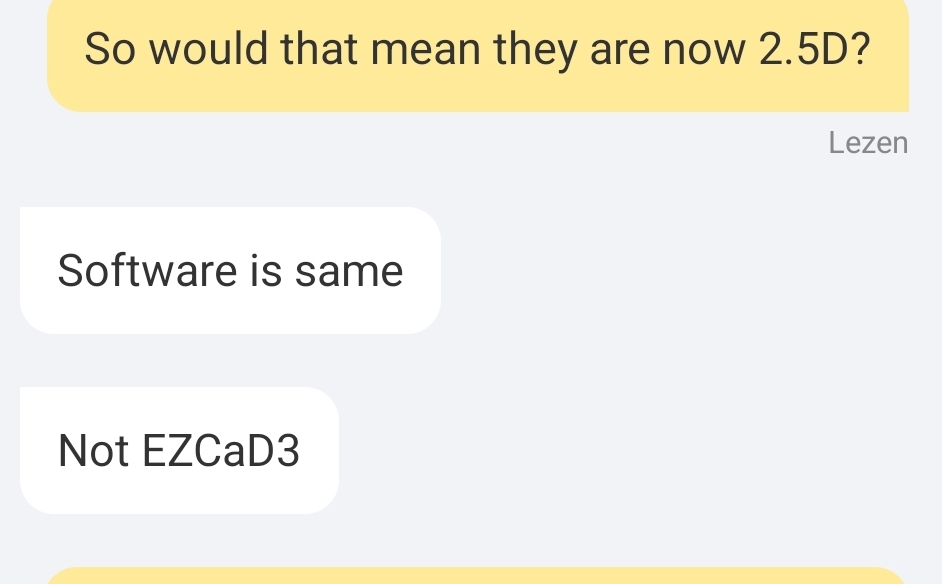

What I think I’m seeing there is different layers engraving at different heights. Not to speak for the LB Dev team, but my bet I dont think the LB software will handle anything like that anytime soon. Also just guessing, they are using their own software and likely
not an ezcad 2 board.

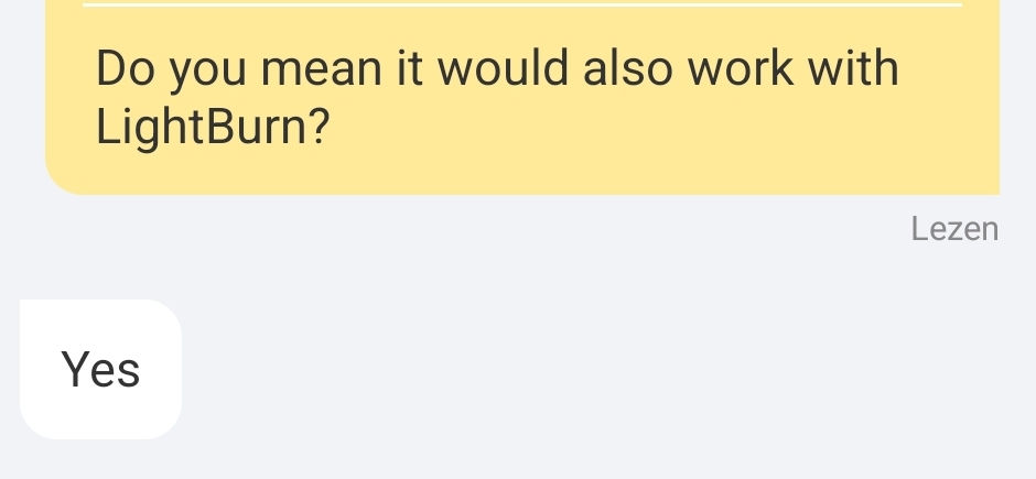

Well, it is implemented on my machine that has EZcad 2 board and they claim it does work with lightburn.
I didn’t even ask if it would work with LightBurn. He mentioned it himself. I specifically asked him multiple times to confirm that.
The machine is custom built to my specs so I am sure it has the EZcad 2 board.

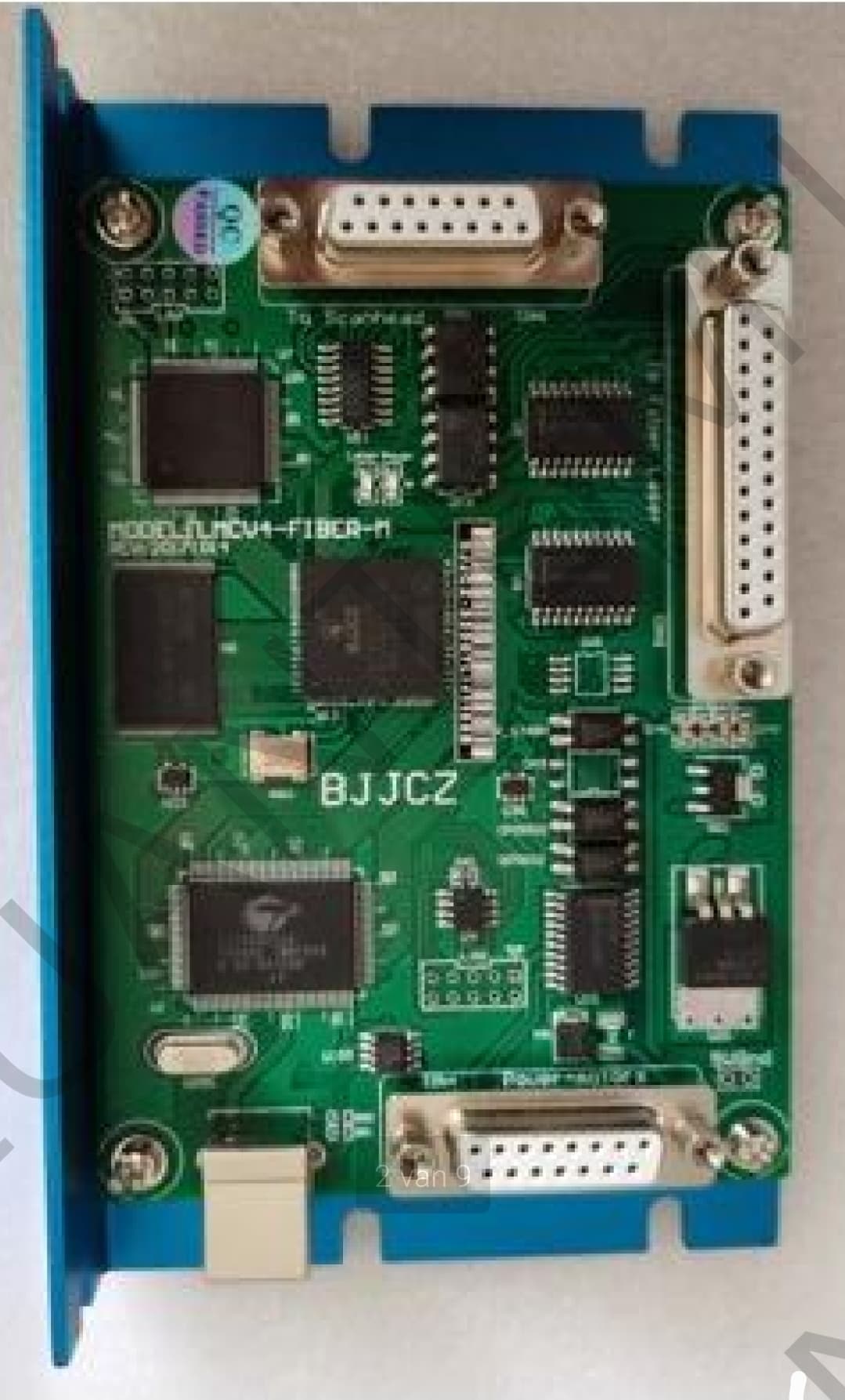

Question, did you spec the ezcad 2 lite board $150-$250.00+/_ (also called Original) or the ezcad 2 standard board $850.00+/_
If you have a picture the lite has 2 DB15 plugs and 1 DB25, the standard has a DB9, 2 DB15’s, a DB 25, and maybe a male 25.
Most of us mere mortals end up with the $250 model.

It says on the invoice ‘original’. I didn’t include the board type in the specs, only that it ahould be EZCad 2 so it would be compatible with LighBurn
Yep, that’s the lite. Nothing at all wrong with it. There are features that LB doesn’t use on the Standard, 2nd axis for one. Dedicated + and - for the axis extensions pul and dir also.
Every thing we need on the original or lite. So if they can do that magic with the lite board, I dont need to upgrade!
How do you tell the difference between boards without a reference?

What kind of new invention could it be that uses the stock board and Lightburn?
In the video, I couldn’t tell much except I could hear it changing heights.

New boards there is a “A” after the bar code on the axis enabled one. Don’t know how on the old style.
