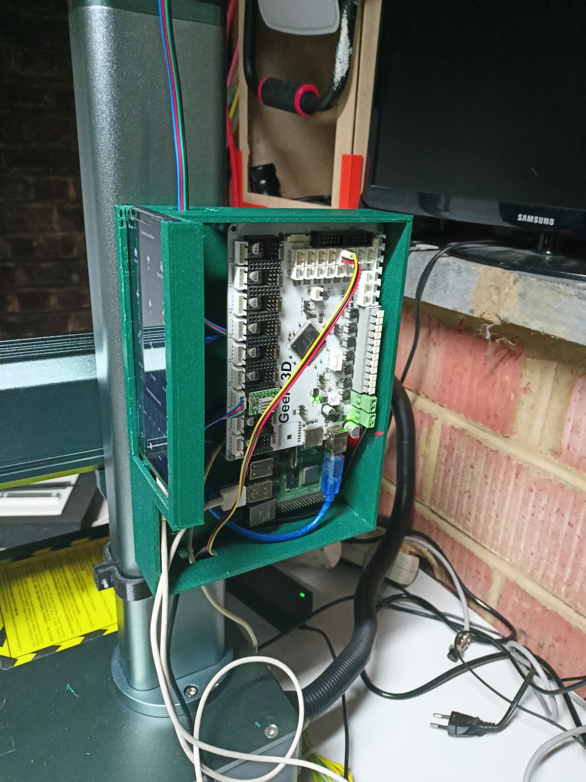

Hi,
Very interesting discussion about controlling z-axis.
I have made a DIY z-axis system based on Klipper, a 3d printer firmware highly customisable. It accept standard g-code and special commands for Klipper.
Klipper, Moonraker, a forked Klipperscreen and I used old smartphone as Raspberry PI touch screen, with xsdl-Xserver Android app(but any Pi screen works).
As is, the system is stand alone. I use a BLtouch for automatic focusing on any surface.
But if Lightburn could handle two connexion to a controller, one to galvo controller, and another to Klipper, the system is ready to receive move commands on Z axis(and for a X/Y gantry of course).
The project is open source, if interested I can explain more in dedicated subject.
Some other features
Temperature monitoring for room and laser source(ntc 100k for 3d printer hotend) with graphical histogram.
Output switching with touch screen (air assist, ring light, fume extractor, whatever you want) and gcode
User Memory.
Memory menu for defocusing
Video:
