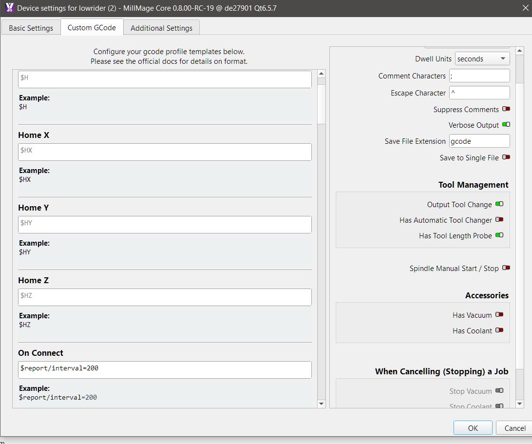

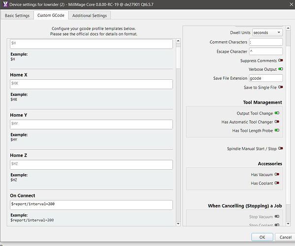

In the posts above you will find the Console capture first for when it was acting strange, the second one is of the newest RC where it acted as it should.

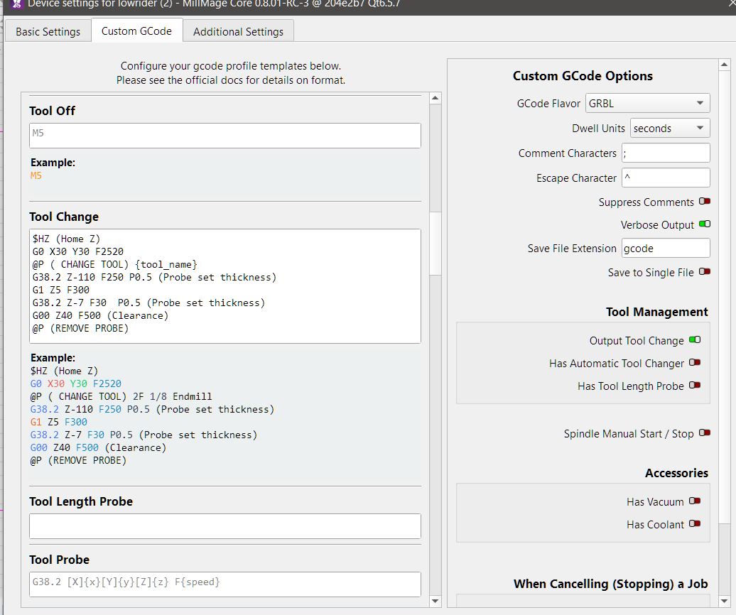

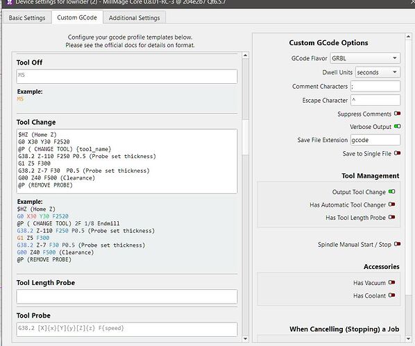

this is what i have been running in custom g codes since RC2

Yeah, the end of job script for the other profile definitely has Z moves and a “return to zero”. I’m guessing whoever set up that profile included those.
I did see these in the console however I am afraid I didn’t know how to get to them to make the changes.

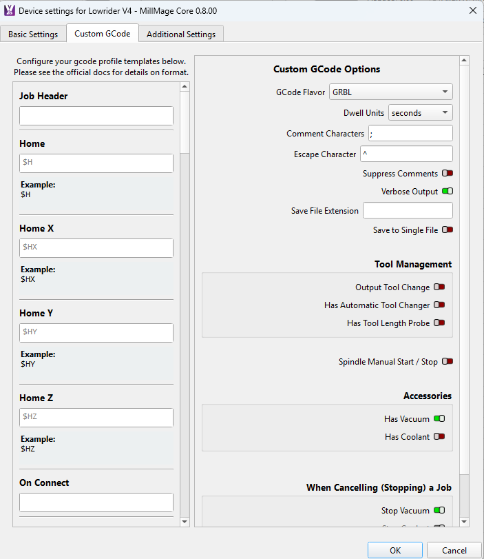

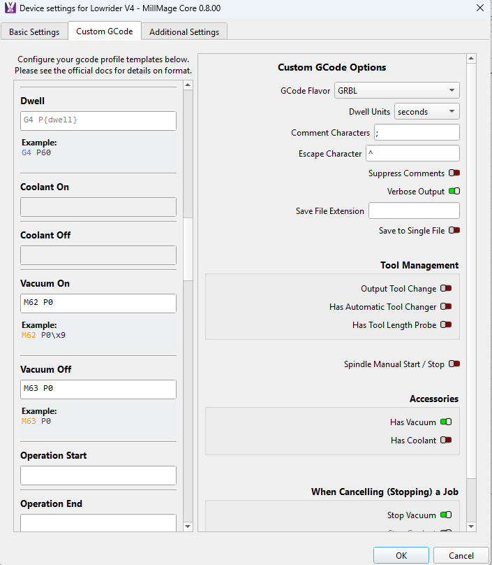

I added these lines in the custom ‘Job End’ area of my Lowrider profile, which was used for the default Lowrider profile.
You can safely delete those lines if you want.
I reinstalled the Lowrider V3 profile and deleted those entries, all is well.

Here are my custom G codes, not a lot to see. I am going to steal you tool change code if you don’t mind. I have never take the time to set that up. The issue was some code put into the V3 profile that is available in MillMage, once I deleted that and did a generic GRBL machine everything went back to working as it should.
