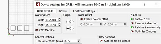

With the Z-Axis enabled, Relative Z moves only enabled, and ‘Optimize Z moves’ off, the head of the engraver should move up for travel moves. I drew three squares as a test.
The material height can be set in the Cut Settings Editor:
After doing this I saved the GCode and watched the Z-Axis commands and they are given before and after each engrave command.

Neat!
thats a clever way to do it! and i guess could still work with virtual arrays?
Tested
 it would indeed.

I haven’t tested the grouping behavior but I believe that any non-engraving move will lift the laser before moving. This might be annoying and slow if you have lots of small separate features that you’re engraving.
If you set it up, the way you think it should work, you can test with cardboard circles, or you can click File, Save GCode and save the file somewhere convenient.
If you share the GCode file with me, I have a GCode viewer attached to Notepad++ and I’ll be able to see the vertical hops.
You are also welcome to download Notepad++ and install the NCnetic plug in. They’re open source and they work great for checking expectations and outputs.
