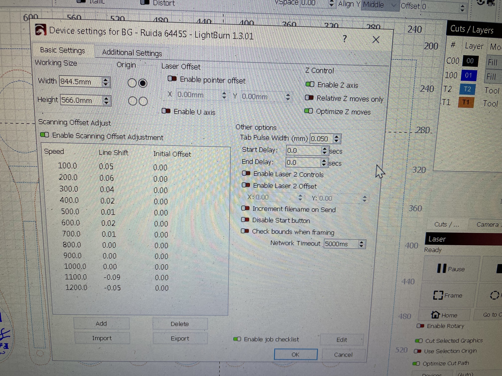

Hello everyone. I have a question about the z axis movement related to the “layer” or “color” and the behavior related to running a job or more specifically, when the job finishes.
Let’s say I am working on a job that I set the z axis @ 3 different levels, 5mm, 10mm, 15mm to account for curvatures of the material. Before the job the z axis was zeroed out, then I manual move the z axis to 20mm offset. Then the job proceeds and moves from 10mm to 5mm to 15mm and everything moves as expected.
The issue is, when the job finishes, the z axis automatically zero’s itself out. It doesn’t return to the 20mm height that I manually set the machine to. This is a big problem if the material is thicker than the zeroed height and the nozzle digs into the project or surrounding jig.
So the question is how to I prevent it this final z adjustment or move it off of the project before it does this? Is there a setting I overlooked?
Thanks for the help in advance.
Hi Keith - have you tried enabling/disabling Relative Z Moves from ‘Edit > Device Settings’? This may be what you’re after.
Thanks for the reply Colin. Unfortunately, that is the setting I tried after the first “incident”, this is what my current settings are.
