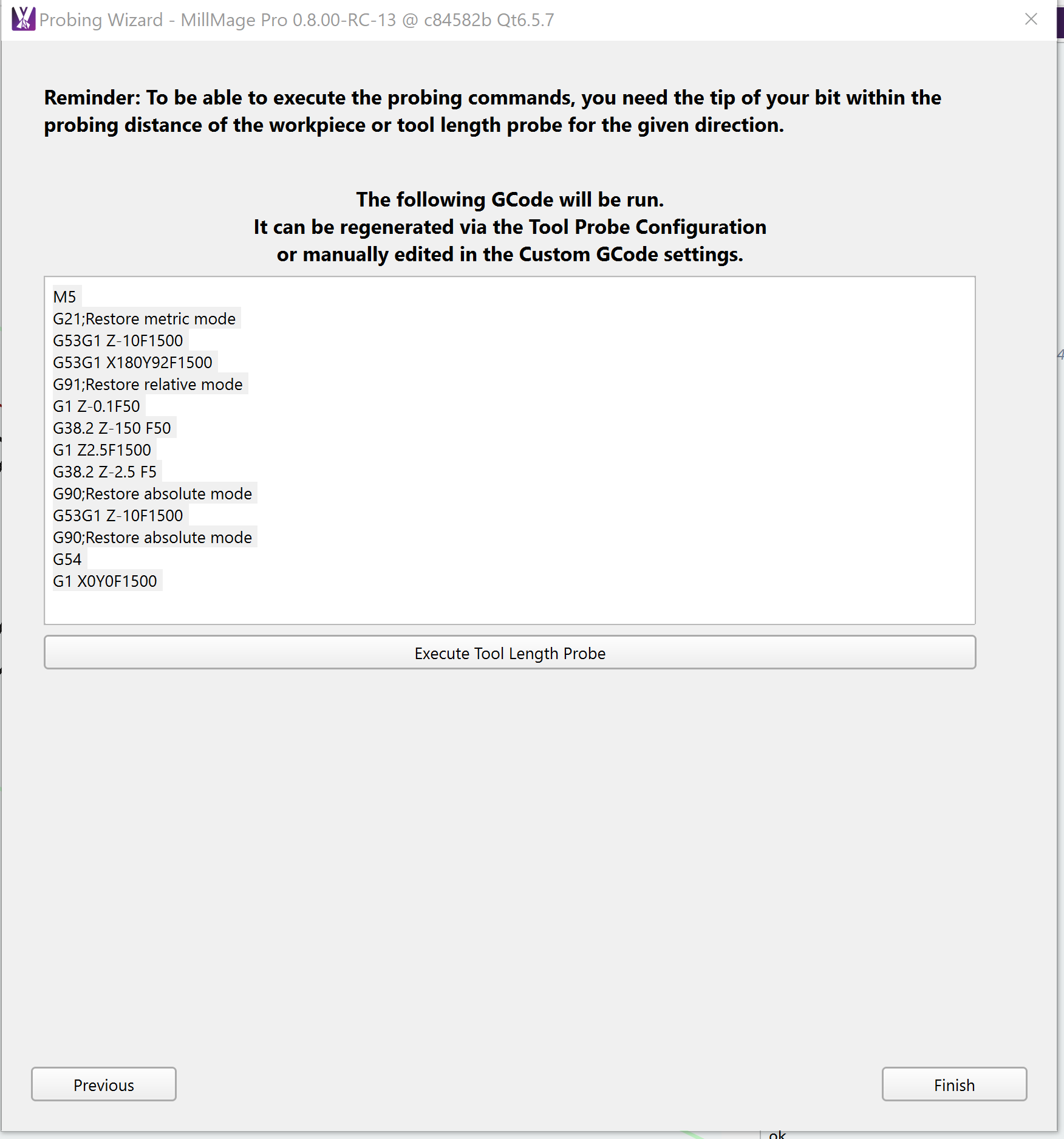

I ran the Z-Probe but it did not stop. My probe has a green/red light that works. The light was green, I ran the software, the bit touched and light turned red but the bit broke because the software did not stop Z travel. I ran it again and broke a second bit. I tested the probe by hand, having lifted the probe to the bit, but it never stopped. Is this software or hardware failure?
Here is my GCode.

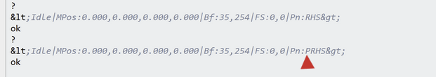

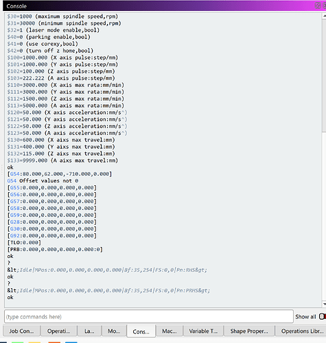

Let’s do this test, please:
Enter this command in the Console Window to query the controller’s status, including the limit switch and probe
Hold down the probe so that the light turns red.
Enter the same command again.
Send us a screenshot of both replies.
Can you confirm that the magnet is attached to the tool or the spindle collet nut - not the spindle housing itself? Often ceramic bearings in the spindle do not permit the circuit to close, or if it does, the signal is weak. Connecting the magnet as close as possible to the tool being probed is important.
You can see the ?’s at the bottom of the screen shot. The first was NOT touching. The second WAS touching. The only code I saw in your message was a ?. Was that correct?
I have an alligator clip, not magnet. So, I get great contact. It is connected to the bit.
The connectors only fit together one way. It is the Z probe that my CNC manufacturer makes/sells. The probe was working weeks ago.
Based on what appears in your screen shot, the controller board is not detecting the contact closure of the probe.
  1. Broken wire
  2. Bad controller board input
  3. The probe is switching, but there is no signal change sent to the controller.
@MikeyH What would I expect to see in the code to show completed loop?
I do not know the exact text, but those 2 lines should not be the same. @Aaron.F can probably tell what the actual text should have been.

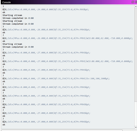

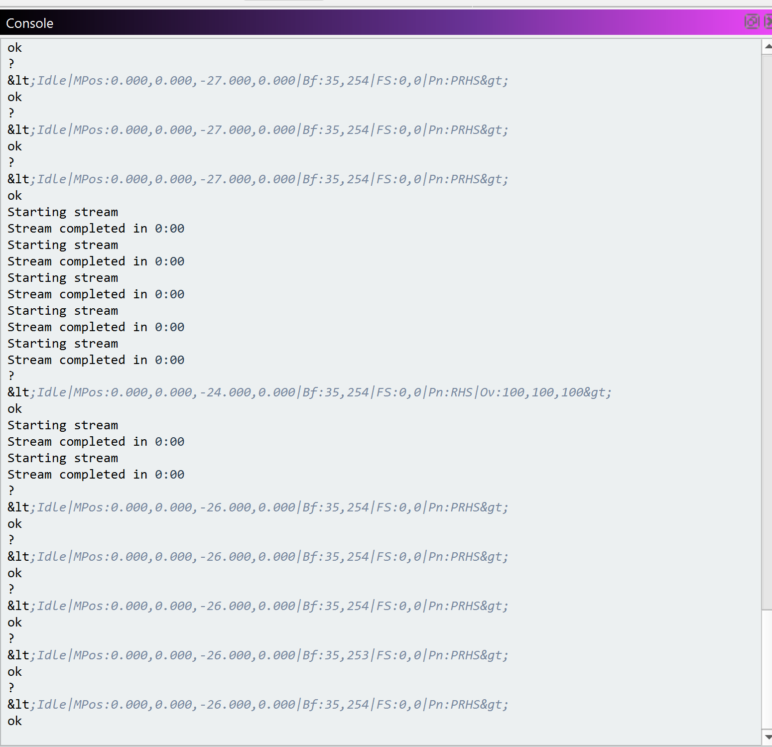

Test 1:
Test 2:
Did some diagnostics to see if I could tell what was going on. Found a loose connector. My CNC manufacturer uses JST-XH Connectors. Absolutely the worst connector for this use. I was removing the probe when not in use. I see why they make a wireless probe or a mount to store the probe and keep the wire connected. I’ve ordered the XYZ probe and will use better wire, keep it connected to the board, and build a storage cup.

They are not the same in his previous screenshot :slight_smile:
It’s looking good. This P in the second line is the active probe

To my understanding, the firmware is supposed to handle the stop on probe contact with the G38.2 command from the probing sequence.

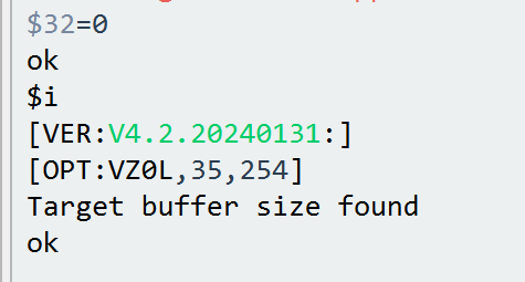

Which exact firmware and version are you running?
(Enter this command in the console and send us a screenshot of the reply, please $i)
I got confirmation that the G38.2 command is handled on firmware.
I find it odd that the Z-axis moved at all, but your controller might be using a different command for probing.

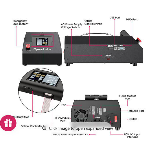

Can you give us specifics about the make and model of machine you’re working with? How is the probe connected? What is the controller it is connected to?
@Colin sorry about delay, had to find some time. I noticed $32 was =1. That sets my machine in laser mode, not router mode ($32=0).
I have a NymoLabs NBS 6040. I have router (air cooled and water cooled) and 10W laser. I use LightBurn and MillMage. Thank you for making these programs.
My probe is wired. The manufacturer uses JST connector types.
This the the master controller that Nymolabs uses. However, there is an accessory board that it plugs into.
Is that the information you need?
