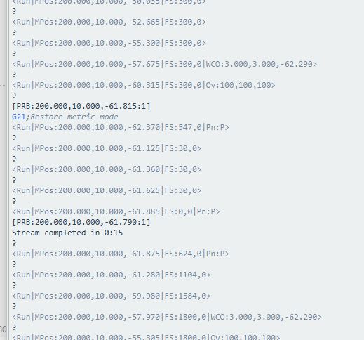

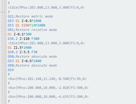

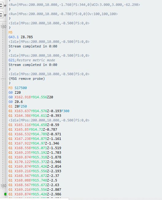

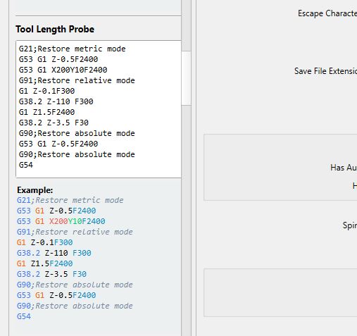

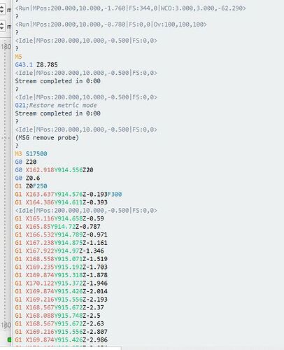

after probing it cuts air , doesn’t do it every job , just randomly on jobs
final version.mage (132.6 KB)
have to close MM and restart for evey tool
