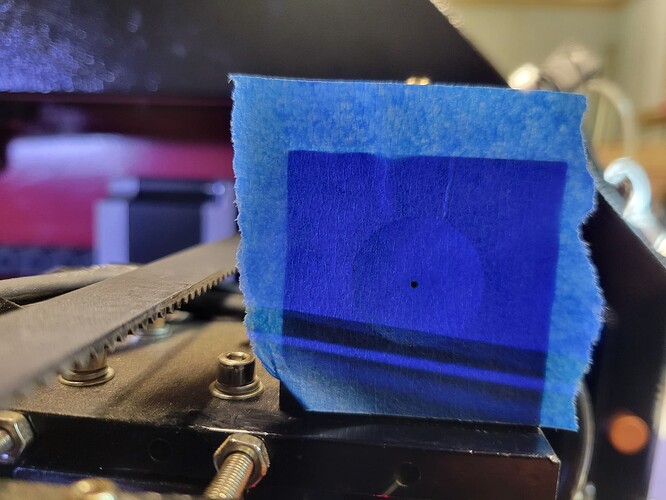

Sorry again, here’s photo. Again, I have zero up adjustment available. Screw is backed out completely.
Your mirror looks like this from the beam view…
Put this ellipse that’s 20mm tall and 14mm wide over over your burn and see how close you are…
It’s only 14mm wide… keep that in mind along with the fact that you are not seeing the whole beam on the target. If your beam is 6mm, then 14 - 6 is 7… divide that by 2 and it leaves you only about 3mm, so you have 3mm on each side of the beam for error in alignment.
If you are burning a hole through the target you’ve lost that visual location and are not helping yourself see the center of the beam or it’s power distribution. I suggest you back off the power/time to create only a slightly brown spot.
I have mine set very low, pulse time wise, if I need to, I use multiple pulses…
:slight_smile: actually, 14-6=8.:

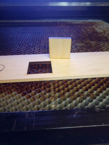

I dialed down the power. Attached is M2 to M3. Pulses taken in back left and front right. I also verified the opposite corners and I’m right on. I think I’m now good, I was finally able to cut through the 1/4 inch. I used a speed of 6mm/sec, power at 35%. I had to push the cutout, so maybe speed of 37 or 38.

I did it again! Here’s the photos
… If it’s the same material then it’s a great development !! - Congratulations.
Your spot also looks nice.

Sorry, that’s why I usually use a calculator :crazy_face: As long as you get the drift…
The spot looks much better and very good…
We are all glad you’ve got a working machine…

Now that this situation is resolved, I need to mention what I had to do regarding the mirrors. Both 1 and 2 did not have the ability to adjust the beam up, pretty close to the same for the left adjustment. On M2 to M3, I had to turn the diagonal to the top left of the M3 mirror opening then I could adjust down and to the right. Pretty much the same for M1 to M2 but not as much.
