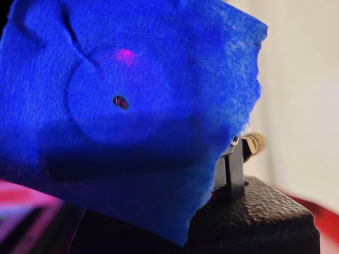

At any rate, Iā€™m attaching 2 photos. First is my M1 to M2 pulse. While they are not dead center, they are on top of each other. Iā€™m stii working om M2 to M3. In back left corner
Iā€™m a little low, in top right Iā€™m a little high both near the center and about 1mm apart. I want to work on this more but a little frustrated that I make minute up down changes and I end both a little higher or a little lower.
The second photo is a pulse shot of the laser head without the nozzle. Again, off a bit but not hitting the inside when I put the nozzle back on. The image to the right is a 40mm square that I attempted to cut into 1/4" baltic birch. Speed is 6mm/sec, power at 50%; it didnā€™t cut through. Note the width of the cut line.
What do you suggest?

Rather hard to interpret, but I think heā€™s trying to say where they coincide isnā€™t needed to be in the middle.
You donā€™t know the beam sizeā€¦ so what is close? If you examine your marks, they have brown/black rings around them. This is part of the beam. If it burnt the target and passed through there would very a very small amount of area burnt.
I guess you need to figure out what close is. The more centered the more accurate the beam path.
The operation is too allow the beam to strike the same place throughout mirrors travel. This ensures the beam is parallel to the Y bearing surface.
Once it leaves m1, itā€™s fixed, as far as there isnā€™t much you can do. The maximum amount of adjustment on m1 wonā€™t gain you much when the two mirrors are the closest.
What Iā€™m trying to say so poorly, is that once these are correct thatā€™s it, you have to work with what you have. Since it did work, it still should work.
Russ covers this at about 16:30 into the videoā€¦ If you mean you donā€™t have those adjustments, I understand. However the technique is correct and you will have to work with what you haveā€¦ As I said, it did work and should still be able to get good operation without any massive changes.
Once m1 and m2 are aligned you have to do the best you can with m3ā€¦ The perfect spot may not be at the center.

Your first picture has the potential for some extra improvements :wink: .
Picture 2, the shot without nozzle, - this fire spot is half as big as on your square. If you have the standard nozzle, with the lens in the small reset and you remove it, then your test shot result may not be smaller, it is not logical. The spot is less as in picture 1 and only half from your square - with lens(?)
What are your settings for your test shots?
I would like to see some pictures with different power settings of your M1, from ā€œalmost nothingā€ to a clear fire spot.
I would also like to see a picture with the result of a ramp test and a square 100x100 mm on cardboard or paper with 200mm/s and 17% power (engraved with proper focus).

Thanks Bernd. I agree that the mirrors need further tweaking. Pulse power for M1 to M2 was 10%. However the far position took several pulses to make a mark. It was getting late and I may have pushed the pulse button a little longer than needed. Yesterday when I did M2 to M3, in the far right, both near and far, 2-3 pulses did nothing so I bumped up to 12%. Concerning M2 to M3, I spent hours getting the pulses to line up. Near is a bit high, far is a bit low, les that a mm apart. I make a very, very slight adjustment up and both move up, same with down adjustments

Since you have the Ruida, there might be a way to set the timing for the pulse in ms. Itā€™s in the configuration on the controller. That helped me a great deal in knowing that the firing was consistent and not relying on how long I held the Pulse button. Once Iā€™d done the ramp test, I fine tuned the focal point by checking the dot size after setting the pulse duration, then reperformed the ramp test not by burning a line, but by moving incrementaly on the sloped substrate until I was able to determine the most finite point. (Iā€™ll post a picture shortly to give you an idea of how itā€™s done)
EDIT: I set my bed height starting at 12.67mm from nozzle, fired a 10ms pulse, moved the Y axis a few mmā€™s, raised the bed by 0.45mm and fired a 10ms pulse, repeat and rinseā€¦ You can see how the dot got smaller then larger as I passed through the optimal focal point. Hope this helps explain my pseudo-ramp test after I got close with the normal inclined ramp test.
I change mine to this configuration while doing multiple pulsingā€™s and change it back for normal usage. Check your documentation for your model.

Iā€™m doing 12 as well. A new day! See latest M1 to M2, after tightening locknuts. I canā€™t get dead center but, near and far, the same spot. On to the next one.
