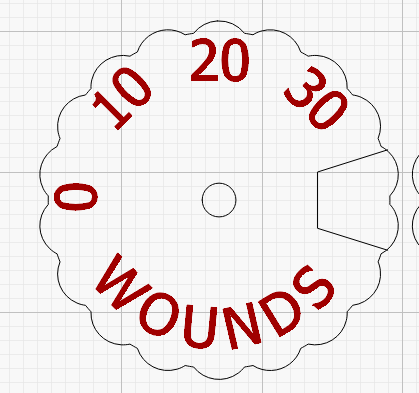

Since 1.5 all my texts on previously saved files are misaligned / not centered / moved / messed.
The very same file with 1.4.5 and 1.5.01
Notice the word “wounds” is not centered.
Any idea?

The following is worth reviewing.
The bend text function is broken when you also use horizontal spacing, the bend no longer takes the spacing into account so you are left with a long tail on the text see Image, the text at the top has no horizontal spacing the text at the bottom has 10 points of horizontal spacing ( the problem is it is anchoring the start of the text, you can rotate it to get it positioned right but its making an easy job so much more difficult.)
[Screenshot 2024-02-09 111617]
A report has been generated and further investigation is underway. I will add this for additional context. Thank you.
Update: We’ve have a fix for the issue with text not using the proper alignment when HSpace is non-zero. Fix will be in 1.6, at a minimum.

Then I will be stuck on 1.4.5 until a proper fix is done… It is happening me a lot, and I didn’t notice many times until the burn is done
Having to wait so long for a fix they already have is bad, in the meantime while we wait… you can use text to path instead of bending the text, draw the path with a tool layer then add the text to it.

If willing, we have a patch release coming you can access, currently in our beta folder.
Bugfix: HSpace wasn’t being included in new font advance code
