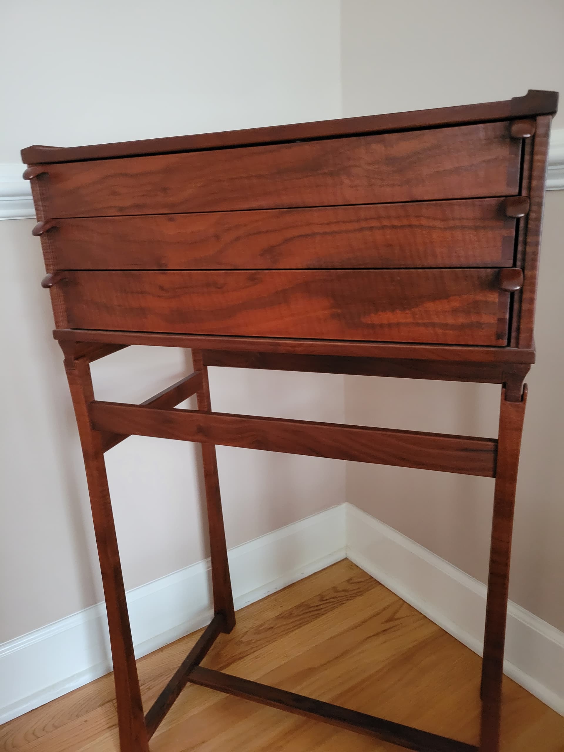

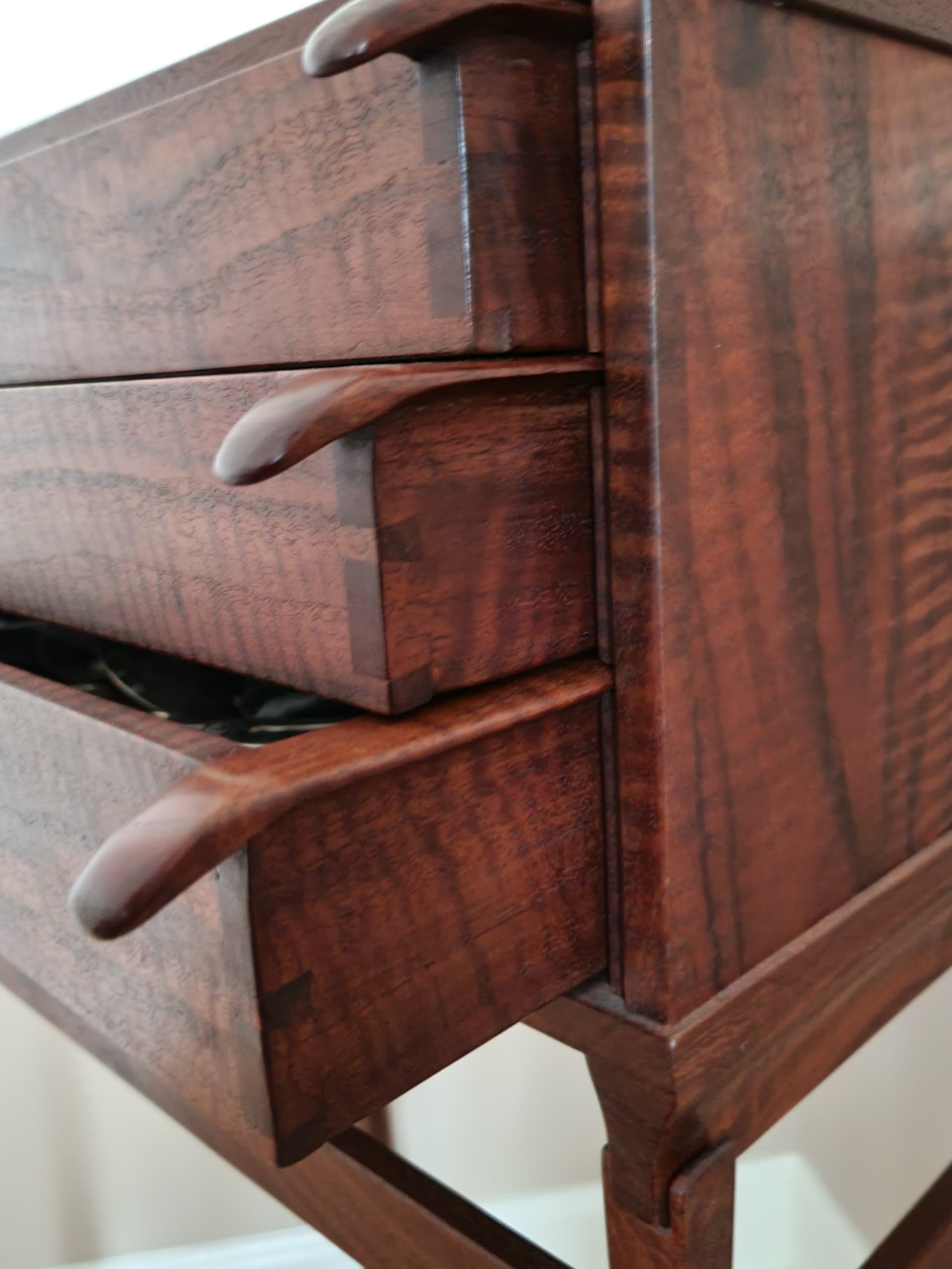

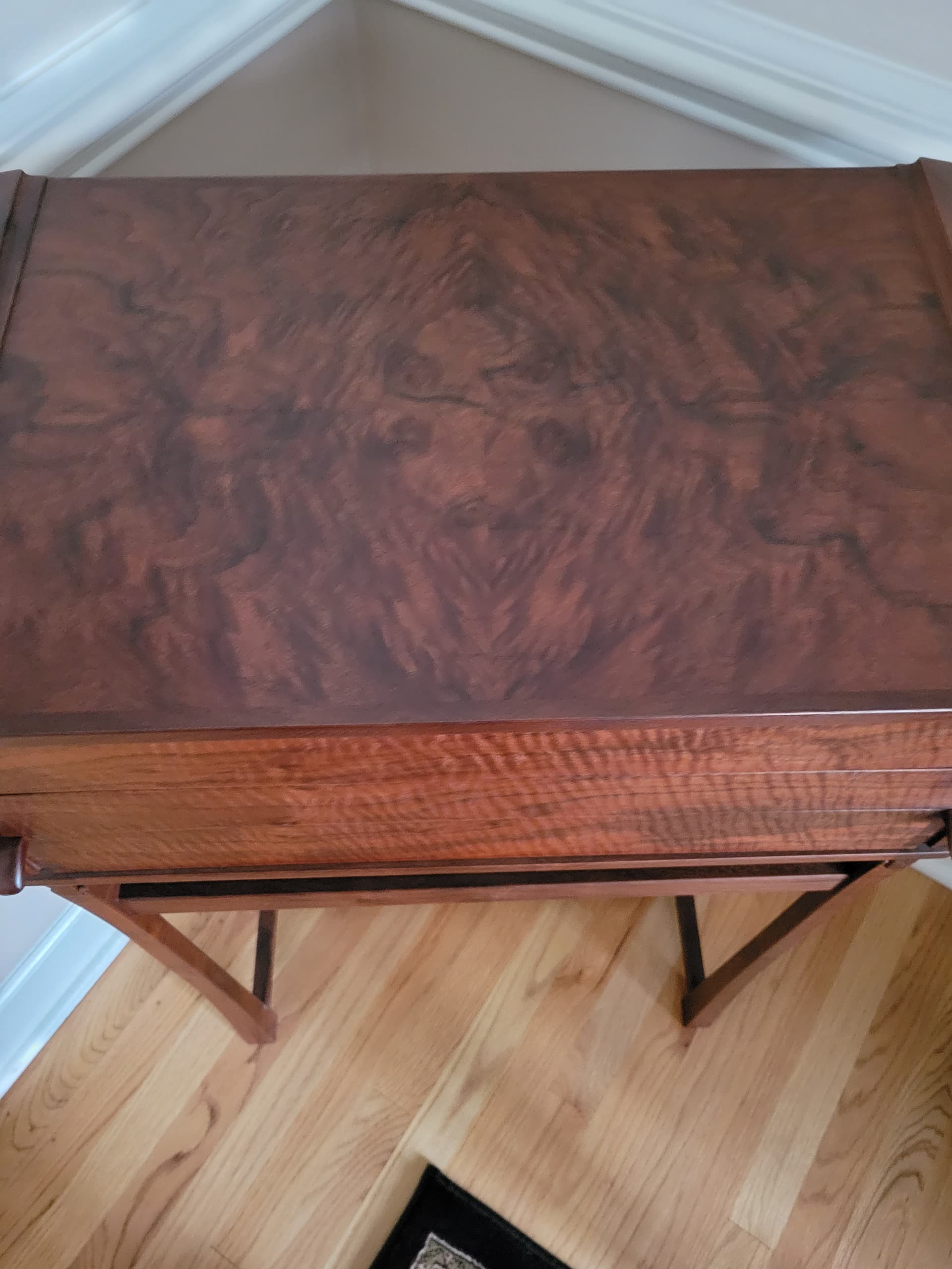

Thanks Jack. I’ll live and learn, like furniture building
