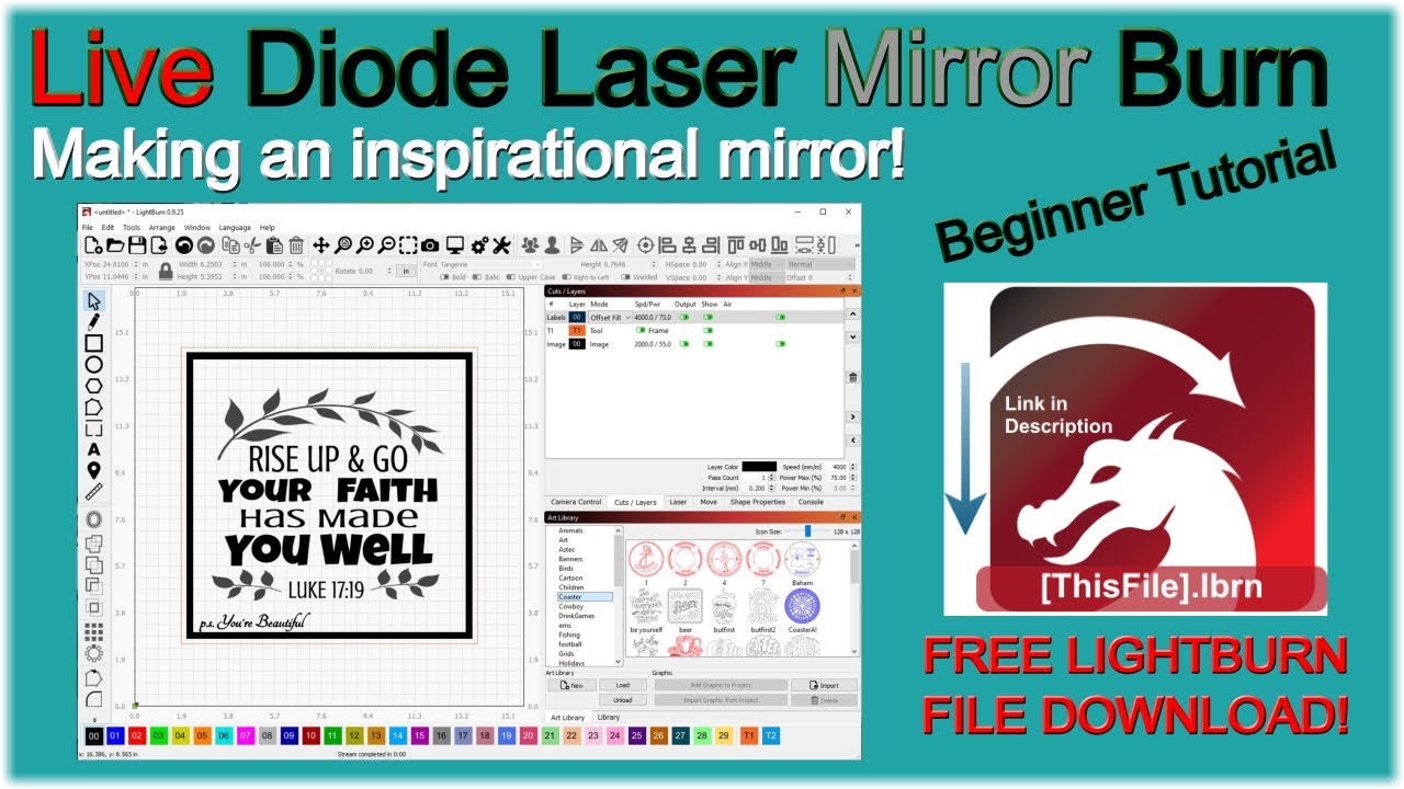

Here is an engraving that I picked up in a woodworking show a long time ago. It’s 60mm high. If someone had the image it would be interesting to see how well the pattern could be cut.
Don’t know about detail, but try this one
This is it, reversed and done on the back of a 12" square mirror, then black paint.

What type of laser is used for this?
You can use either Diode or CO2 lasers.
Here are a couple of videos
Engraving on the back of the mirror allows light to pass through or you can paint it a different color.
