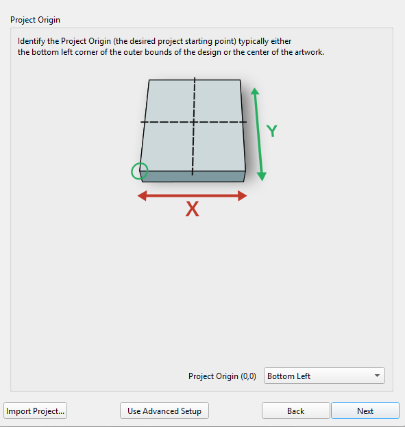

If you start a project in MillMage, there is the project setup like this:
In those steps, you set the origin of your project. Once you designed your project, you need to move the position you indicated in that wizard (in this case, front-left-top corner of the workpiece. All movements that MillMage calculates are based on that starting point. So home your machine like usual. Position the workpiece. Move the head / bit to the origin position manually. Reset the coordinates to 0,0,0. Then press start.

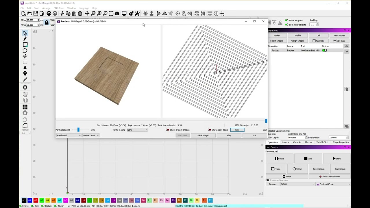

There is a Home botton under the Job Control Tab. But so far it is only moving the Z axis.
It does not seem to mover the X or Y axis.
I just tested my 3018 and it Homes all 3 movements.
The Zaxis must complete the Home cycle before X and Y will move. Are you getting an error message in the Console window?
