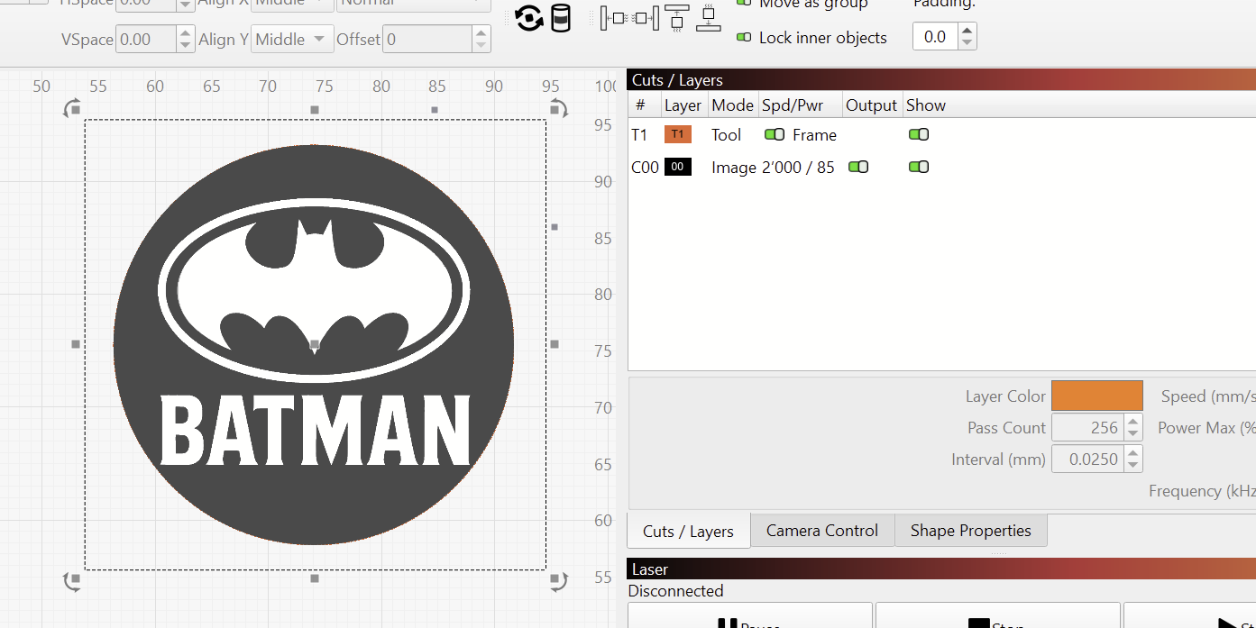

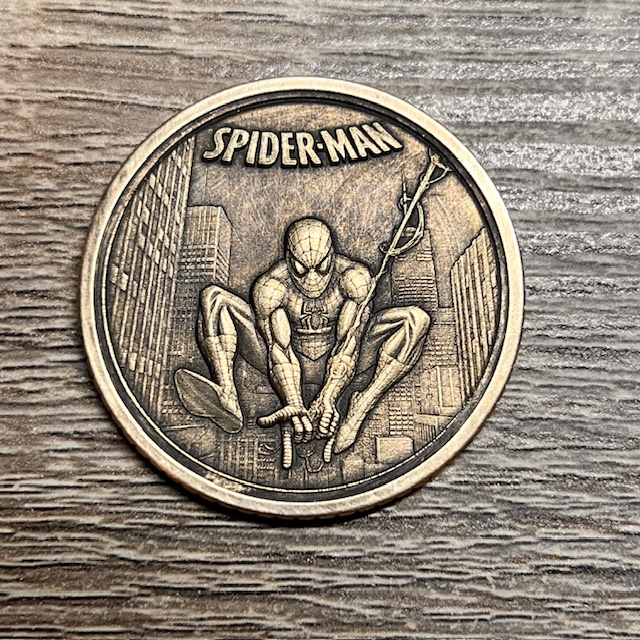

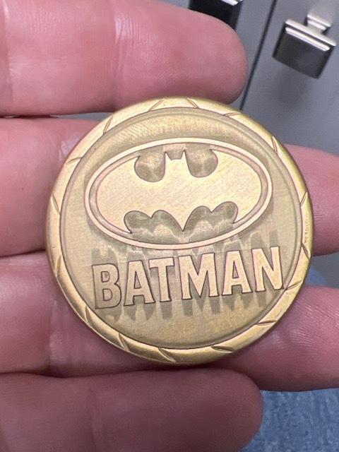

I searched for answers prior to posting gut didn’t have much luck. I’m attaching two photos - one (Batman) showing the issue I’m having and the other (Spiderman) showing that 3D slicing works fine with a different file. (I DO NOT believe the issue is related to the file as it’s basically only dark gray and white - 2 colors - in the Depthmap for the Batman so it’s not really 3D relief style but what causes this?)
The issue should be obvious from the photo of the Batman logo - the shadowing on top and bottom of the letters and logo.
Laser: Gweike 50W
Settings: 3D Slice, Speed 2200, 80% power, 256 passes, clean every 10, 0.03 line spacing
I’ve tried several things but haven’t figured out the cause.

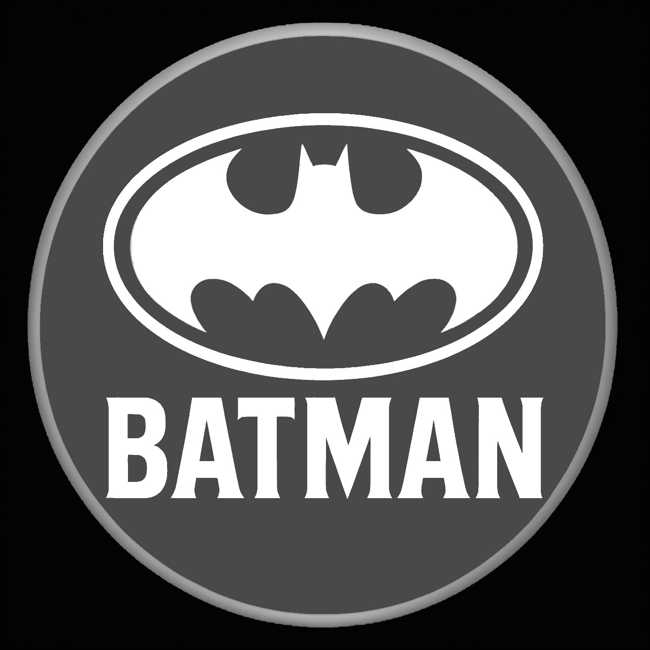

When you do 3dslice, it needs to be a depth map, not a visual representation of 3d.
It would be nice if you could possibly supply the original images?
Thanks Jack. Yes, I am familiar with depth maps and have made several from scratch as well as used various apps to make them as well. This one is very simple, just two shades of gray as you can see. I don’t see how the file could be an issue but here you go - thanks for jumping in to help.
Looks like jpeg artifacting; try using png from start to finish, which uses lossless compression. What does the preview look like?
It is a PNG, but I can’t say for sure it was never a JPG so I can recreate it to exclude the file being the issue. Thanks for the response and suggestion.

Sometimes you can get a Moiré pattern created by interval and original dpi. I’ve seen it and corrected it, and made it worse by small changes in interval. I’ve seen this a lot and it’s similar to your issue.
Not knowing what lens or interval you’re using, I can only speculate.
It may seem odd it’s only on the Y axes, but I’ve seen this on my own projects, it doesn’t really surprise me.

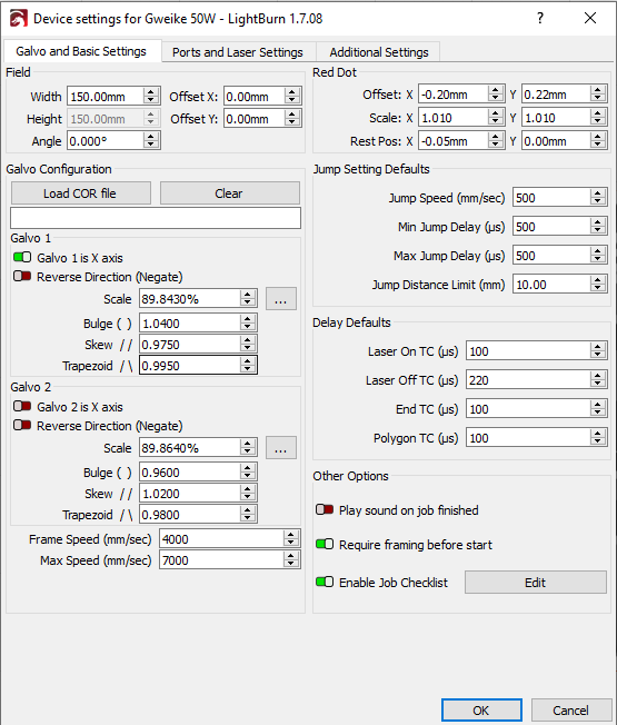

Please send us your .LBRN2 project file and post a screenshot of your Device Settings (specifically the Delay Defaults).

I still don’t have an explanation for the vertical ghosting effect in your picture. Your timing values look in range and you are only scanning horizontally.

My galvo head started making an audible whine and one of the axes started shaking. At first I could only hear it, then had quality probs, then it was oscillating back and forth at max speed in like a 1/2" line even while idle. The red dot was a line and any attempt to fire the laser would have that movement added to it. I contacted the mfg and they sent me a new galvo head, it was only a week old or so. I don’t know the exact nature of the problem but it’s in the galvo head which contains a driver board and the galvos.
I suspect you have the same problem, because it looks specific to the axis.

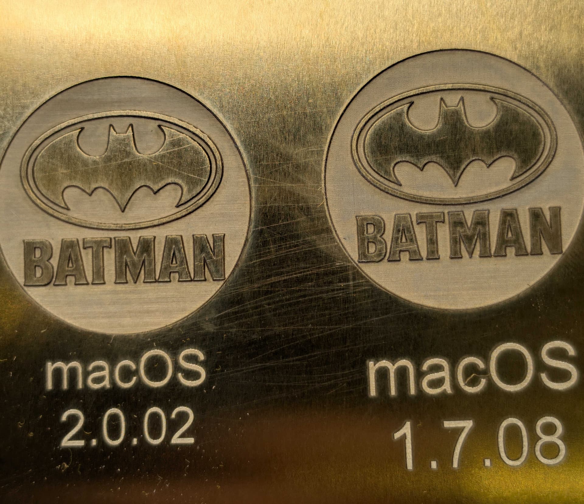

The version he was using (1.7.xx) didn’t support rotation for 3D Slice because I hadn’t rewritten the resampler yet - slices at different rotations would misalign, sometimes by quite a few pixels, and it wasn’t stable when you changed scale, so doing cleaning passes with a different interval or angle could give weird results.
The new one in 2.0 is pixel accurate while varying scale or angle, uses significantly less memory, and is faster to boot.

I ran your file on 2.0.02 and 1.7.08 and was unable to reproduce the shadows in your picture.
Also tried with a 30-degree Angle Increment on the Cleanup Passes.
I learned that version 1.7 and earlier always did a Cross-Hatch with 3D Sliced because LightBurn didn’t yet support Angle Increment on every pass.
So, the design did in fact scan vertically too, but still didn’t show any ghosting in my case.
Curious to hear how the latest version performs for you.
