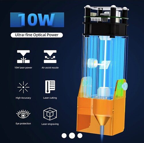

I looked at that model last night…Think its a 10w optical.
@dakota1
First things first, there are a lot of companies who use this deceiving strategy of naming a laser by the electrical power rather than its optical power. FoxAlien 40w Diode Laser is one such product, the 40W is the electrical power consumption of the laser module while its optical / laser power output is 10W.
I am attaching images taken from FoxAlien website (CNC Router 4040-XE with 40W Laser and R57 Rotary Roller Kit – FoxAlien) .
Regardless, a 10W laser cutter can definitely cut 3mm basswood. Lets start with a simple geometric shapes to figure out our settings rightly suggested by @JimNM . The same setting will hold mostly true for bigger ones like you have shared as well.
