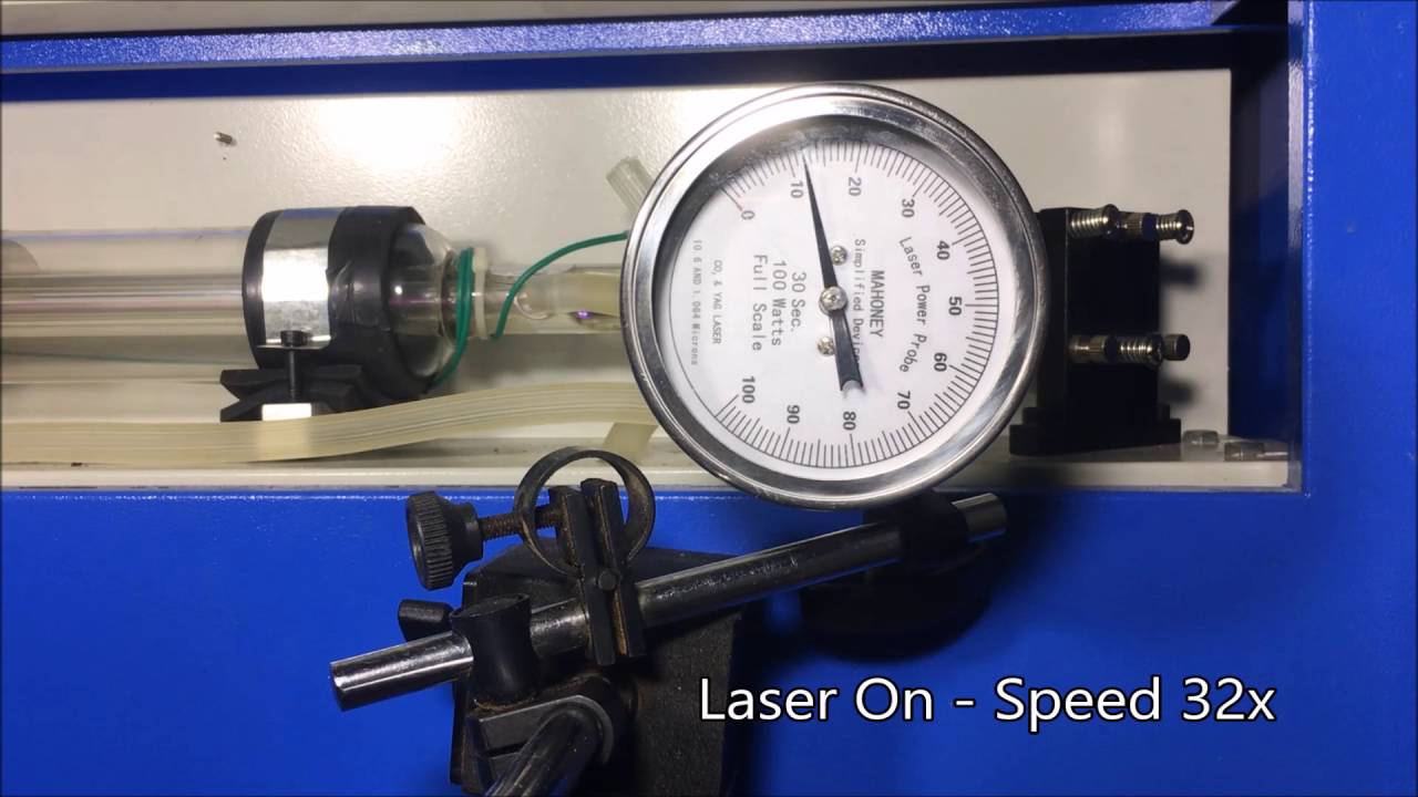

It’s nice to have some idea about how much power you actually have. Mine is a ‘China Blue’ 50 watt. It measures 44 watts.
I have a Mahoney wattmeter that I use monthly to look for anomalies in the beam power.
Russ Sadler has a lower cost unit…
Here’s a couple of links to videos by Russ Sadler and show his ‘dohickey’ for power measurement. The first is the nitty gritty of it, the second is how an earlier version that details it’s operation and power meters in general … The second is a more technical description…
