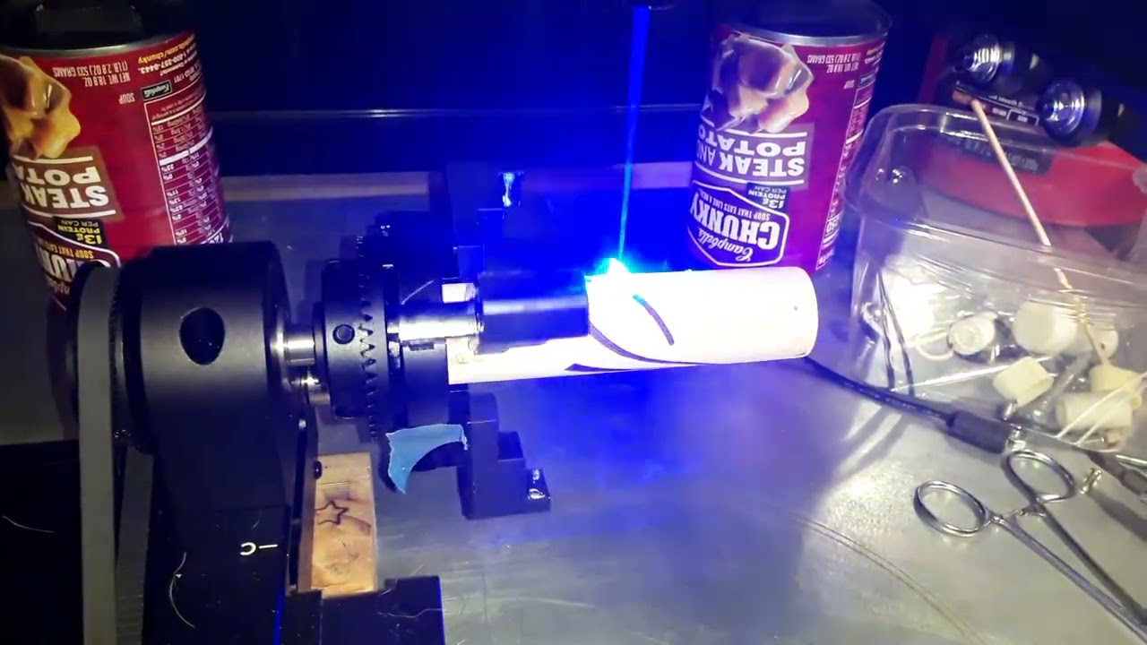

Managed to hook up the Xtool RA2 rotary fixture (3x the cost of the engraver!) and run Lightburn’s rotary setup tool. Only odd thing about this Cenoz machine is that it uses TWO motors (hooked in parallel) to drive the Y-axis… rather than a single motor and driveshaft. You’ll need to unplug BOTH motors and plug the rotary fixture into one of the connectors.
This machine should make a dandy machine for doing cermic tiles/glass and rotary jobs on bottles and glasses. It’s sturdy and portable… easy to block up, relocate, and/or put away for storage.
