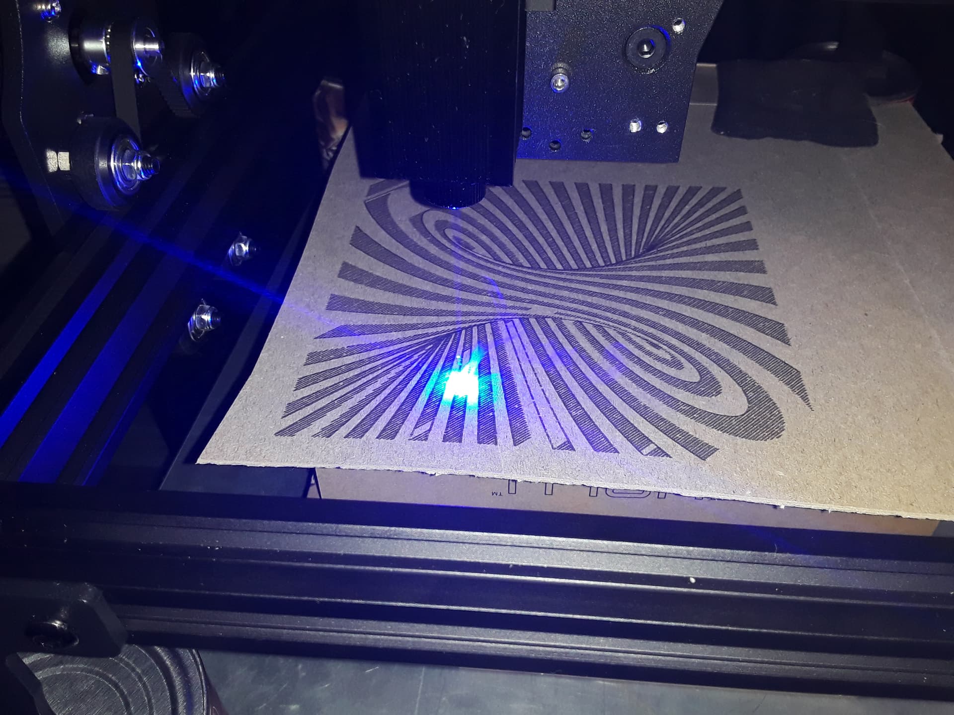

Does homing work properly? I believe @LsrSal wasn’t able to get his to work. If so, what is position after homing?
If homing isn’t working, are you placing laser head at front-left before starting machine?
I was looking at this homing. The switches are located in the front/right.
When I first fired it up, it come home (front/right) then moved to the back/left… never ran anything to see what it did, but thought it was a curious boot sequence.
See post 37…
The machine’s limit switches are placed to put home in the right-front corner. The unaltered machine will home to the right-front and then run to the left-back corner upon power-up. After flashing Grbl… trying to home goes in the wrong direction, both X and Y IIRC. Changing the $23 Grbl setting ($23=1) now goes to the switches and leaves the laser in the front-right corner.
That said, I have never depended on limit switches and homing… in fact, most of my machines don’t even have limit switches. I usually like the freedom of placing the workpiece wherever convenient and frame to the workpiece. I normally use “User Origin” or “Current Position” rather than absolute coordinates and don’t depend on the laser being in a particular spot when I power on the machine.
So… did you configure Device settings with the home (origin) at the front/right?
No, I didn’t… TBH I didn’t think about it. But I was using my default “GRBL” Device which designates the front/left being my 0,0 and I do not set “Auto-home on startup”. As I stated in my last post, I don’t depend on limit switches or homing anyway.
So I just homed the machine since it has the switches… front-right. Reading the position yielded -2, 2 for X and Y… 2mm off the switches is correct, I think. Moving 100mm out into the workarea yields -102, 102… so it appears to be in Quadrant 2. I’d prefer to work in Quadrant 1 and need to figure out how to move my 0,0 to front-left. Maybe that’s why my “User Origin” usage crashes left even though it seems to frame properly? “Current Position” worked fine… :thinking:

Based on what you’re saying try this:
$10=0
G10 L2 P1 X-200 Y0
Ok… here’s what I have decided. My machine is now behaving like all my other GRBL machines.
I’ve disabled the Homing cycle ($21=0) in Grbl settings. I’m removing “Home/Homing” from my vocabulary and ignoring limit switches and any position coordinates in LB.
“Origin” is my friend. I put a workpiece down and jog/position and lightly fire the laser where I want it relative to the workpiece and matching the “Job Origin” setting. I select my graphic and Preview to insure all looks right. I select “User Selection Origin” and “User Origin” in the Laser tab. Frame to insure all looks well and “Set Origin” and “Set Finish Position” in the Move tab. Frame once more for a warm fuzzy and “Start”. The job runs to completion and returns to the starting point.
