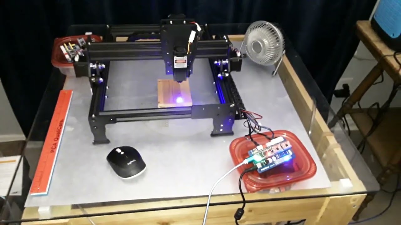

Absolutely shocked… ordered on Aug 9th, received on the Aug 12. Not for everybody but I will say that this is one sturdy little machine. All metal and uses 2040 (vs 2020) extrusions. Uses cable chains so neatest wiring I have on any of my other machines. Four M5 screws for the gantry and a couple of M3’s for the end of the gantry cable chain. Working area about 220mm x 290mm and 3W laser (claimed).
Powered it up… it homed and parked itself in upper left corner with a red cross and small laser dot. So everything appears to function as designed. Which is okay if you can read Chinese and don’t mind using crappy proprietary Windows software… which I didn’t install or try to use. I already knew about all that from the LB discussion thread… so was ready to make it better.
Opened the metal box containing the controller board… JL1 Mainboard. Found the X and Y connectors and fished them out of the box… along with the connector with 3-wire laser connections…
Took one of my trusty old Eleksmaker Mana SE 2-axis controllers that I’ve used to test many machines and was able to easily find corresponding connectors and pins to control machine and laser. I left out the limit switches and red cross laser… don’t need or use them
Crudely focused on block of wood and engraved my old friend Garfield under Lightburn control…
I’m genuinely impressed with the physical qualities of this little machine and, like I heard one fellow say, in effect… if they’d simply put a Grbl-based, Lightburn-capable, controller on this thing, they could probably sell a million of them.
Of course, I needed another machine like I need another hole in my head but there it is. But if you’re a little bit handy and looking for a low-powered machine to do small stuff like ceramic tiles and rotary engraving… this machine should handle it nicely. I’ll also add a Z-lift mechanism to it to enable easier focusing but otherwise it’s a nice basic machine that I’ve enjoyed messing with…
